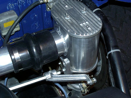

(IMG:http://www.914world.com/bbs2/uploads/post-124-1221062738.jpg)
VaccaRabite
post Aug 17 2010, 03:38 PM
Post #34
En Garde!
Posts: 13,952
Joined: 15-December 03
From: Dallastown, PA
Member No.: 1,435
QUOTE(narino @ Aug 17 2010, 03:33 PM) *
Zach - where did you find this setup?
I spent about an hour working every combo of search terms I could think of to try and find the post where I had seen the guy that laid up his own. Never found the thread I was looking for, but I did find the thread with that picture. Rich Towle posted it, so put his name into the search form and you will find it too.
