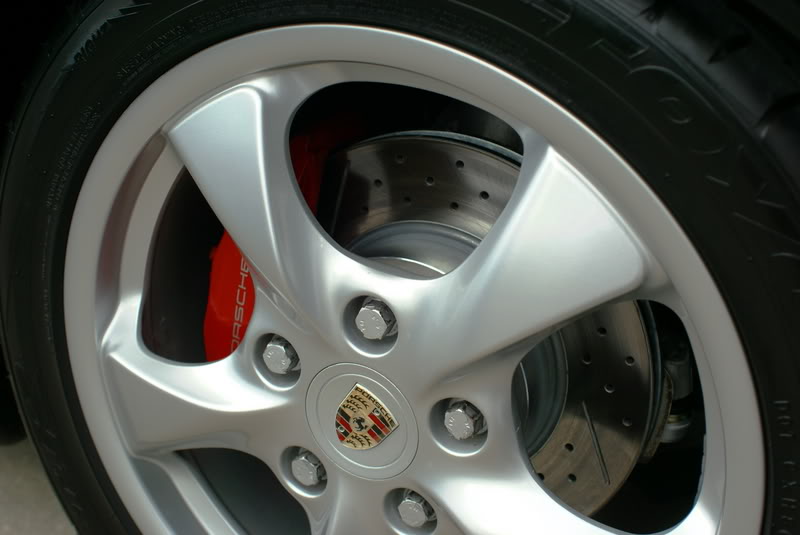

(IMG:http://www.914world.com/bbs2/uploads_offsite/img.photobucket.com-10656-1282339930.1.jpg)
Here is my Boxster wheel refinished in the Wurth SILVER. I do think it is a slightly darker, more modern look than the 914 steel wheel should have.
