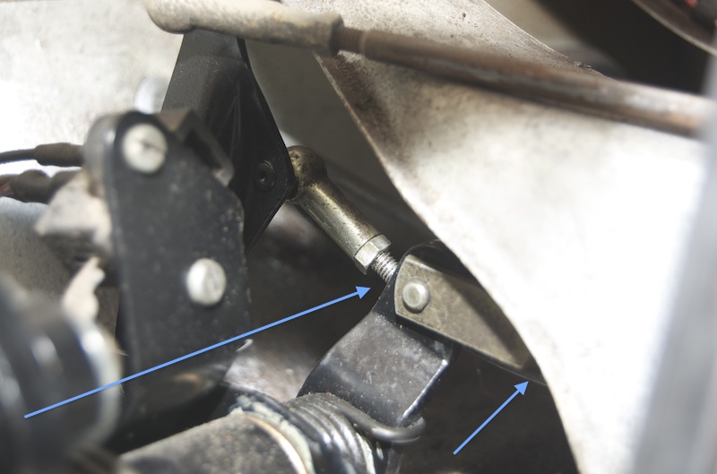

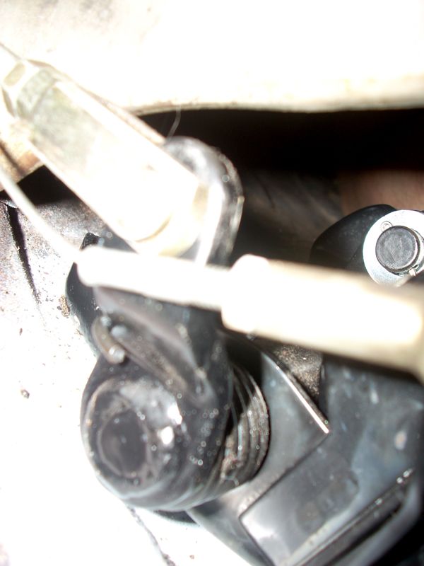

Here's another remote possibility that bit me in the ass awhile back. If you install the clutch clevis pin from right to left, there is a small lip that can catch the throttle cable under certain conditions. The cable pops back off on its own. Now I only install the pin from left to right.

I looked down the tunnel with a mirror and the cables are not caught on each other. The accel cable is parralel to the clutch cable below.
I have lubed all ball/socket connections.
I see how the accel cable could get caught on the clutch cable clevis but my accel cable is stretched taught so it doesnt hang down at all.
