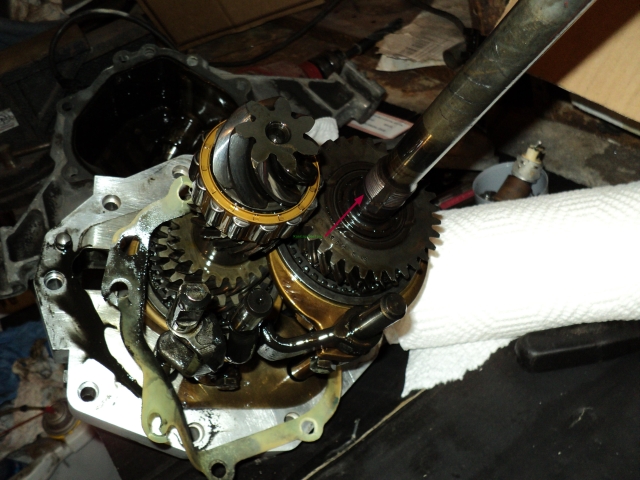

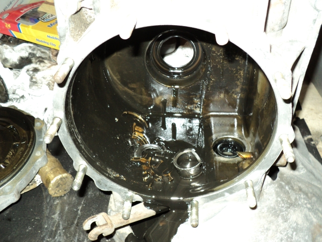

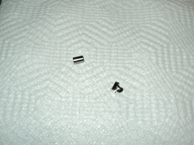

I drained the lube from the transaxle for the Alien. This came out the drain plug. (IMG:style_emoticons/default/dry.gif)
rick 918-S   What bearing is this?   Aug 22 2010, 09:44 AM
RobW   :( What a bummer! Time to build a new box?   Aug 22 2010, 09:51 AM
Mark Henry   My guess is a diff bearing.   Aug 22 2010, 10:00 AM
ME733   ,,,,,,,,,,Intermediate plate ...mainshaft brgs.......   Aug 22 2010, 10:52 AM
Cap'n Krusty   ,,,,,,,,,,Intermediate plate ...mainshaft brgs......   Aug 22 2010, 03:00 PM
Jeffs9146   This looks like the same one that went out on mine...   Aug 22 2010, 11:03 AM
charliew   dimensions of the bearing roller would make it eas...   Aug 22 2010, 06:41 PM

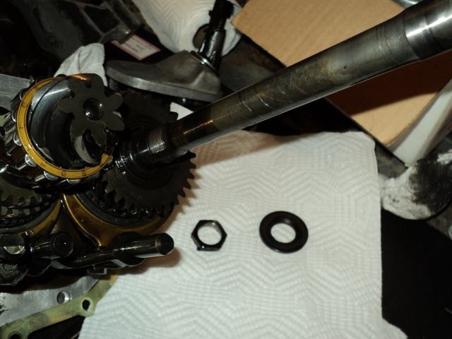

rick 918-S   Found it <_<   Aug 24 2010, 09:32 PM
rick 918-S   The nut was was off, the locking washer was broken...   Aug 24 2010, 09:39 PM
Cupomeat   Any other damage? Did the bits get into the teeth ...   Aug 24 2010, 09:40 PM
rick 918-S   Any other damage? Did the bits get into the teeth...   Aug 24 2010, 09:46 PM
rick 918-S   I had to drive the car about 10 miles home after I...   Aug 24 2010, 09:44 PM
McMark   :trophy: I might have one of those. I'll le...   Aug 24 2010, 10:03 PM
rick 918-S   :trophy: I might have one of those. I'll l...   Aug 24 2010, 10:20 PM
Jeffs9146   Yep thats the same thing that happened to mine...   Aug 24 2010, 10:32 PM
rick 918-S   Yep thats the same thing that happened to mine...   Aug 25 2010, 07:17 AM
Jeffs9146   I ended up using donor parts to put it together. T...   Aug 25 2010, 09:34 AM
McMark   Dang! I have the big bearing like that on the...   Aug 25 2010, 09:57 AM
rick 918-S   Dang! I have the big bearing like that on th...   Aug 25 2010, 10:27 AM
rick 918-S   Located all the parts and they should be here for ...   Aug 25 2010, 11:00 AM
