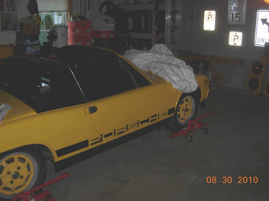

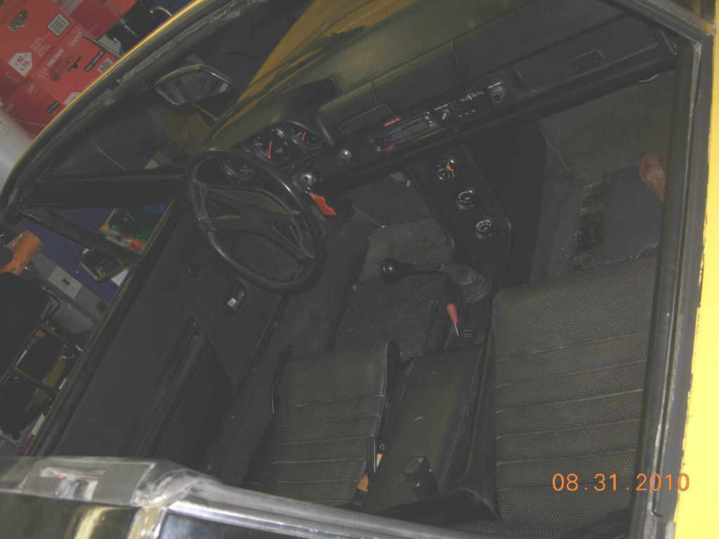

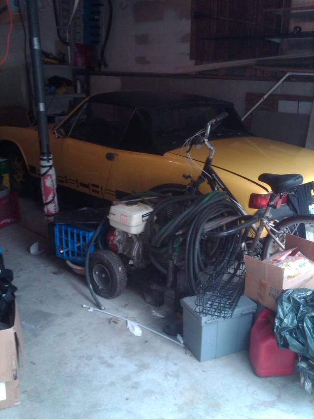

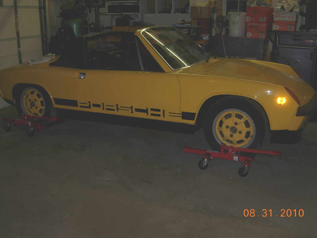

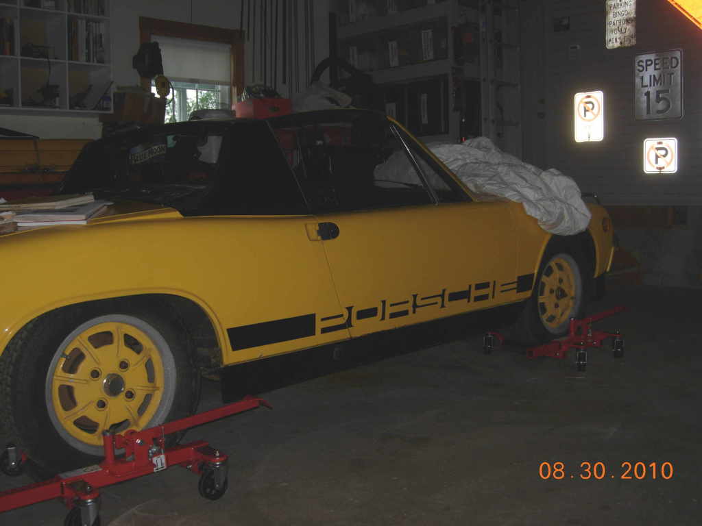

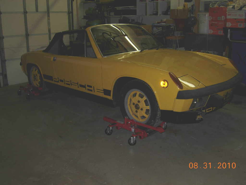

SWL - thanks - i am thinking along the same lines. I'm not in a hurry to crank it over and see what's what. I want to do this right. I'm thinking this will be a winter project so I have plenty of time.
My thought is to drop the engine so I can get a good look at the engine bay area and make any repairs or treat any rust spots with por-15.
While the engine is out, I'm looking for suggestions of what to do or not to do. IE, remove the plugs and squirt oil in the pistons and try to turn it by hand, etc..... I'm fairly well versed in mechanical repairs although this is the first air cooled engine that I will be working on.
Obviously draining the fuel tank and cleaning it is an important step. I will likely replace the fuel lines while I have it apart.
Keep the suggestions coming. I'll try to post a couple of pics but the pics I have aren't very good.... more to come when I have time next weekend to get it out into the sunlight.

Now you're talking Bud! Any guy who's first reaction is to put her up on jack stands and drop the engine is going to fit in well around here!
