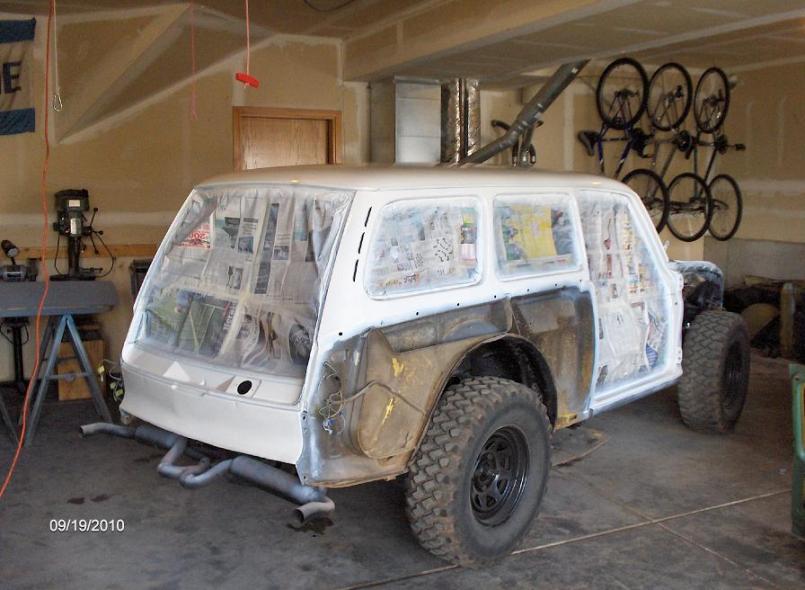

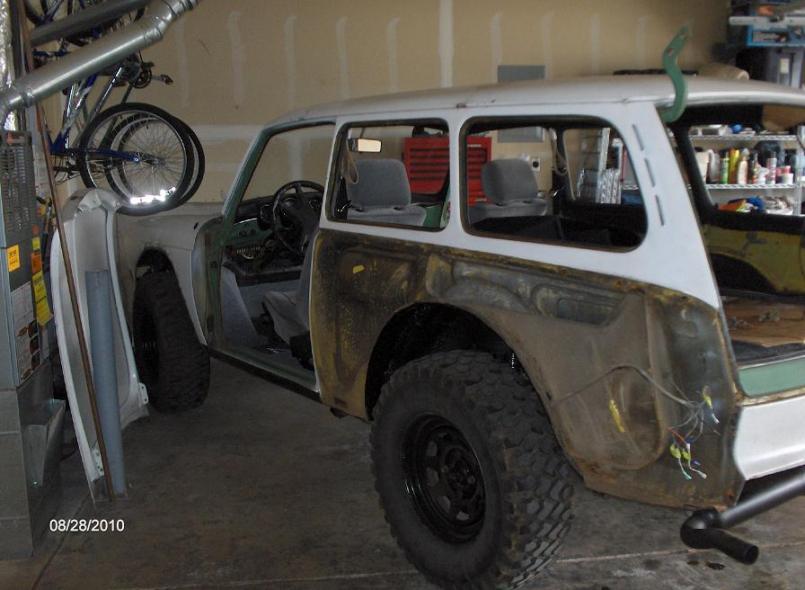

Another one from the weekends work:

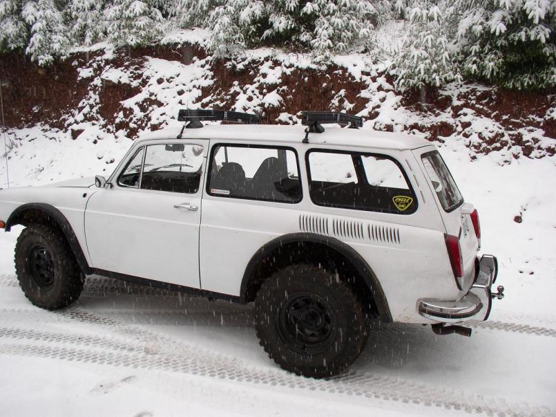

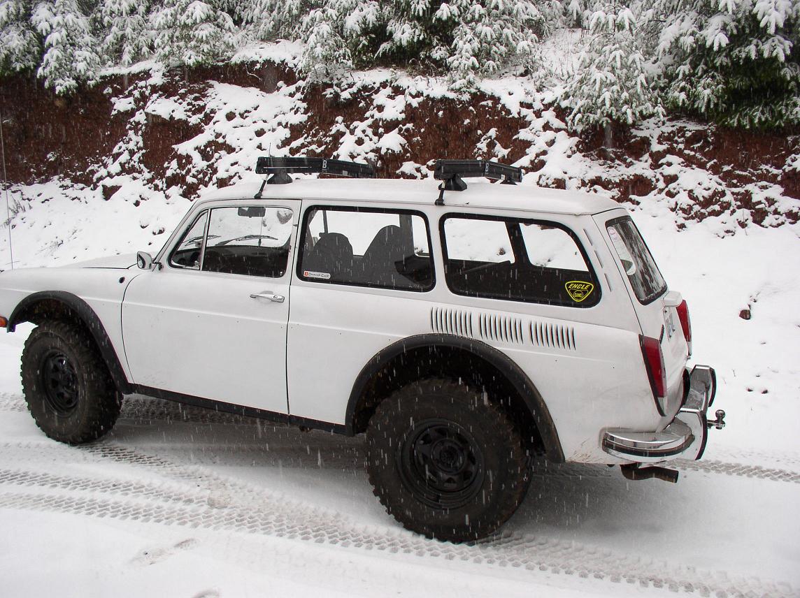

One of my favorite shots right now:

QUOTE(Root_Werks @ Aug 31 2010, 07:34 PM) *
(IMG:http://www.914world.com/bbs2/uploads/post-2105-1283312081_thumb.jpg)
I think if the Werhmacht had that car during Operation Barbarrosa, they would have won the Eastern front!

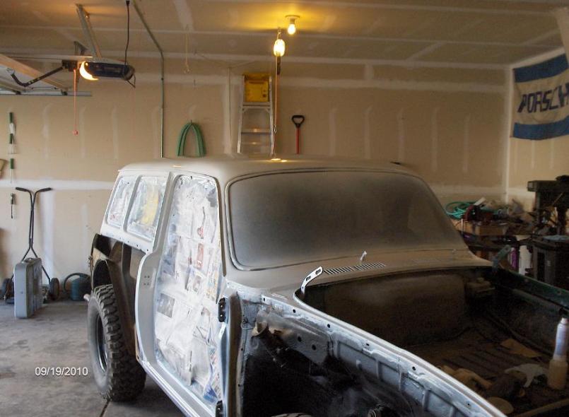

Painted the main body today, turned out pretty good!
I used real autmotive paint, slow reducer and hardener to give time for the paint to flatten out.

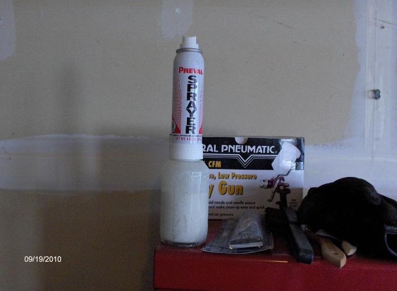

The ticking off the nieghbors was solved by using this system. Never used it before. Mix paint like you normally would (actually, slightly more reducer, thin it out more). Not the best spray pattern, but it gets the paint down.
rick 918-S

QUOTE(Root_Werks @ Sep 19 2010, 05:14 PM) *
How do you pressurize the system?
Got a link to it?

Wow you sprayed the whole car with a preval can? Wow again!!

QUOTE(7TPorsh @ Sep 20 2010, 11:09 AM) *
Yup!
Well, this part took 3.5 cans and 4 coats. I got a couple of runs by the back vents (Rear lid) area. You have to thin it out so much the first couple coats do nothing for coloring. The 3rd coat was like 90% color cover and the 4th coat I laid on as thick as possible (the runs) to just be done. I should have done a lighter 4th and then just 5th coat. Probably would have gone through another 1.5 cans.
The cans are $5 each, so far, $20 in cans used.
The roof really flattened out, the sides have a little orange peel to them. When I paint the doors and fenders, they will be laying flat.
I want to do the doors this weekend. I'll post pics then.
10,000 times better than rattle can! (IMG:style_emoticons/default/smile.gif)

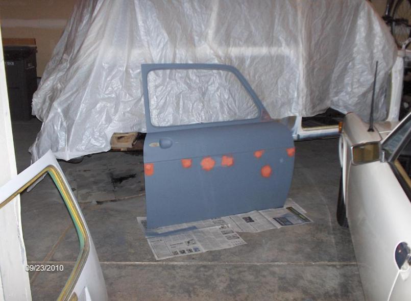

Painted the......drivers door last night. Really liking these little Prevel cans.
No, not the same quality as a true HPLV gun, but it's getting the paint on. Slow reducer and hardener continue to prove a good thing to help the paint flatten out over time.
Downside is still 4-5 coats before proper color coverage. This is my first white paint job as well. I think white is harder to cover than most other colors?

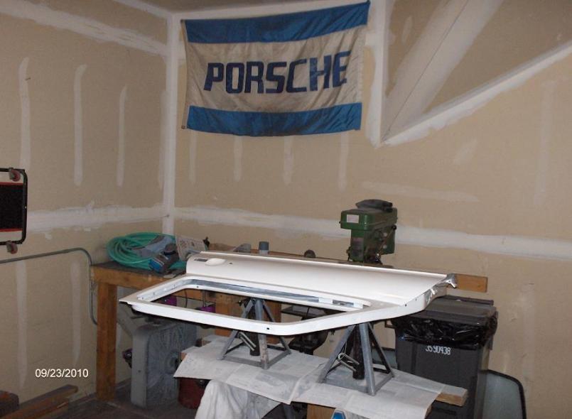

I would have painted the passenger door, but I wasn't happy enough with it yet. Even with my "Just paint the dang thing" attitude. I do still have SOME standards. (IMG:style_emoticons/default/biggrin.gif)

PLEASE tell me that isn't nitro stain.........
A word of info folks...DO NOT USE SINGLE PRODUCT BONDO They do not harden and will almost definitely come back through the paint as a discolored spot. Only use bondo that uses a hardener, and always prime over that before applying color.
