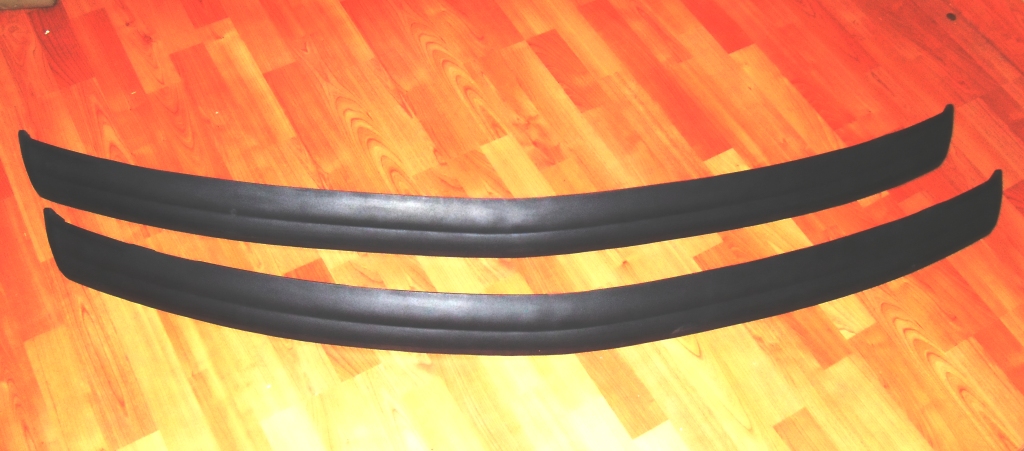

Here they are. Look the same supported

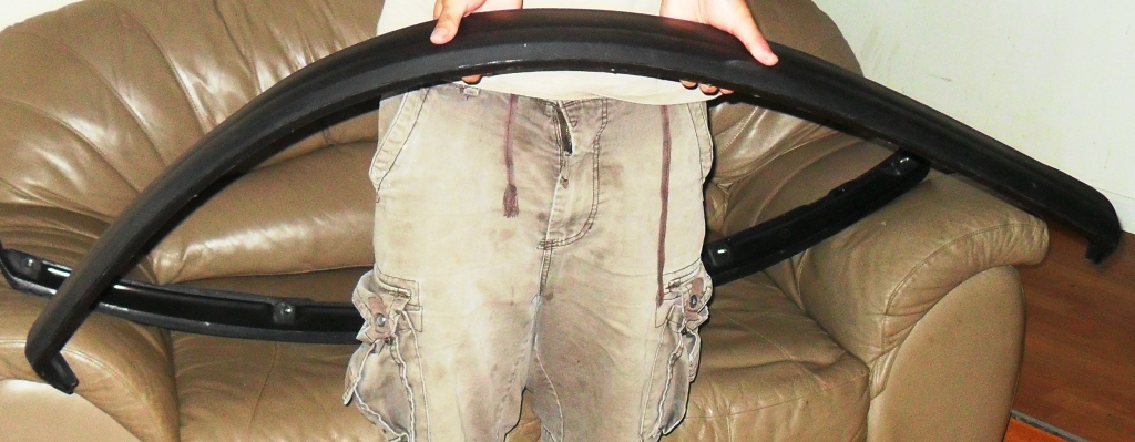

New one

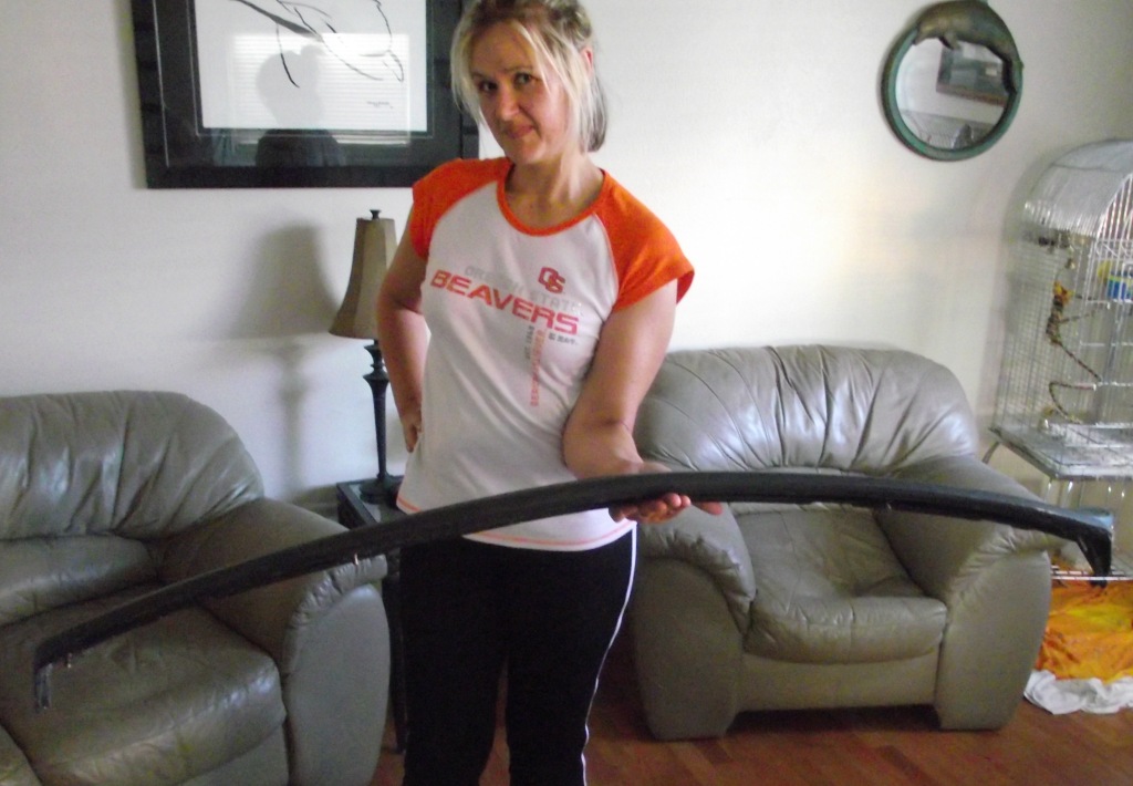

Old one

QUOTE(mepstein @ Sep 29 2010, 06:21 PM) *
Shouldn't she be wearing a Bikini to model that?
I tried, but no dice, this was the best it was going to get.
