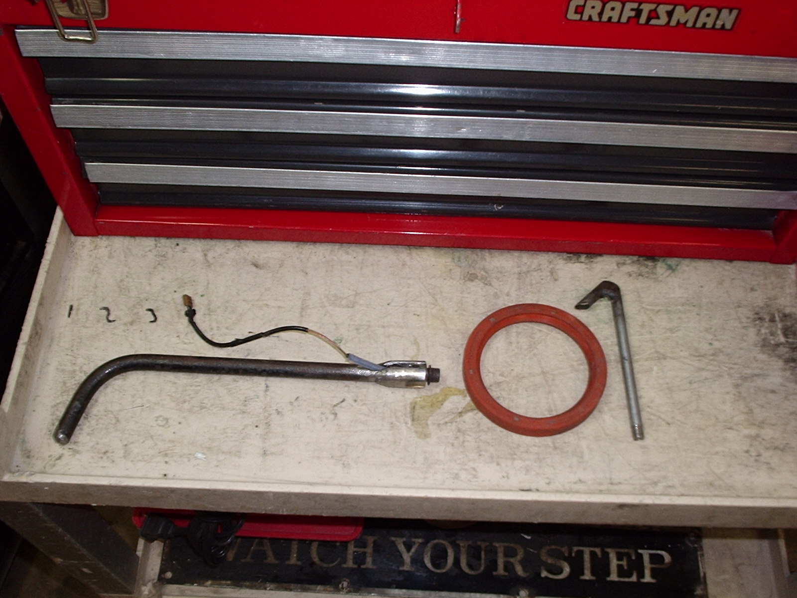

majkos
post Sep 2 2010, 03:16 PM
Posts: 1,370
Joined: 29-February 04
From: Mile High 914
Member No.: 1,729
QUOTE(McMark @ Sep 2 2010, 11:12 AM) *
Are we talking fuel inject CHT? Or aftermarket dash gauge CHT?
Sounds like they're talking about stock temp sensor
aftermarkets are way to easy to install
Here's what I made to deal with the stock sensor
