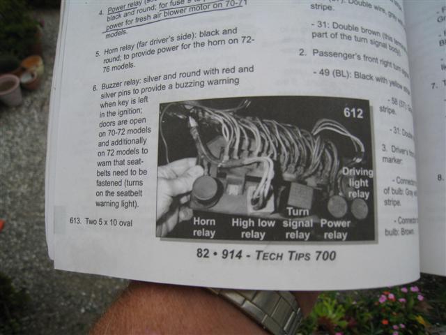

Can some one please take a picture of the backside of the fuse board that is under the dash? I need to know which relay is missing. In putting things back together i have three relays and my old mind can't remember which one is right.

To further the SHAMELESS self promotion of my book the "Tech Tips 700" which Road and Track in their review said that "no 914 owner should be without" There is a labeled picture on page 82

Here is what George is referring to. The Tech Tips 700 books is one of the best resources to the 914. I've had mine over 10 years and still refer to it. Many of the basic questions asked on this board can be answered from this book. Pictures are used extensively to illustrate.

the hanyns manual has a photo on or about page 128 figure 9.22
the photo shows the back of the fuse plate. from the left side, there is the large can (buzzer) not all years had a buzzer. next is small realy can for the "Auxilary headlights" then the next small realy can if for the "fresh air fan" the final realy on the right side is the big rectangular can for the "light Dimmer" (high beams)
hope this helps, no shamefull self promotion here.
