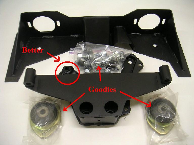

The Three Main Players seem to be Rich Johnson, MadDogs, & Patrick Motorsports

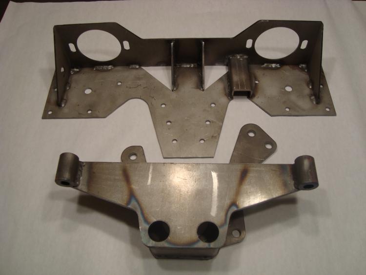

I'm loyal to Rich, but would like to hear some opinions RJ - $450-$500 - Looks Nice and the Motor Mount looks more stout than the others ![]() MadDogs - $270 - Looks like a knock-off of Rich's, but is $200 cheaper. Looks like you can mount it lower ![]() Patrick Motorsports $486 - different design. Their former Chrome-Moly bars had some problems with welds & cracking - are these any different ![]() Opinions Please |

Rich's mount is much better made then Maddogs. Maddogs metal is a thinner gauge, the welds are not as nice ( flux core mig ) The price is reflective of the quality.
DO NOT get me wrong, I am NOT saying the Maddog mount is not good, I am just pointing out why the price difference is. I wouldn't be worried about running the Maddog mount. I have not had any experience with the Patrick mount |

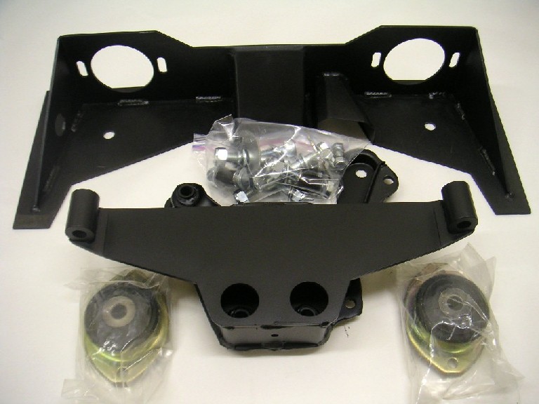

Just from the pics the RJ mount looks beefier. Does the price include the goodies pictured? Does Maddog include them also?

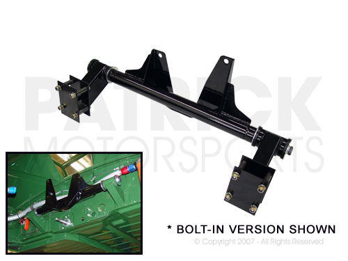

How do you drop the motor with the Patrick Mount? Are there bolts at each end that thread into the pipe?

The Patrick mount is much better for engine service.
I've used one for 6-7 years now and it is stout its a wider mounting surface also. plus it pivots (yes a bolt in each end At the track one day, we dropped the motor 3-4 times in a single day when we lost a rocker shaft one day... you can pull the shift linkage, CV's, and build it with enough oil line to allow it to tip. I can prep things in 10 minutes and then loosen my tranny mounts and pivot the motor down enough to pull valve covers below the chassis.... Good for valve adjustments too. full motor drop is just as easy. I made a craddle that fits the block so that I can pull the exhaust, CV's, wires, oil line, and then tip the back onto my craddle. I then move the jack to the front, pull the two bolts and lower the front onto the craddle. Then roll it right out. |

I had the Patrick mount in my car and really liked it. Never needed to swing the engine down but it does give you more access to the front of the engine while in the car.
