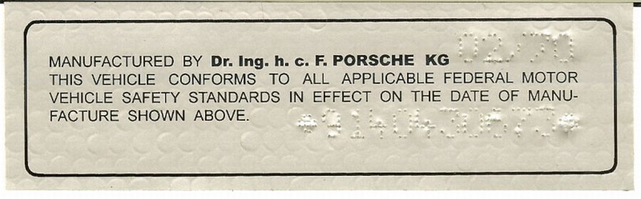

Does anyone reproduce the drivers side jamb VIN?

It's actually called a Compliance Sticker. AA sell the sticker only

Any idea on who could do the holes? Thanks

Any idea on who could do the holes? Thanks There was a thread here last year where several people tried different techniques ... (IMG:style_emoticons/default/popcorn[1].gif) Andy |

I made one of these. AA told me that a bank may be able to punch the holes. I did not go that route.
With the help of a friend and his milling machine we made a template. We measured the factory punch marks from center to center and then we took those numbers to his mill and drilled a grid. I then took a glue needle and sharpened the tip on some sand paper and I used the hollow needle to cut/punch the holes into the sticker. It was near perfect. BUT, the sticker sucked; after a few months the top started to delaminate from the bottom of the sticker where the holes were cut. the needle was similar to this: (IMG:http://www.914world.com/bbs2/uploads_offsite/equipment.loctite.com-6815-1283980686.1.jpg) |

I've done one, and won't do anymore, as it's a major pain the ass and easy to make a mistake.

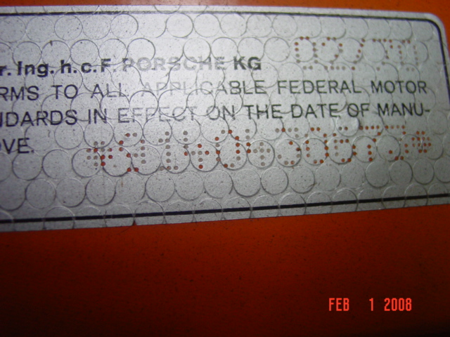

There is a guy on the EarlyS Board that sells Stickers and a Bioposy Tool to do the the semi-circles Original ( glad I had a picture) ![]() Here is my Sticker - Not Perfect, but better than nothing - Damn flunkie at the body shop (IMG:style_emoticons/default/chair.gif) |

the mill was used to make a template (grid) and the sharpened hollow needle was used to punch the holes through the grid template and into the sticker.
a laser cutting tool may work, but will it melt the sticker? |

we have several guys in years past use a check canceling machine to perfectly punch our reproduction stickers. Cannot tell from the original!
Always when getting into the door jamb with paint we HAVE to remove the sticker for a perfect job |
