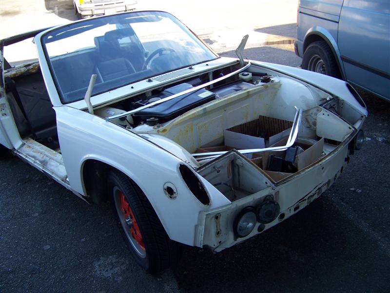

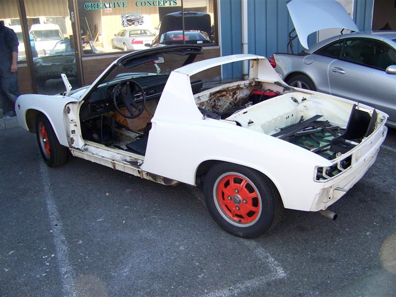

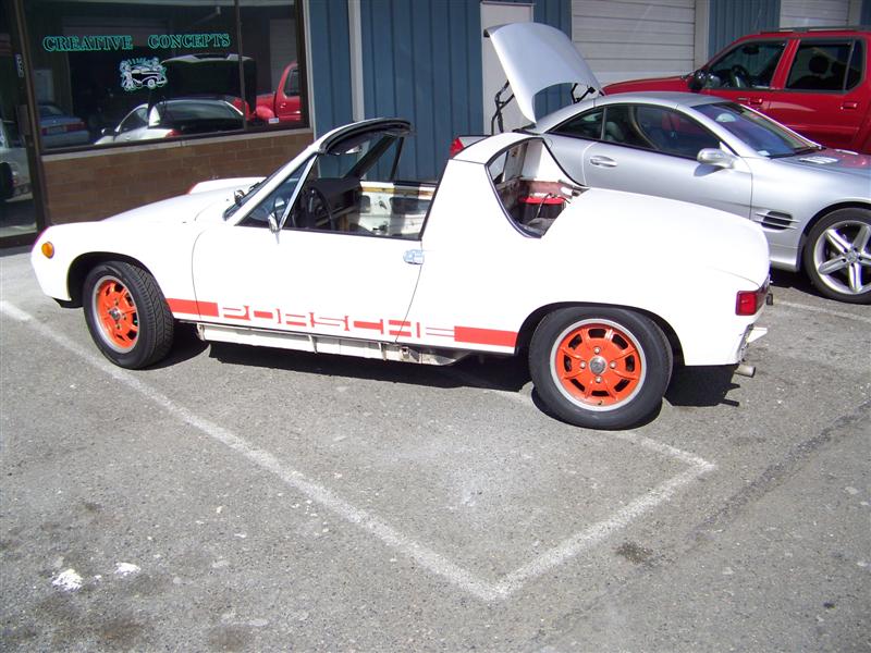

What the car looked like this morning
What it looked like by the end of the day

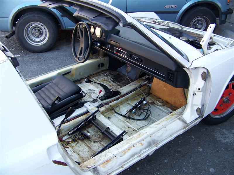

It all started last Tuesday when I got the call that the paint shop had an opening. Every night this week I've stripped off parts and this morning I drove the bare bones car to the shop. One part after another came off. The only thing I have left to do is pull the fuel tank so I can get the wipper assembly out and pull the air intake "mesh". I'm having a tough time with the interior trim for the targa bar. All but one of the screws is stripped and I guess I need to drill them out. We can paint around the peice, but it would be nice to have it out for resetting the glass.

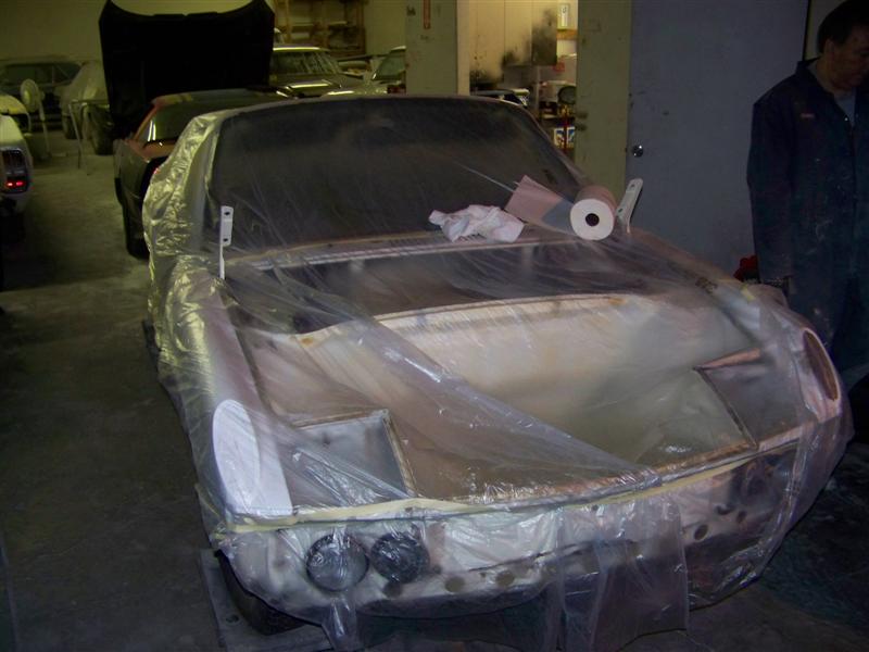

The body work is underway and I need to give credit to my friend Tim who is doing the worrk.
and here's the first stage of the paint work

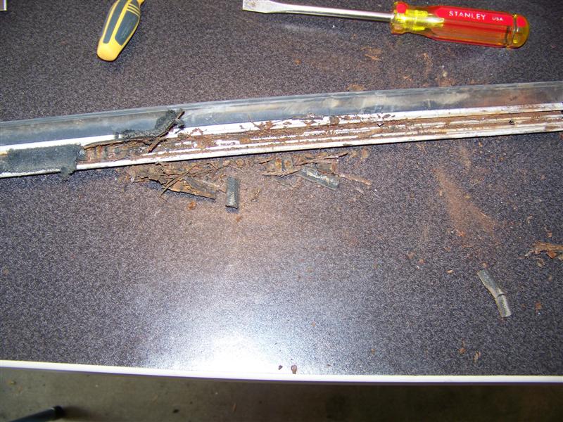

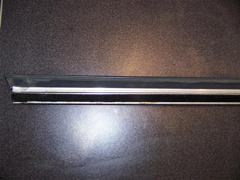

now I've been cleaning parts and doing some repairs. Here's the window fuzzy that wipe the glass as it slides up and down.
Before
After

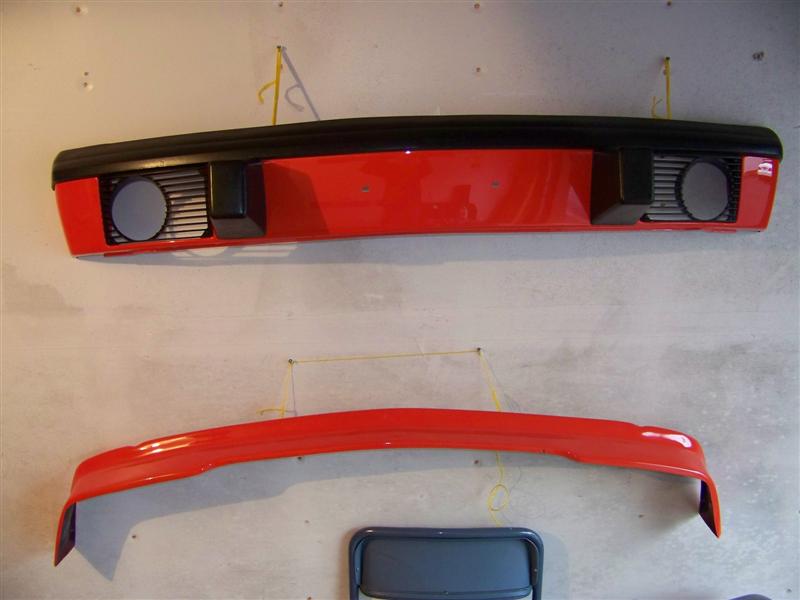

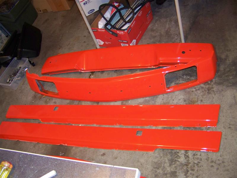

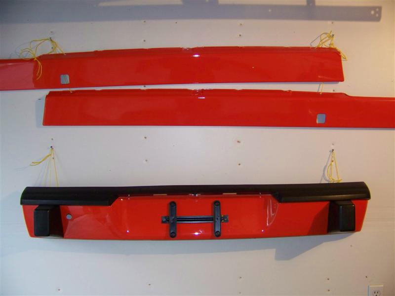

Waiting for the painted car to come back, I'm assembling everything I can so it will be ready to go on the car

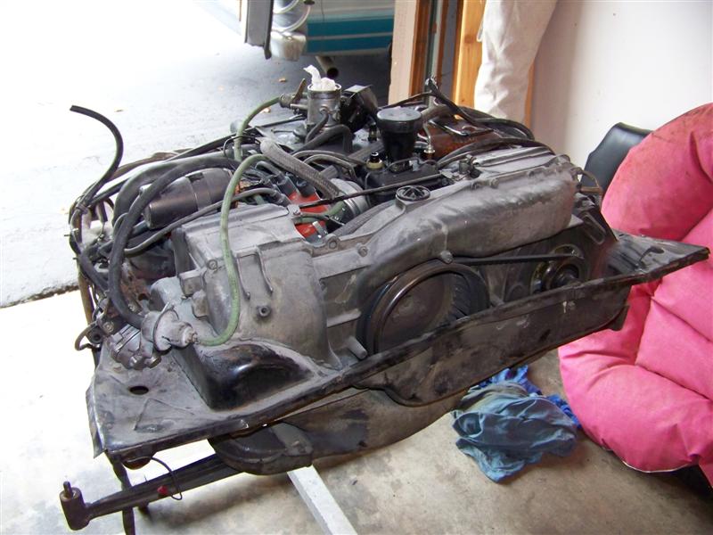

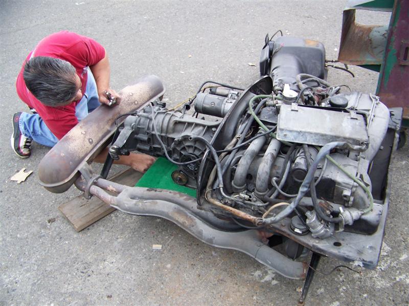

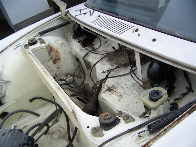

Another long weekend of work. Steve came over Friday night and we got the fuel tank emptied and the engine preped to be pulled.
Sunday morning the engine came out and here it is ready to laod in the van and take home Attached Image
Having it on a stand make the work alot easier.
This is the before photot just before I stripped off most of the top of the engine.
The engine cavity is in good shape, but with everything out it will be easier to work in there.

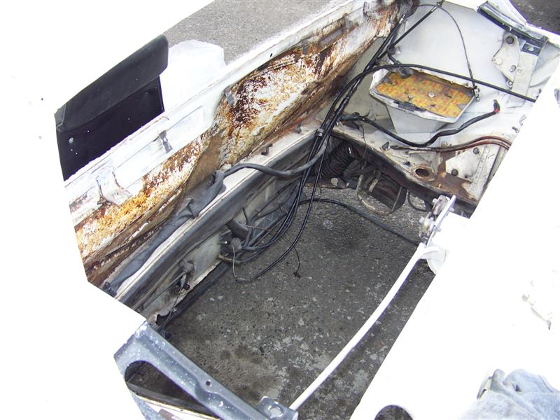

The metal is in better shape than it looks. The wall just has glue on it.
I needed to pull the tank to get the winshield wipers out. I broke the rubber support for the assembly, just like I did on my last car.
When I turned the bolt the rubber twisted and snapped. Its got to be one of the hardest bolts to remove on these cars.
Now the area were the winder come out of the cowl can be properly preped for paint.
