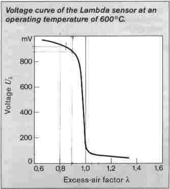

O2 sensors in a distal position provides indirect input for the estimation of the A/F ratio seen by the engine. This information is useful in defining a lean or rich mixture seen by the sensor for the most recent peroid of time. Broad band O2 sensors are capable of producing a wide range of output voltages which can be inturpeted for measuring the ratio. In fact, the output from broad band sensors can be feed into the Electronic Control Unit several times a second. This allows for real time adjustment of the A/F mixture. Thus output from the O2 sensor is recieved as input by the ECU which inturn alters injector time/volume to preprogramed mixture. This feedback/adjustment defines a closed loop system.
Narrow band O2 sensors also read A/F ratios. However, A/F mixtures ranging from 13.7:1 to 14.4:1 results in a change in voltage output from lowest to highest (0.1v to 1.0v).
If you use a analog voltmeter or equalivernt A/F gague, the response rates are such that your readings bounce requiring seat of the pants estimate as to where the mean is.
However, with the use of circuitry involving a IC unit, the voltage output can be lengthed to a series of LED's.
My question, can not a narrow band O2 sensor be utilized to monitor A/F ratios throughout the power band. Noting the results, provide information for enrichment/leaning in the adjustable ranges of D-jet. ie, idle, partial throttle and WOT.
