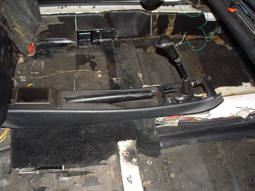

Here is the original console:
(IMG:http://www.914world.com/bbs2/uploads_offsite/i954.photobucket.com-11663-1284916612.1.jpg)

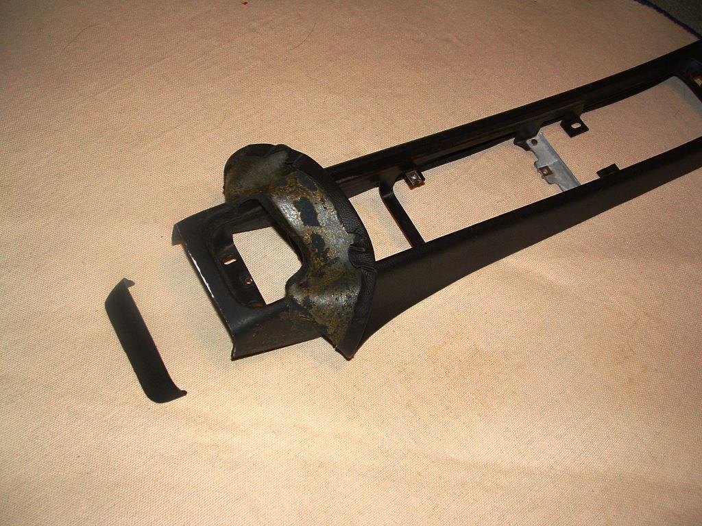

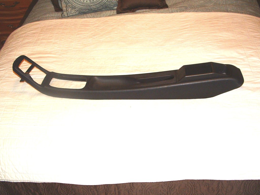

Here are the cuts:
(IMG:http://www.914world.com/bbs2/uploads_offsite/i954.photobucket.com-11663-1284916613.2.jpg)
(IMG:http://www.914world.com/bbs2/uploads_offsite/i954.photobucket.com-11663-1284916613.3.jpg)
