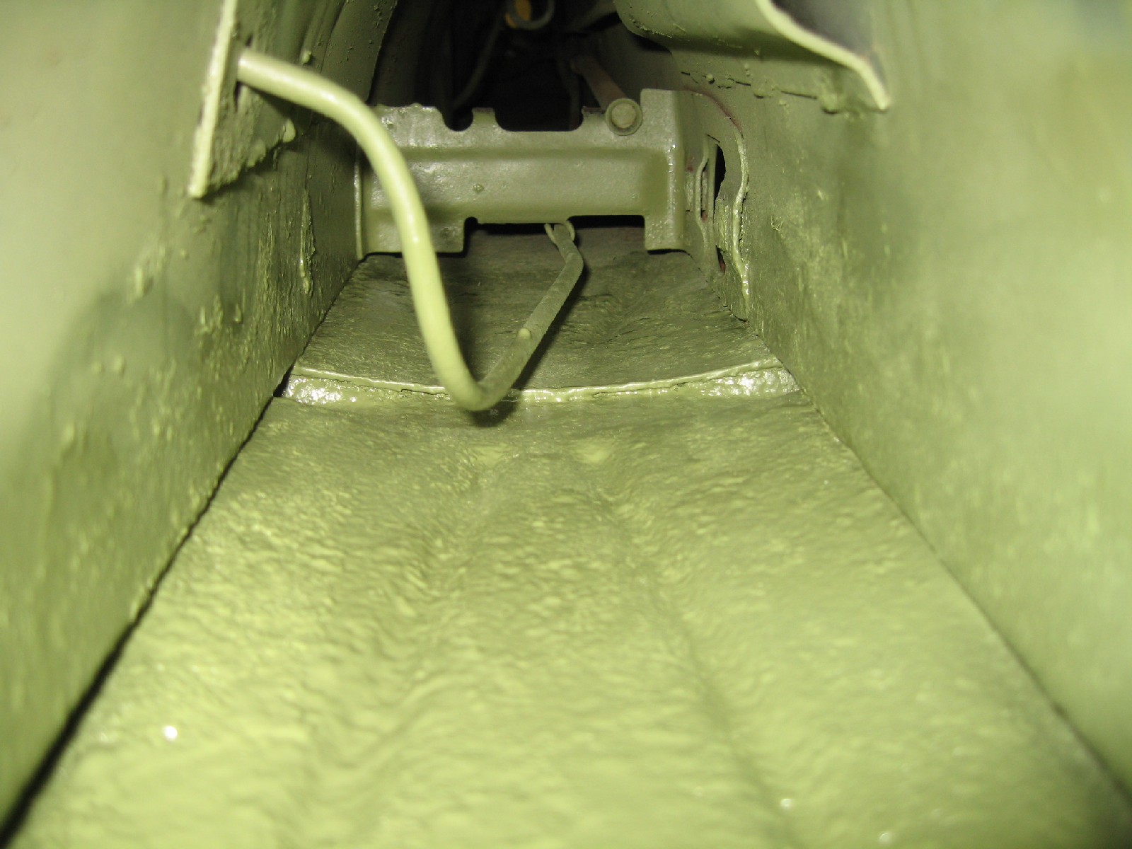

Ran the shop vac through the center tunnel. Not too bad - yet - with rust. I have a can of Permatex Rust Treatment. If I spray it into the tunnel, what's the hurt? Brake lines and cables should be ok....what about the OEM fuel line??

kwales If I was gonna use anything, it would be that tan ... Oct 5 2010, 06:59 PM
McMark Just sprayed a bunch of POR-15 Metal Ready into th... Oct 5 2010, 07:44 PM
bandjoey Where do you get cavity wax...and...is Metal Ready... Oct 5 2010, 09:43 PM
McMark Yup, Metal Ready is a rust converter. 3M makes a ... Oct 5 2010, 11:44 PM
McMark This thread on TheSamba is pretty cool. It uses t... Oct 6 2010, 12:06 AM![]() ![]() |
