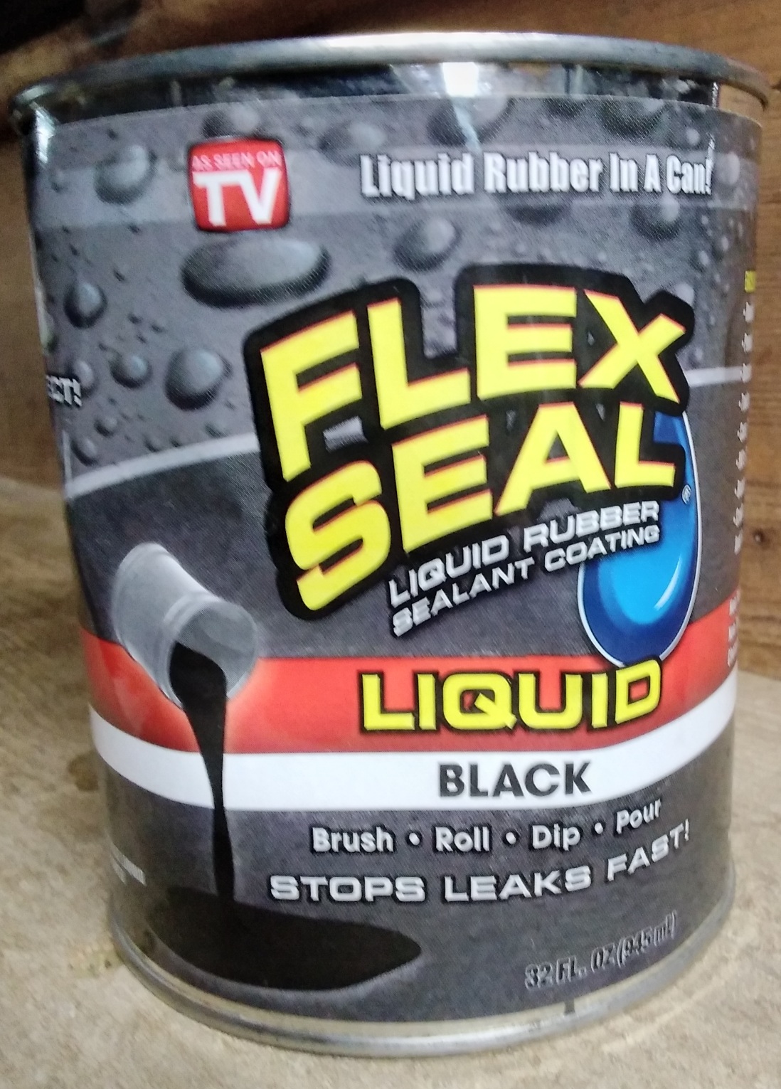

Olympic 914   I have used multiple coats of rubberized undercoat...   May 29 2021, 06:31 AM
930cabman   It will work for sure, you can make boats out of t...   Jun 8 2021, 09:51 AM
