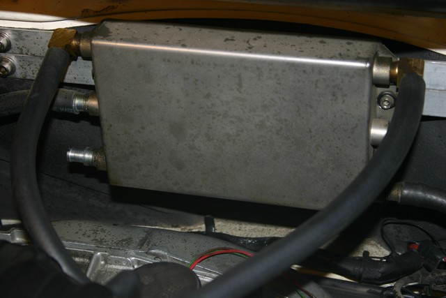

I've got a Raby oil ventilation/recirculation box mounted on the firewall:

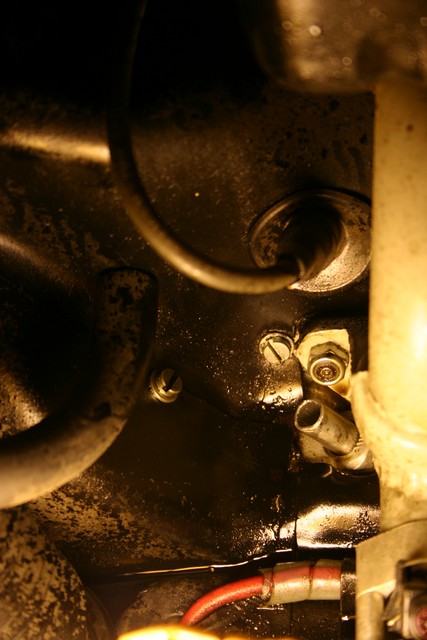

Here is the vent that the hose popped off of:

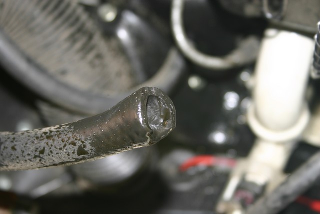

Here is the end of the hose that popped off:
Here is a picture of the hose:

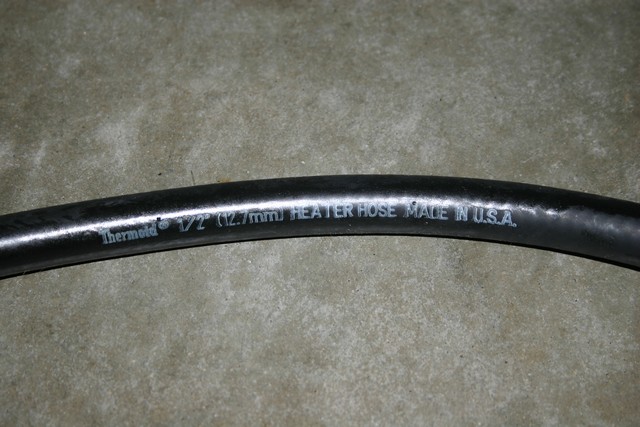

Closer inspection of the hoses plumbed into the ventilation system shows that each of them are quite soft and gooey. It seems to me that these hoses are not up to the task of handling oil vapors. The hoses aren't more than two years old.

They break down right at that connection from the heat both internal, and from the heat of the head...

There's water hose, good for water, fuel hose, good for fuel, can be used for water in a pinch, and oil/vapor hose, used for oil, and for oil vapor. You have water hose, not good for oil. Replace it.

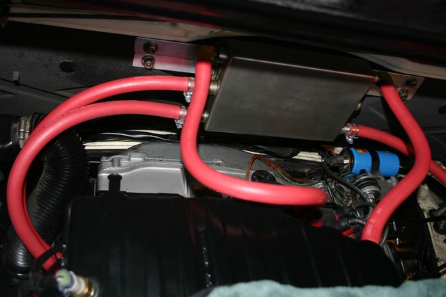

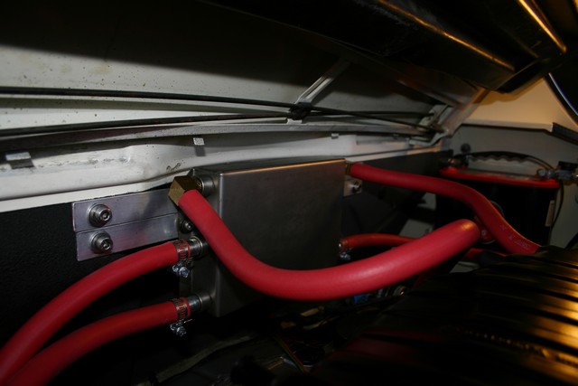

Found that Jake Raby's TypeIV Store carries the OEM style breather hose in 12 mm, and for a good price. However, I wanted to get the breather box replumbed, and get the car cleaned up for the PCA autocross event this weekend. So, I found this oil-rated, heat resistant 1/2" hose at my local NAPA store, so I picked up 9 feet, and a pocketful of hose clamps. Here is the result:
I'll give this a shakedown, and hopefully, it will be good to go for this Sunday's event.
