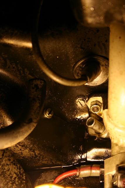

Third run complete, parked back on grid to get ready for fourth run. Look underneath, see a puddle of oil forming near the drivers side rear. Dang, what'd I break? Closer inspection shows that oil is dripping from above the tin, not below. Poking around inside, I see that one of the oil vent hoses has come loose, and the vent had puked out about 1/2 cup of oil onto the engine tin. I had some oil on my rear tire, so I bagged my last run, and headed home.
Here are some pics of what I've found:

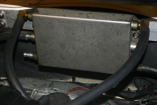

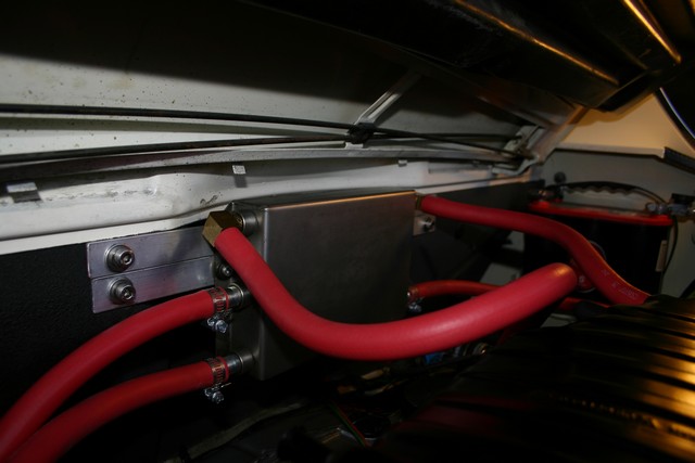

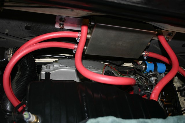

I've got a Raby oil ventilation/recirculation box mounted on the firewall:

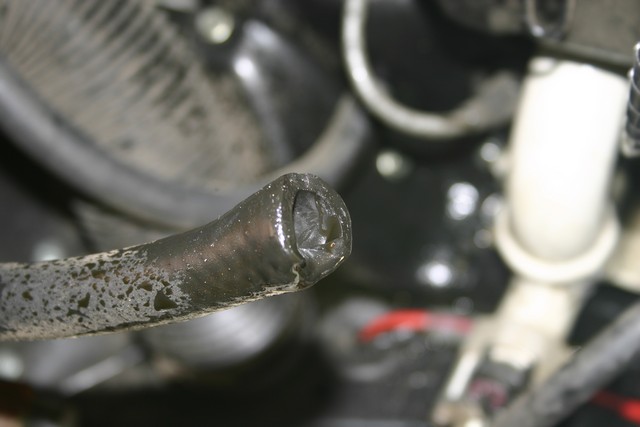

Here is the end of the hose that popped off:

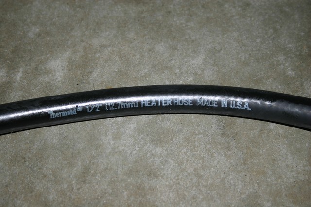

Here is a picture of the hose:
Closer inspection of the hoses plumbed into the ventilation system shows that each of them are quite soft and gooey. It seems to me that these hoses are not up to the task of handling oil vapors. The hoses aren't more than two years old.
