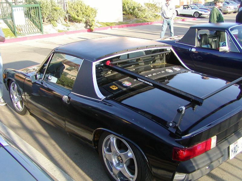

Elliot Cannons setup
http://www.914world.com/bbs2/index.php?sho...=52072&st=0
(IMG:http://www.914world.com/bbs2/uploads/post-1659-1174070864.jpg)

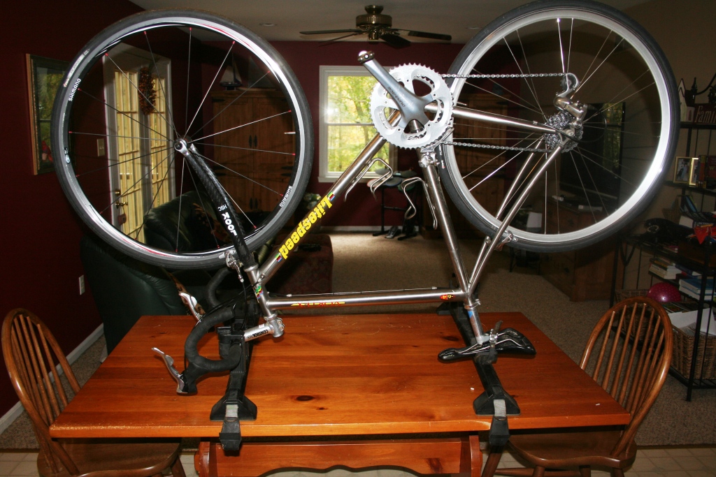

Mepsteins setup
Mepstein comments on his targa top setup used for 5 years, SEE POST # 17
More comments, SEE POST # 6
Comments by Rand SEE POST # 22
(IMG:http://www.914world.com/bbs2/uploads/post-10825-1287589824_thumb.jpg)
(IMG:http://www.914world.com/bbs2/uploads/post-10825-1287532185_thumb.jpg)

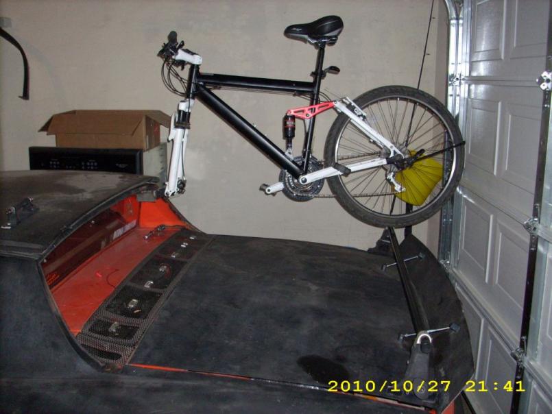

Andyrew
(IMG:http://www.914world.com/bbs2/uploads/post-172-1288246281_thumb.jpg)

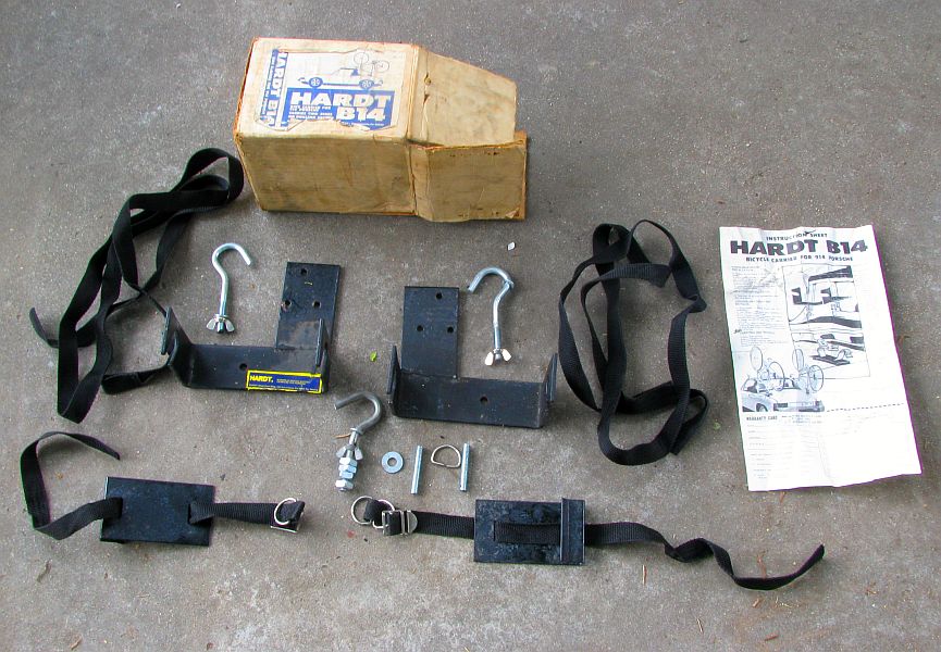

"Hardt"
REVIEW BY TOM_T, SEE POST # 8

UPDATE 10-27-10
I went and picked up some of these mounts on craigslist for 20 bucks for a pair. I have manufactured one side, But I dont like how it rocks back and forth a little. I only made it out of 14ga sheet metal, so Im going to retry it with some 1/8 ga metal.
Front Fork Mount
http://www.amazon.com/Delta-Bike-Hitch-Loc...d_bxgy_sg_img_c
http://www.amazon.com/gp/product/B000QJC5F...1RP5FC9V736ZE9W
I went and bought this ebay auction. ALMOST had it for 32, but some guy came in at the last minute and bid it to my max... Eh, 52 bucks is still good. I know they are the rain tray clip style but thats what it looks like some of the guys here have, I'll make em work (IMG:style_emoticons/default/smile.gif)
http://cgi.ebay.com/ebaymotors/ws/eBayISAP...RK%3AMEWNX%3AIT

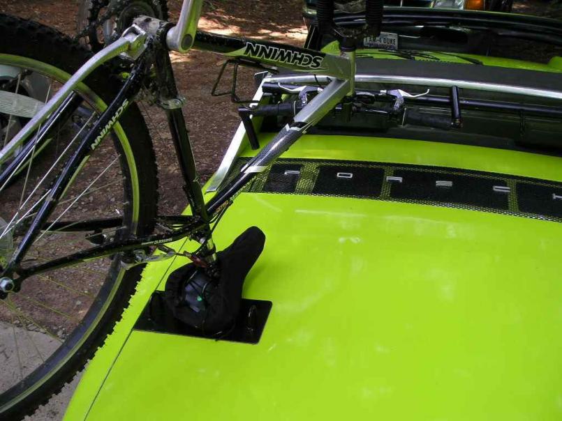

and Gopacks setup on the rear (I have a 6" rear autocross spoiler, so I need some clearance, or else I'd just copy Josephs setup.)

QUOTE(racerbvd @ Oct 19 2010, 07:28 PM) *
Why not mount a Yakama Tray & fork on an extra 914 top, there are plenty around. I plan on building one to haul my bikes to the track on..

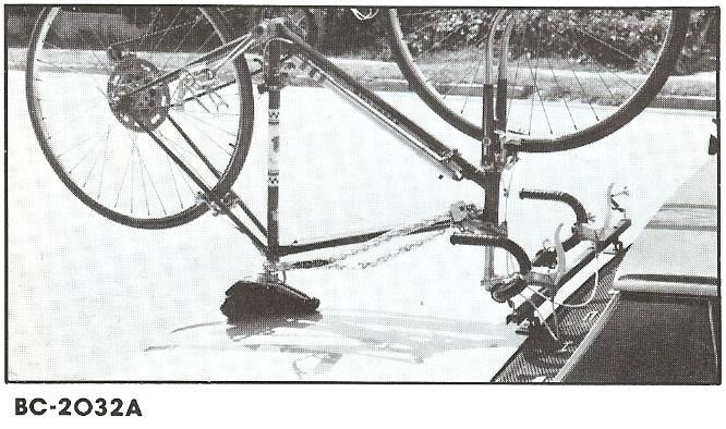

I managed a bike shop for 7 years. The guys who hung racks on thin sheet metal sports cars always complained of damage to the car. More if it was a heavier mt bike. The rubber coated hooks will also start to bend the metal even at the thicker sections of the seams and edges. The paint will scuff and scratch anywhere it has contact with the bike or the rack. Even with the roof mounted racks you must be careful since a hard turn will pull the bike to the side and put a lot of strain and torque on the clips that hold the roof on. They were not designed for this so be careful.
The one pictured is a Bic Sport Rack. Made in the '80, I used it weekly for 5 years. I'm glad I held on to it. it ataches quickly and can be stored in the rear trunk under the targa top. If I was buying one today, I would buy a Yakima or similar for the roof.
PS- the bikes mount upside down on this rack, attached by the handlebar and seat so they can easily fit the short roof of a 914.

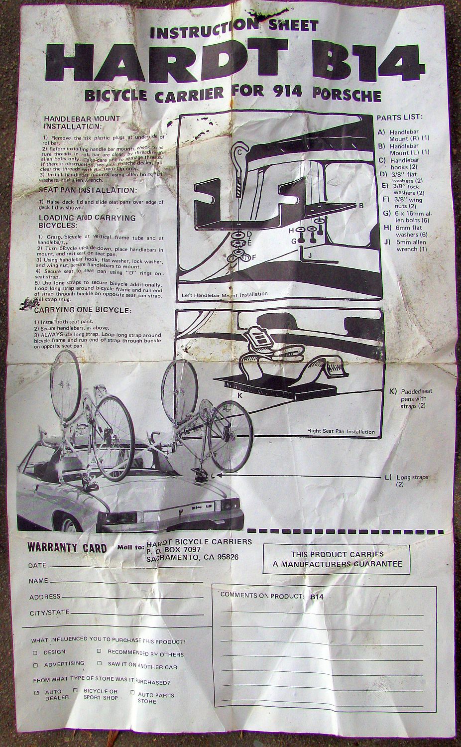

Okay Andy - I can comment on this one above, because it's mine. (IMG:style_emoticons/default/biggrin.gif)
BTW - the Hardt instructions above list 6x16mm Allen Bolts/screws for mounting under the rollbar (3 per side), & that's what was also used on ski racks mounting up under there.
Not necessarily in your number order above ......
Cost -
It was about $35-45 back in the late 70's from Chick Iverson Porsche+Audi (now Newport Porsche), so if you use the 2x per decade rule of thumb inflation rate, that's about $140-180 in today's dollars.
Stability -
Listen - common sense has to rule a bit here. You're just NOT going to find any bike rack set-up which allows you to corner all out, as you would without it on. The Hardt B14 was certainly stable enough for me to have a fun time driving, but I didn't go out playing "double the speed limit" (yellow diamond speed warning signs) on the corners either! You have to choose aggressive driving or a bit of common sense speed/cornering - or suffer the consequences to bikes, racks, 914 body parts, etc.! (IMG:style_emoticons/default/dry.gif)
Set-up & Dismount -
About 10-20 mins. including mounting 1-2 bikes - about the same either way on or off - but only 5-10 mins. to get just the bikes off to ride or access the rear trunk (see below) assuming you take off the trunk/seat plates to avoid their sliding or dropping to damage paint with the lid up.
Once you've got the hang of it, it was in the shorter time frame, or if you had a partner to help. You'll want the bikes well secured, so a race to mount them isn't helpful, as you're best to recheck & re-tighten everything once. Ergo, dismounting the bike(s) &/or racks is slightly faster.
BTW - with quick release wheels I usually removed them & put them in the rear trunk first/out last, in order to avoid theft when in food/pee/gas/etc. stop, since I could use a cable lock on each to secure them to the racks & park it in-view to at least deter theft.
Functionality -
I used it & it was stable & held the bikes well - even at freeway speeds & on the winders, but I used a couple of old towels doubled up under the plates for the bike seats where they go on the rear trunk/deck lid to protect the paint a bit more than the foam pads did.
That said - I still would not use it that way if your 914 has fresh paint, it's still pretty perfect, you're picky &/or is a CW queen. In which case I wouldn't recommend it at all in such cases, and probably not any bike racks nor my other hauling method for that matter.
The way it mounts you can remove/replace the targa top with the bikes on, but you still need to take them off to open the rear trunk to stow the top &/or to get at luggage/etc.
It can haul either 1 or 2 bikes (street + mountain, 1 for your gal or buddy), with the securing straps to an empty seat plate with just 1 bike (see instructions pic above). I liked them & used them often 76-85 & never had a problem with them, and was very careful to not cause paint damage.
But frankly, when hauling just my 1 bike - unless I needed the rear trunk for luggage, camp gear, etc. - I just took off the quick release front hub/wheel & stowed it in the rear trunk with a towel over the rear wall/lip & a shoestring to secure the trunk lid (wink-wink-nod-nod), since I didn't have quick release pedals & the height was a bit more than the trunk closed dimension with them on. That was usually a lot faster & easier for a quick trip by myself to San Diego or wherever to go cruzin with my buddies.
Future Use & What to Do Different -
That above was when it was my DD & only car as well, so I had to use it more functionally then - than I & others do today as a collector/vintage car (or than I will do - whenever my resto is done, that is! (IMG:style_emoticons/default/dry.gif) ). I doubt that I'll use them soon after my resto - until a later time when the paint isn't quite perfect anymore, unless if I can take some additional steps to protect the paint & bodywork from damage when in use.
Other Bike Rack Ideas -

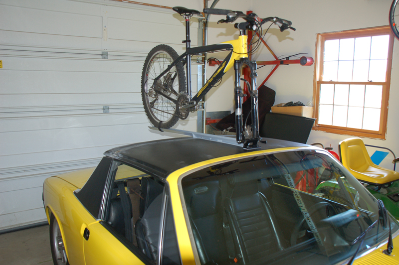

I've seen another set-up similar to Elliot's modified Yakima set-up below, except that it had 90 degree-angled riser plates similar to on the Hardt I have - connected under the rollbar & extending up, to carry a standard Yakama cross-bar above & clear of the rollbar & targa top. That guy had used it for skiis, surfboards, kayaks, bikes, etc. The downside is that everything had to come off to access the rear trunk.
For skiis alone, that is why I preferred the ski racks which spanned flat above the targa top from the rollbar mounts to the ones in the windshield frame, because the skiis could stay on & locked in place, but still get access to the rear trunk for your stuff. I used these ski racks for about the same price & purchased from the same P+A dealer in the late 70's.
Word of Caution on mounting into Targa Top -
The FG targa top will crack & break with the stresses of a bike rack etc. mounted into it - even if it's a 2nd top, which is just asking for trouble. A lot of VW Westy owners have had trouble with the FG pop-tops cracking/failing with the various roof rack mounted on them & loaded up. It would have to be a highly reinforced top - or steel with under bracing as with the 916/914-6GT racers' steel roofs - in order to hold up.
Even then, you're adding a lot of stresses to the windshield frame, which can be bent out of position simply by people using it as a hand-hold getting in & out of the car! Plates or washers alone underneath won't prevent the FG from cracking with a couple of bikes above & the speed & cornering forces the 914 will generate - & a steel X-brace with welded plates for the rack attachments - similar to what many 914/4 & 914-6 racers use for bracing the rollbar to windshield frame - may or may not "save" the FG top from stresses from the through bolts to the rack.
Plus, I don't even know if the targa top latches will stand up to the stresses & weight of a couple of bikes up there! (IMG:style_emoticons/default/blink.gif)
Hope this helps your quest for the Holy Grail!

Mine has been tested at 110 MPH with the bike on it. (IMG:style_emoticons/default/driving.gif) (IMG:style_emoticons/default/biggrin.gif)
Cheers, Elliot

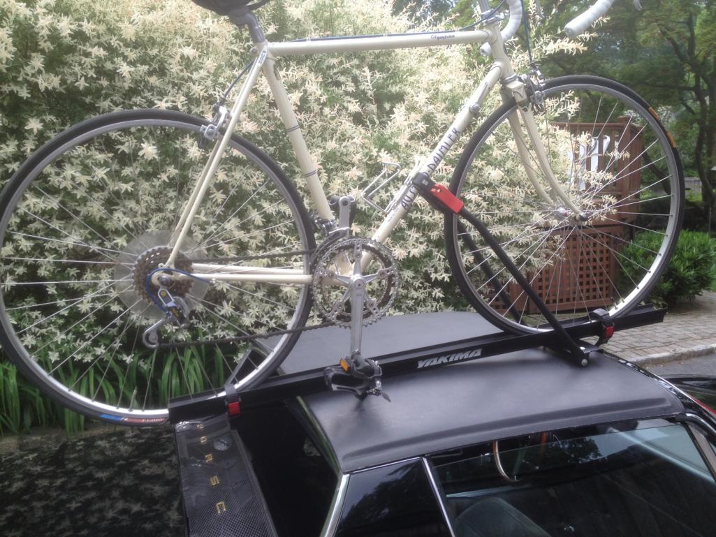

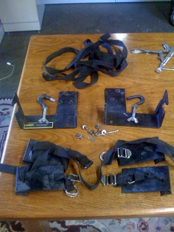

Car is being restored. This will have to do for now. I also used a strap that went through the crankset to each end of the rack to keep the bike from swaying on turns. I -sort of- took the turns more carefully with the bikes on the top but still did almost 100 at times on the straights. Don't tell my kids (IMG:style_emoticons/default/biggrin.gif) Mark

Thanks! I was hoping you had a pic from the years you used it daily, but this will certainly do!!
