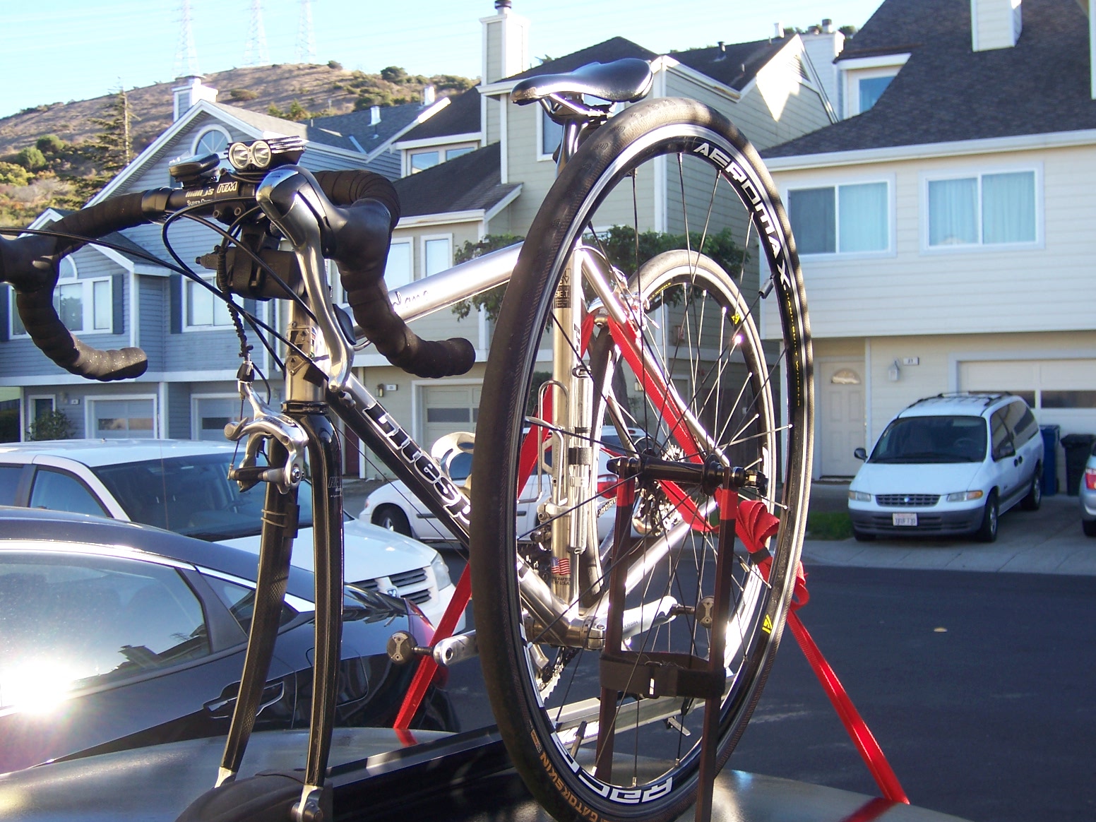

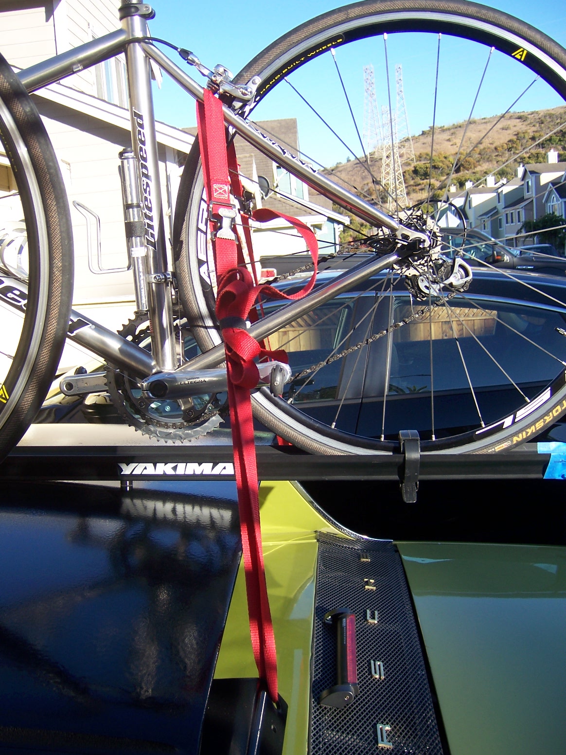

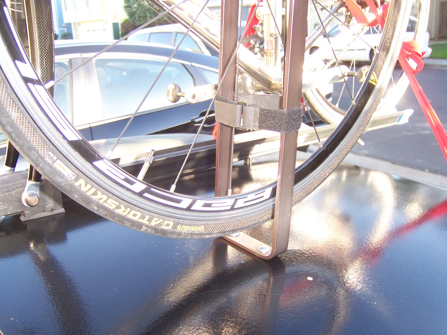

Here is my rack, similar to a lot of others here; Mine uses a Thule head unit, a Yakima rail, and a Thule wheel strap that has been modified to fit on the Yakima rail. The wheel holder is also Thule. the seat stays of the bike are strapped down to aluminum plates attached beneath the targa and make for a solid triangulated mount. the wheel mount simply uses the velcro strap to keep the wheel from spinning. I had a different version from a couple of years ago, but just now used what rack parts I had laying around on an extra targa top.

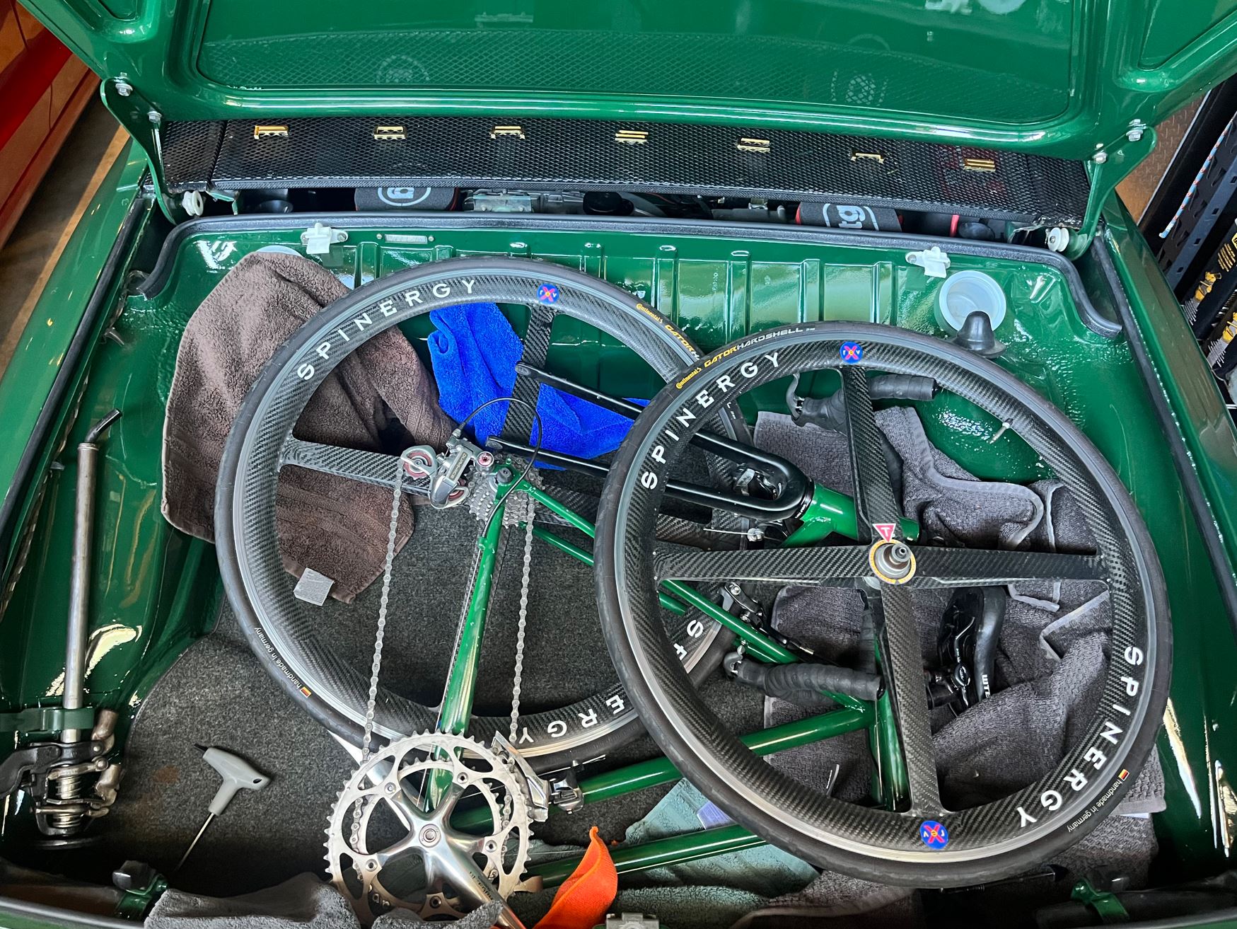

Okay so instead of putting the bike on the car, put the bike in the car. (IMG:style_emoticons/default/biggrin.gif)
It just barely squeezes in there
(Spent the previous year at college making this folding bike concept.)
It is a little floppy around the hinges but hopefully the next year I'll get around to making another one that is more rigid.

You went old school with the spinergy wheels. I haven’t seen them since the 90’s.

QUOTE(mepstein @ Mar 24 2024, 06:23 AM) *
I don't ride them on group rides - with their 'reputation' but this set is the generation that doesn't explode. They are flatter than most wheels so I thought I would try them to save even more space.
They are probably the quickest wheels I've got save for some old dupont tri-spokes. My father used both for triathalons in the 90's.

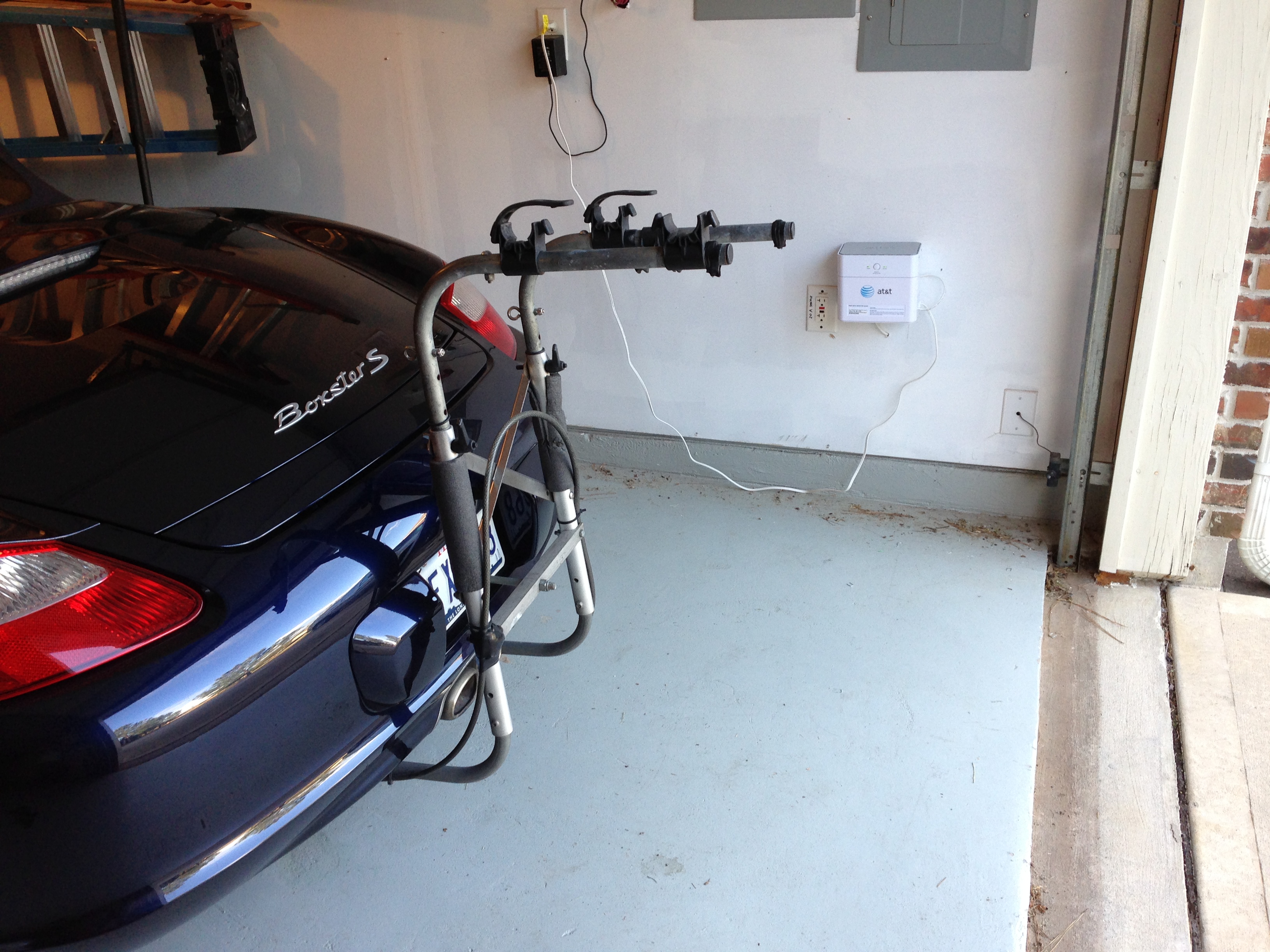

Not a 914, but here is the rack I had on my Boxster. Made by Bird Automotive, it had a pair of receiver tubes that mounted under the car, and the rack then slid in (and out) easily. To prevent wobbles, it cam with straps that hooked onto the leading edge of the trunk lid. I changed that by adding a bracket that bolted into the Boxster rear tow hook hole behind the license plate.
I never tried but I bet the Bird rack could be adapted to the 914.

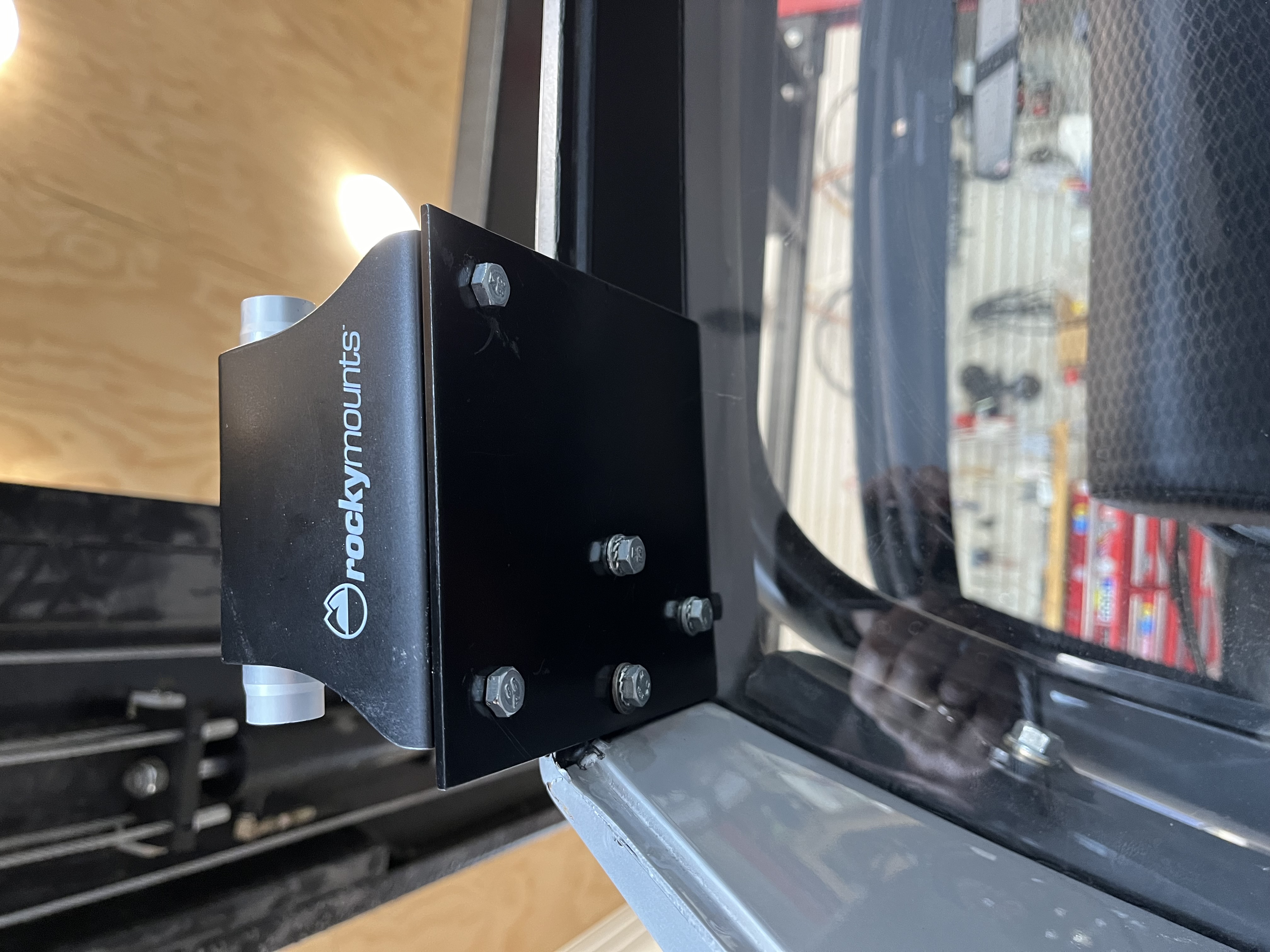

Taking some suggestions from you all, I made a little mount today while working on my targa top. It was simple and it's super secure to attach it to the ski rack mounting holes under the targa top. I love the idea of going topless to rides next summer with this set up.

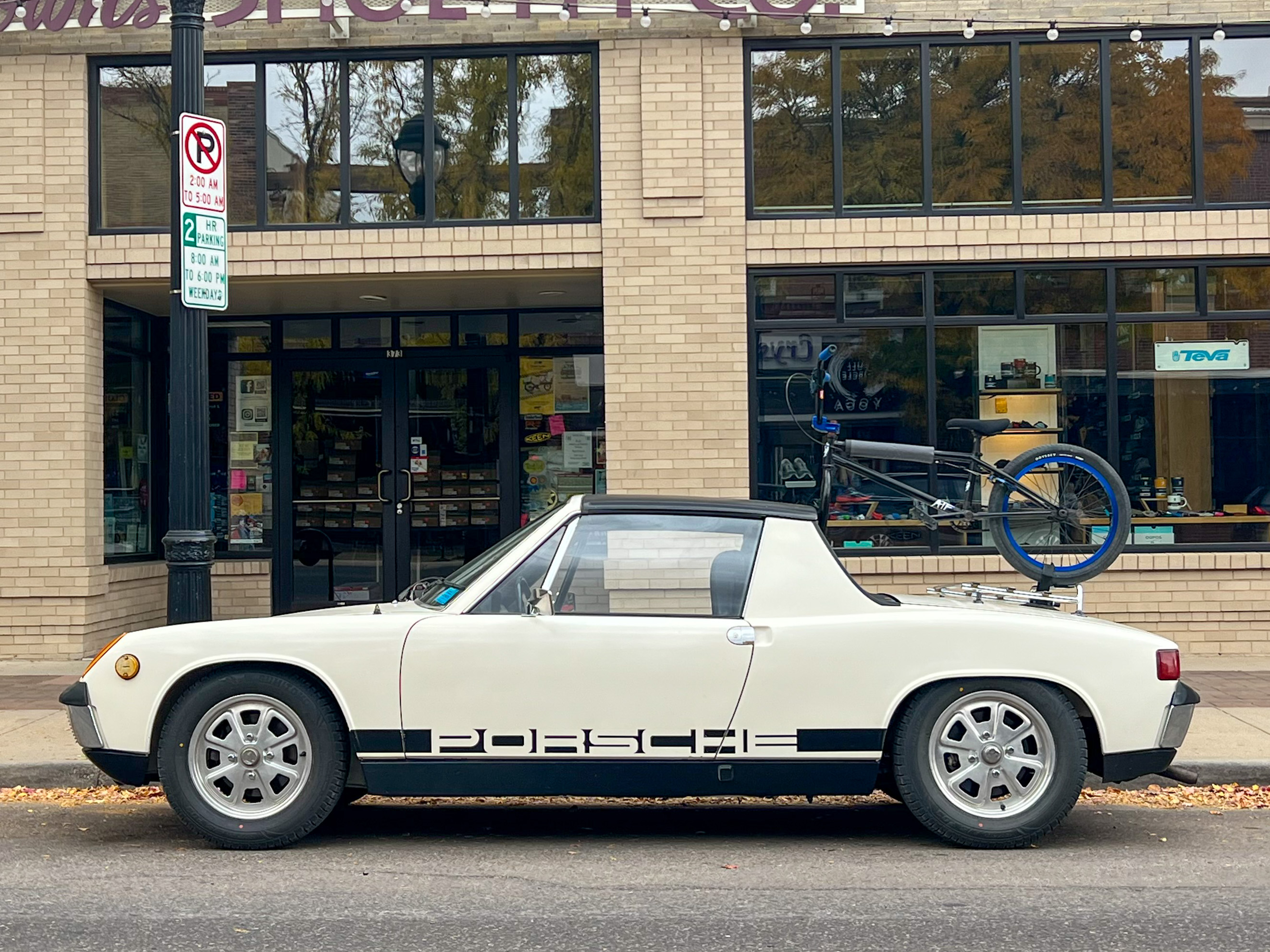

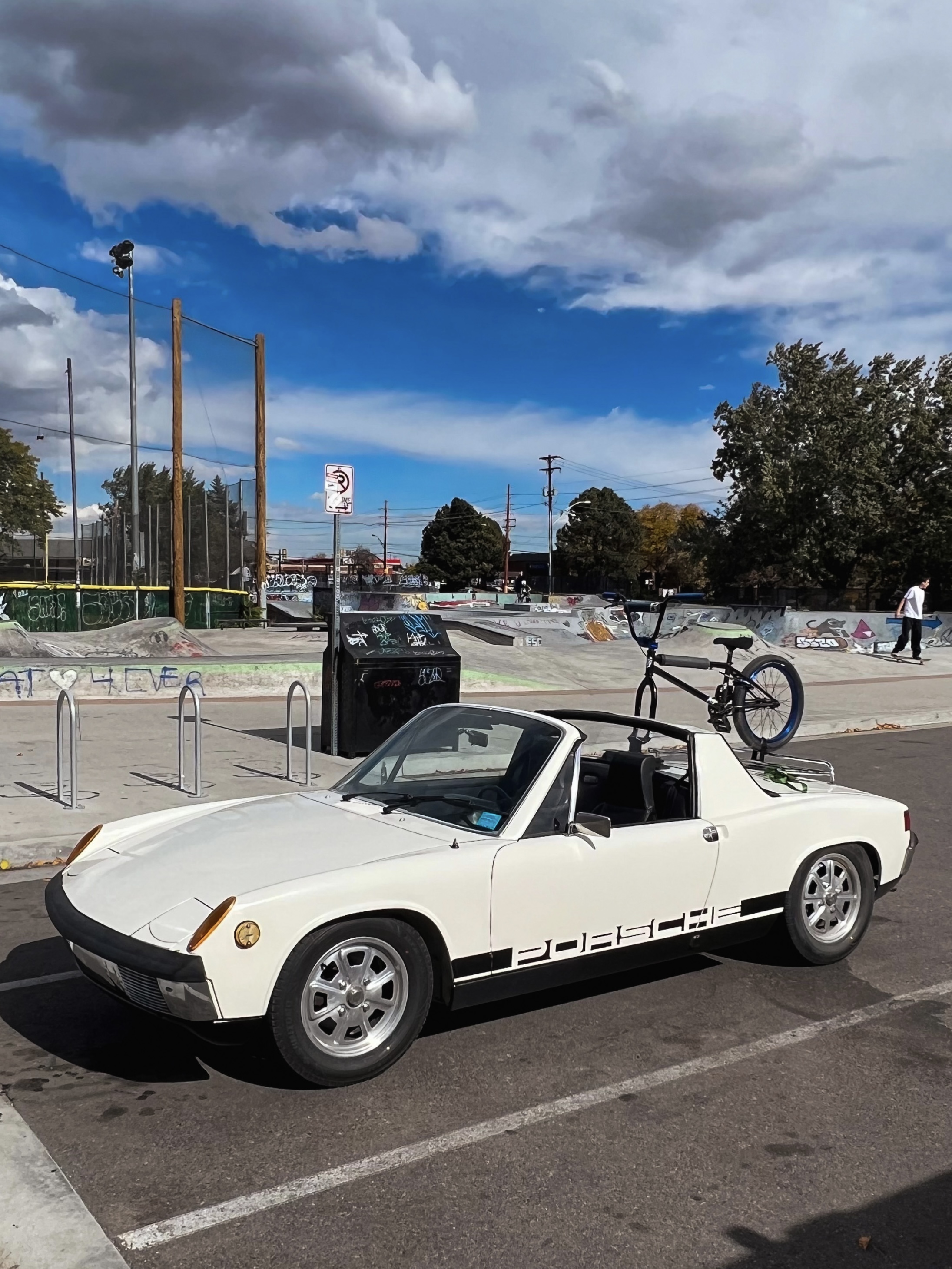

Full set up with Sea Sucker rear mount

QUOTE(morehills @ Oct 29 2024, 05:31 PM) *
What are you doing with your front wheel? That was the sticking point for me that made me use a bar. I could not get the front wheels for 2 bikes to fit in the car anywhere while we had the car loaded for the weekend away.
I love the install. Super clean!

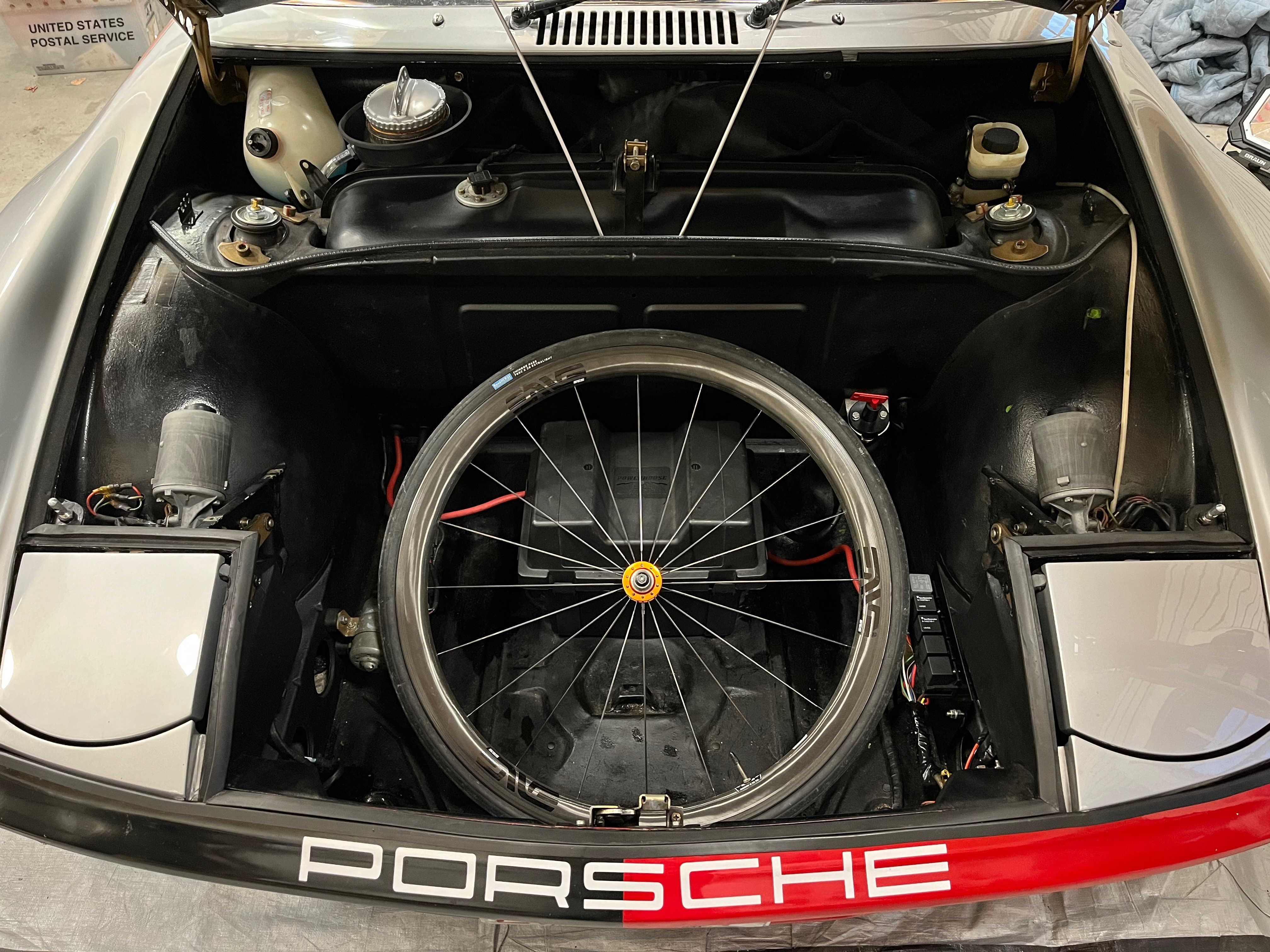

Zach, I put it in the frunk. It fits nicely against my battery box. But I'm not traveling with extra gear and I don't have a spare (just an emergency goo and pump kit). So definitely not a long hauler, but I think I could squeeze in a soft bag or two.
