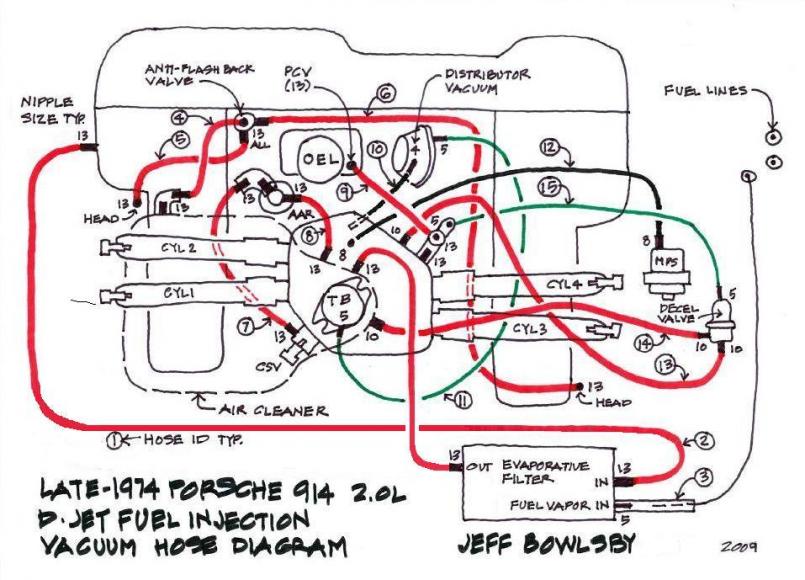

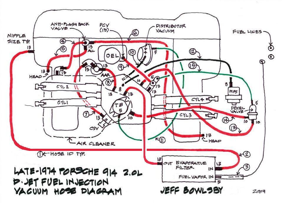

Hey Jeff, you have one of these for a '73?
JeffBowlsby
post Oct 24 2010, 05:39 PM
Posts: 9,392
Joined: 7-January 03
From: San Ramon CA
Member No.: 104
You bet! Courtesy of Dave Darling: Check here:
http://bowlsby.net/914/Classic/TechNotebook.htm
hot_shoe914
post Oct 24 2010, 09:41 PM
on ramp passer
Posts: 3,807
Joined: 20-November 07
From: Earle, Ar.
Member No.: 8,354
QUOTE(Jeff Bowlsby @ Oct 24 2010, 06:39 PM) *
Thanks man, now I can make sure everything is in the right place on both the '73 and the '74. (IMG:style_emoticons/default/pray.gif)
