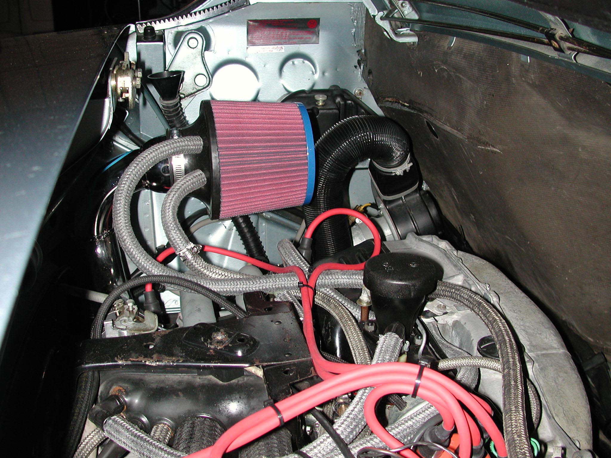

Cupomeat
Funny discourse, thanks!
Just an opinion, but if you play with bundling and routing you can have a good looking motor without all the negatives that removing vacuum lines will result in.
