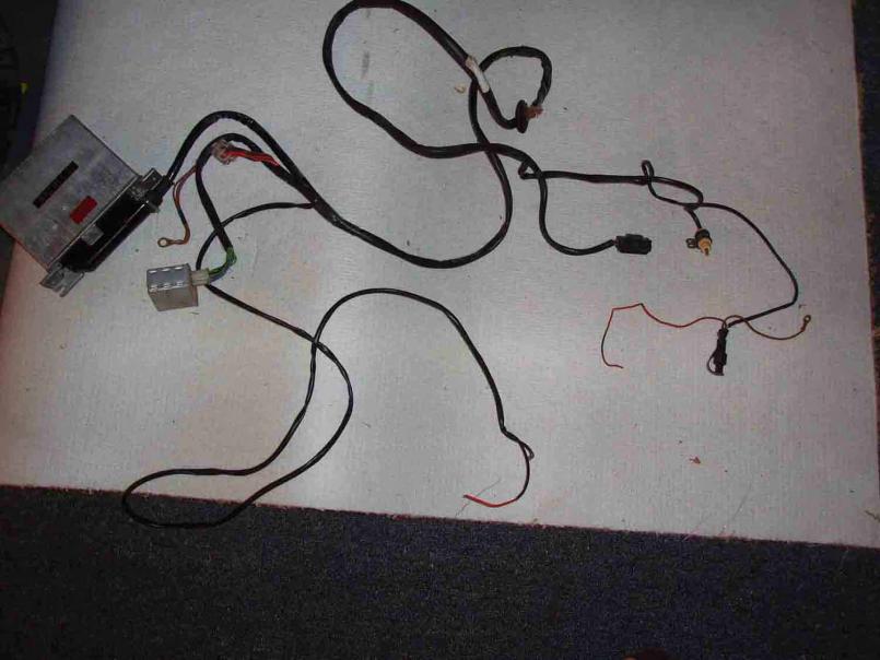

sixnotfour   if you get a harness it should be easy. http://cgi...   Oct 21 2010, 05:14 PM
Cap'n Krusty   if you get a harness it should be easy. http://cg...   Oct 21 2010, 05:47 PM

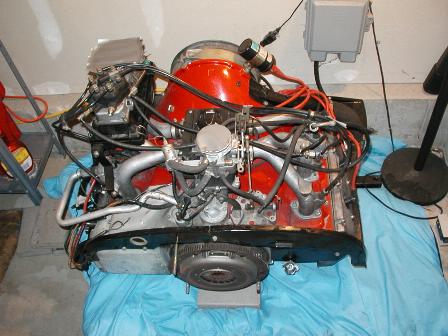

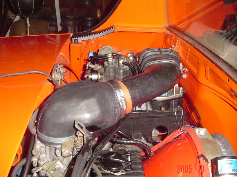

Ferg   That's my old 2.7, I took that picture on the ...   Oct 22 2010, 09:21 AM
sixnotfour   agreed just effin with slits, 3.2 motronic, now y...   Oct 22 2010, 10:03 AM

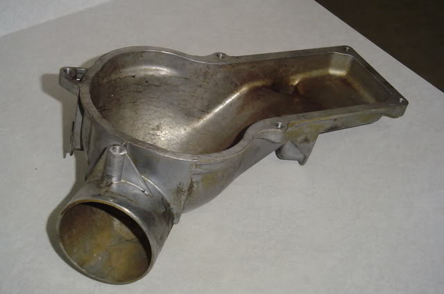

Jeffs9146   What was that airbox from, and what parts did yo...   Oct 22 2010, 10:21 AM
Ferg   What was that airbox from, and what parts did y...   Oct 22 2010, 11:13 AM
Cap'n Krusty   I don't think he needs it to build you a main ...   Oct 22 2010, 11:10 AM
Bee Jay   I don't think he needs it to build you a main...   Oct 22 2010, 11:44 AM
Jeffs9146   :agree: The Cap'n is right the harness is a st...   Oct 22 2010, 12:41 PM
Bee Jay   :agree: The Cap'n is right the harness is a s...   Oct 22 2010, 02:18 PM
montoya 73 2.0   Could you use a Aluminum Air box? I think I have a...   Oct 22 2010, 01:56 PM
