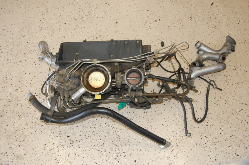

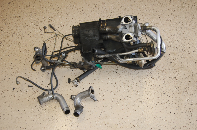

Jeffs9146
Oct 22 2010, 08:57 AM
This is my goal!
