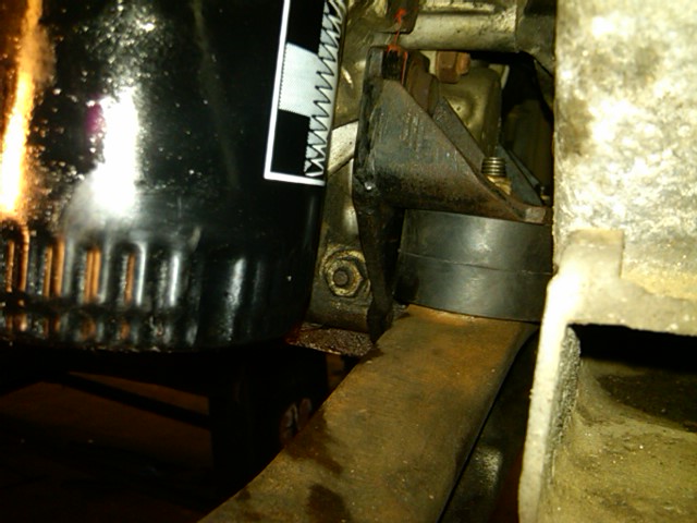

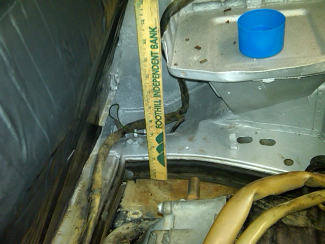

here we go. had to re shoot in a really low res

its like this all the way around

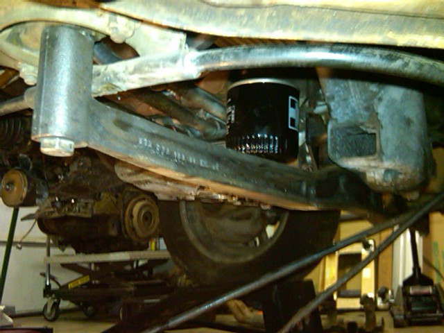

Attached Imageheres the bar (IMG:style_emoticons/default/confused24.gif)

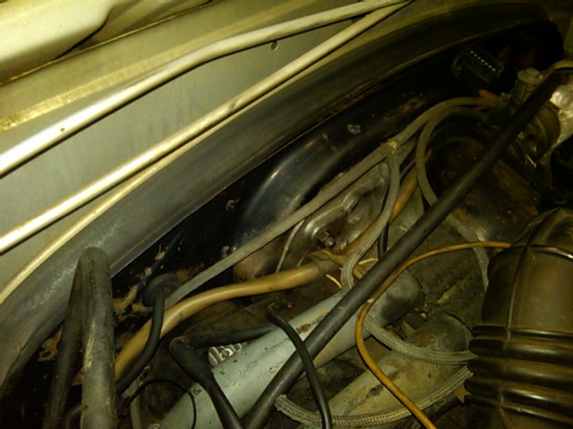

and the new mounts

Its all good (IMG:style_emoticons/default/smile.gif)

QUOTE(silver74insocal @ Oct 23 2010, 06:40 PM) *
Hey Dave (IMG:style_emoticons/default/bye1.gif) There a couple of ass bite marks in my passenger seat. You don't know anything about that, do you? (IMG:style_emoticons/default/av-943.gif) (IMG:style_emoticons/default/lol-2.gif) Is that bar pulled up snug. It doesn't look like it from my angle. Which ain't so good! Hasta manana.
