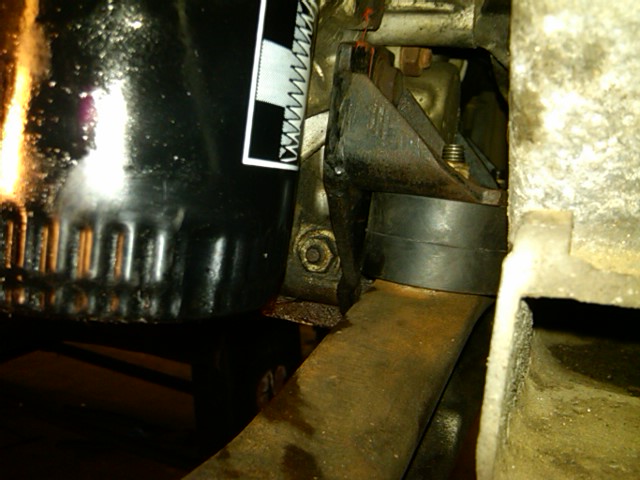

worked all night to install a new to me engine and trans. used the furniture dolly method and it went off without a hitch (i thought) except i forgot to put blocks under the back calipers before laying her butt down to attach the trans. now everything is back in except the engine appears to be about an inch and a half too low. engine bar is tight, i did replace the old broken engine mounts with stock ones from the bird. defeated, i retreated to the house to ponder the situation with a glass of bourbon beer3.gif tomorrow is the g and r meet so im hoping if a effed something up i can get a replacement there.
any ideas? TIA ,DAve

rubber mounts outboard on motor bar used on a late stlye bar might cause this what year car? do you have rubber mounts on both the motor mount bar ends AND where bar attaches to motor? (that would be wrong)
silver74insocal
its a 74 and the rubber mounts are between the bar and the engine. they are exactly where i removed the old ones from, which were ripped off leaving just the metal plate and studs confused24.gif let me see if i can get some pics...

silver74insocal
here we go. had to re shoot in a really low res
silver74insocal
its like this all the way around

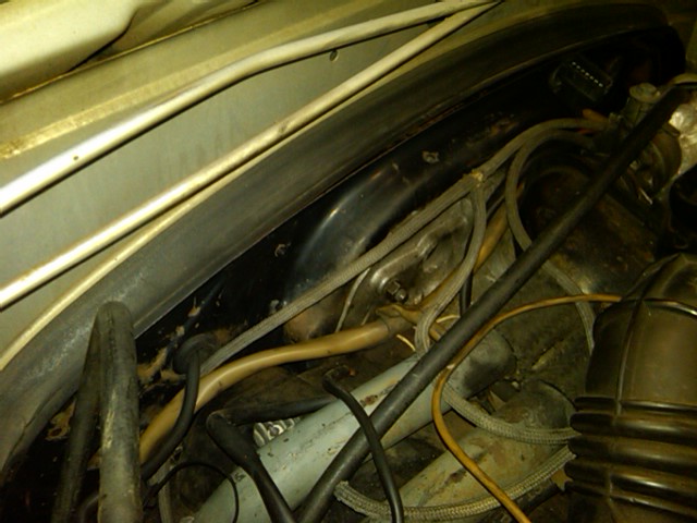

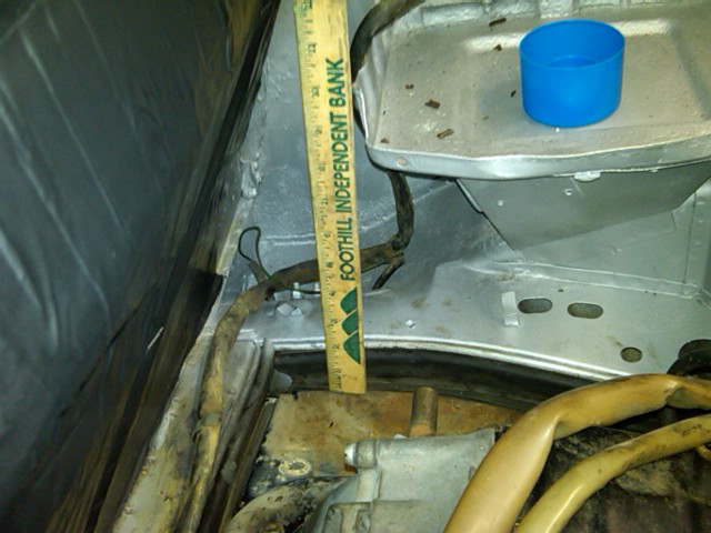

silver74insocal
silver74insocal
and the new mounts

76-914
QUOTE(silver74insocal @ Oct 23 2010, 06:40 PM) *
Hey Dave bye1.gif There a couple of ass bite marks in my passenger seat. You don't know anything about that, do you? av-943.gif lol-2.gif Is that bar pulled up snug. It doesn't look like it from my angle. Which ain't so good! Hasta manana.

rick 918-S
QUOTE(majkos @ Oct 23 2010, 07:53 PM) *
QUOTE(Dr Evil @ Oct 23 2010, 04:07 PM) *
OMG! laugh.gif Your a funny guy Kev.
Can't help with the mount thing. Looks right to me unless I'm missing something. confused24.gif
