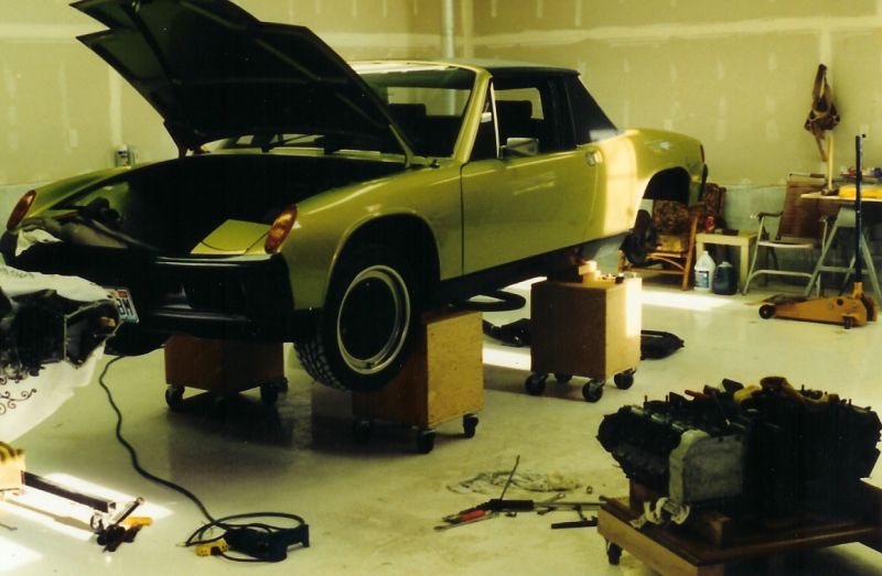

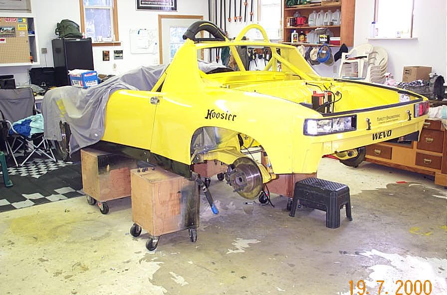

J P Stein
post Oct 25 2010, 05:50 AM
Irrelevant old fart
Posts: 8,797
From: Vancouver, WA
Member No.: 45
I used to do this every winter with a CSOB foor jack.
Pics taken about 10 years appart.
