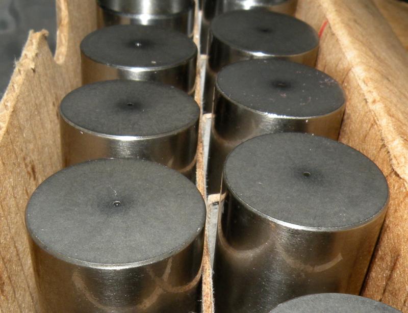

Hey those look like Scat lube-a-lobe lifters. Cool.
Jake Raby
post Oct 26 2010, 06:48 PM
Engine Surgeon
Posts: 9,398
Joined: 31-August 03
From: Lost
Member No.: 1,095
Looks can be deceiving. When compared side by side the differences are notable.
