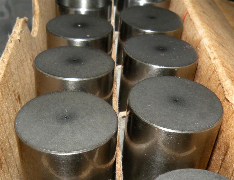

Borderline
Hey those look like Scat lube-a-lobe lifters. Cool.
Jake Raby
Looks can be deceiving. When compared side by side the differences are notable.
