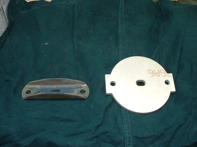

It seems almost every engine I've taken out of a 914 had engine brackets that are distorted and have wallowed holes. So I had my local hydro-cut shop make some new brackets that spread the load and will hopefully stop all the distortion. These are made from 1/4" aluminum.
I'm going put the first set on my 24 hours of LeMons car.
Thanks
Joe

Good idea (IMG:style_emoticons/default/smile.gif) though I would use 3/8 aluminum and big washers on each side of the plate.
One of the reasons the metal ones get bent is the bar catches on a driveway or some other obstruction and/or when someone removed the engine GB combo, they lowered the gearbox end before unbolting the bar.

That makes sense. I didn't think about the bar catching on various stuff. Some of the brackets I've taken out look like they are barely holding the engine in the car because they've been distorted so badly.

Your alloy versions do look good and will rightfully distribute the load a lot better in the chassis provision, than the stock ones (IMG:style_emoticons/default/smile.gif)! Though 1/4" is too thin, maybe double stack them?

I do not think the aluminum is up to the job.
My thoughts, exactly.
