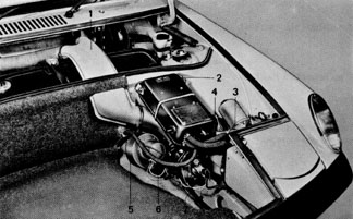

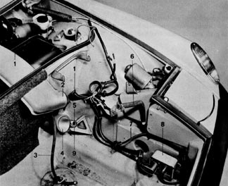

Webasto made a unit specifically for the 914 ...
(IMG:http://www.914world.com/bbs2/uploads/post-104-1268855767.jpg)
(IMG:http://www.914world.com/bbs2/uploads_offsite/bowlsby.net-179-1290276837.1.jpg)
(IMG:http://www.914world.com/bbs2/uploads_offsite/bowlsby.net-179-1290276838.2.jpg)

QUOTE(SirAndy @ Nov 20 2010, 11:13 AM) *
The ducting fits over the gas tank and under the hood still? I was under the impression that there wasn't room there. (but somehow I know the lightbulb in the fridge shuts off when the door closes)
McMark
post Nov 20 2010, 03:53 PM
914 Freak!
Posts: 20,180
Joined: 13-March 03
From: Grand Rapids, MI
Member No.: 419
Jim, notice the height of the filler neck on the other side. That's how much room you have to play. Also notice that the heater ducting runs through the front bulkhead, not over it.

QUOTE(RJMII @ Nov 20 2010, 03:21 PM) *
It looks like it's ducted into the air blower box. Hard to see in this picture.
