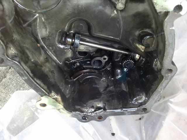

Unscrewed the drain plug. This does not bode well:
More carnage is visible once the nosecone is off:
I need bigger tools to get the fifth gear and reverse off, so I can't get to the innards where the real action is right now. Will investigate that tomorrow. I found parts of what I suspect is a grenaded second gear. It remains to be seen whether the transmission is a lost cause. Input is appreciated. Maybe I should just get a 930 and be done with it...

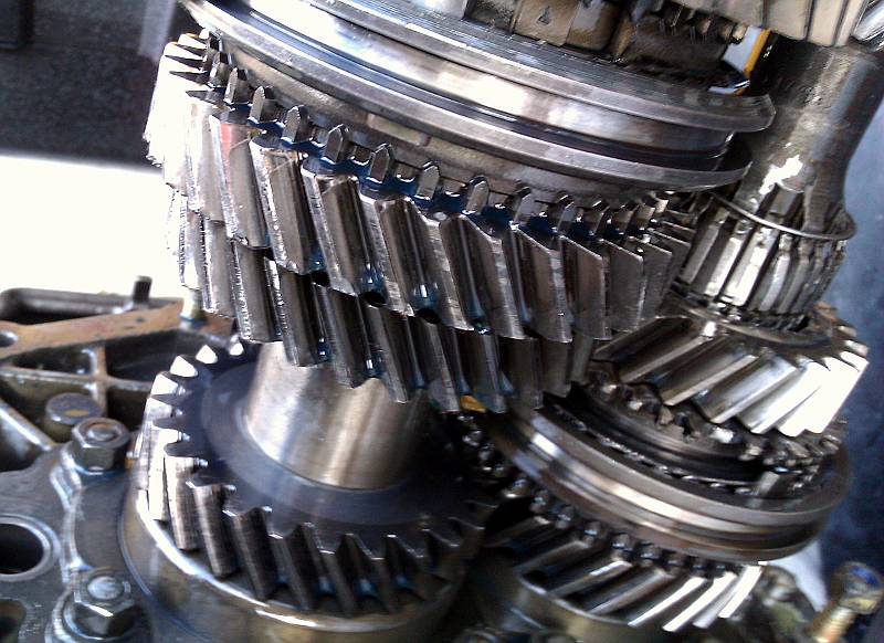

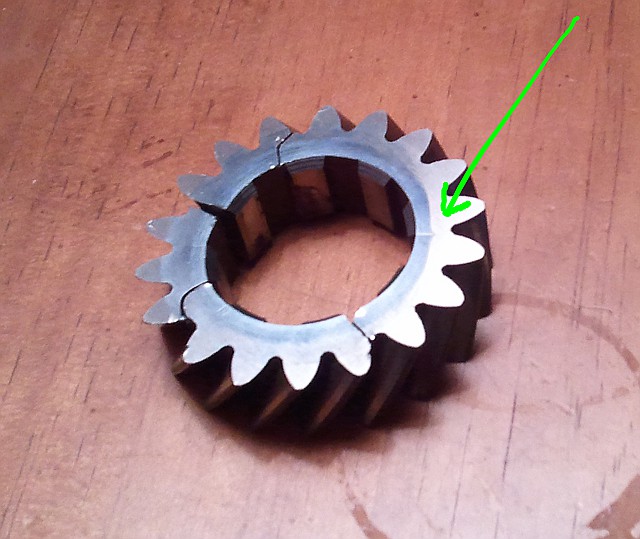

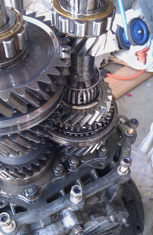

Got hold of some bigger tools, and pulled off 5th and reverse to inspect the internals. Hello Mr. Second Gear. Here's what it looks like after I pieced together the remains.

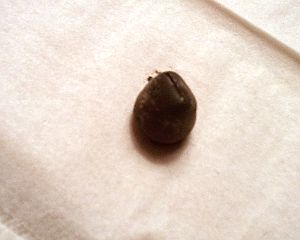

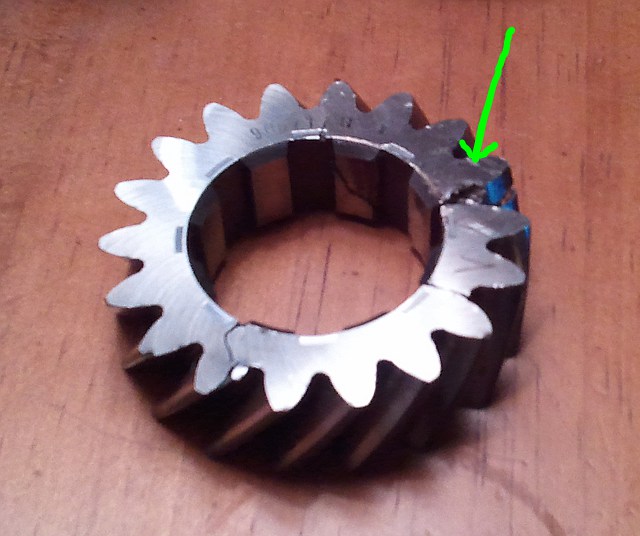

At the green arrow, there's a big indentation in the gear. The current hypothesis is that a dog tooth broke loose and made its way into 2nd gear, leaving the witness mark and shattering the gear. Inspecting the 3rd gear synchro, reveals that there's indeed a dog tooth missing.
Looking at the backside of the gear reveals fracture lines (one at the green arrow). By the looks of it, these appear to have been there quite a while, but I may be mistaken.
Didn't snap any pictures of the shafts before it got dark, but the second gear is obviously toast, the third gear has damage, along with its synchro. Will get some pictures of that tomorrow.

Caught a cold today, so nothing of interest happening. Found a guy in Oceanside who might have some gear stacks that I can scrounge. Didn't get hold of Sean to see what he has found.
Here's the gear stacks with broken parts. Broken dogtooth in the middle of the picture.
Damaged gears. 2nd, 3rd and 4th will have to be changed.
The dog teeth generally look quite worn, which probably is why it popped out of gear in the first place.

Your slider is worn, that is why it popped out most likely and broke the dog tooth. There is a needle bearing missing its needles there as well. That is what was stuck to the magnet.

Thanks for the insight. That's what I'm thinking as well, but it's good to have the experts weigh in. It doesn't look like the transmission was in the best of conditions before this happened.

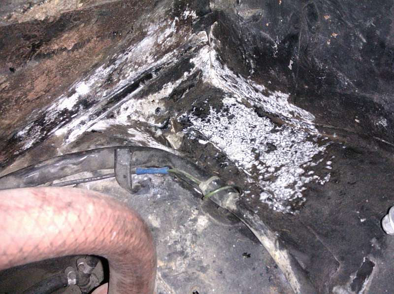

Pictures of the hell holes, as promised, treated a few times with Naval Jelly. Driver's side doesn't look so nice, but seems to hold up. Engine shelf has holes, but I don't need the shelf itself, so I'm not so worried about that.
Passenger side is a little worse. The pitting is more obvious, but no holes so far. All surrounding panels have holes, though.

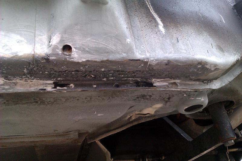

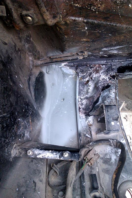

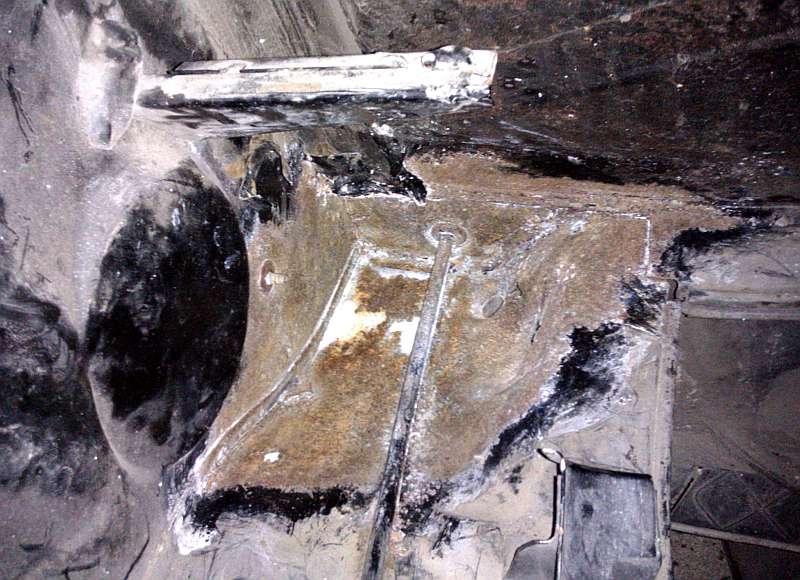

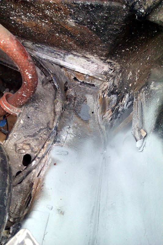

Rust removal continues. Have been derusting the hell hole and various other places. After a few days I finally found a hole in the long:
Further up, things appear to be in fair condition, the gray stuff is zinc primer over completely derusted metal. At this stage, some welding is required, so further derusting is pointless.
On the left hand side, things went a little better. I found two pin holes, but otherwise it seems to be pretty solid. I'll be getting an expert opinion on this when I get the car on all four wheels again. The engine shelf is toast, but that will be deleted in any case.
There appears to have been some leakage of water into the long, however. Under the jack post, the long has rusted through, probably from the inside. It's not very obvious from the picture, may have to snap another one:

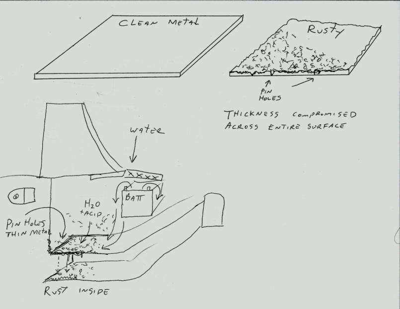

...and the vertical wall (inner wheel house)behind the battery is a sheer panel. it helps keep the chassis box section (longitudinal) from flexing. while the vertical sides of the long keep things staight, the top and bottom of the long carry the load of flex in teh vertical plane. think I beam
sean_v8_914
post Dec 16 2010, 08:25 AM
Chingon 601
Posts: 4,011
Joined: 1-February 05
From: San Diego
Member No.: 3,541
snap a photo of the seam under teh hell hole. the bottom of the car where the 2 clam shells come together to form teh box
regardless, I would cut open that deeply pitted top of teh long from teh fire wall 12 inches back , up to the clean metal. cut off the lower fire wall, cut off teh engien shelf. once the long is open, you can treat the minimal surface rust you are going to find in there.
I doubt the jack point to be structurally compromising the long based on these photos but it is structurally important so carefull inspection will follow
once the top of the long is cut open we can inspect the jack point from teh inside

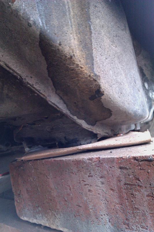

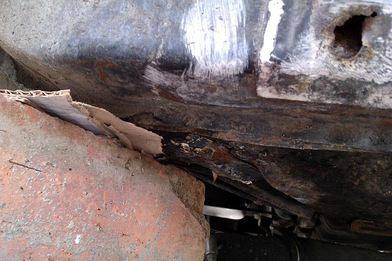

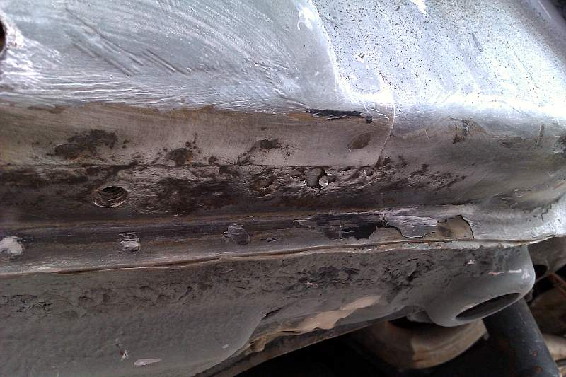

Got a better picture of the underside of the LHS long:
The underside of the RHS long appears to be better, but I have the car sitting on a tire on that side, so I haven't been able to dig into it too much. A cursory glance at the seam doesn't reveal anything too disturbing.
The jackpost on this side is not good, and will have to be changed. Hard to say if the damage is coming from the inside of the long, but it doesn't look like it.
sean_v8_914
