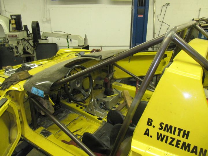

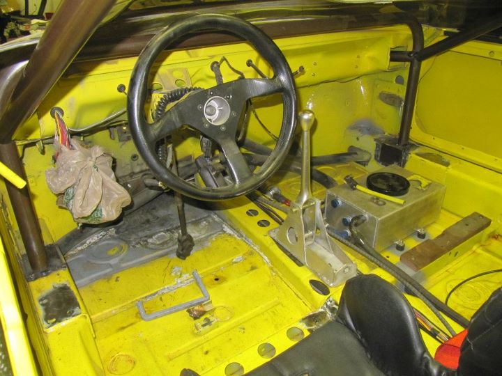

First off, the new cage is coming together nicely. The regulations to get my head under the cage and to meet the broomstick rule forced me to mount the seat lower and farther back and raise both the main hoop and the a-piller bar under the windscreen.
Here is the cockpit area.
(IMG:http://www.914world.com/bbs2/uploads_offsite/a5.sphotos.ak.fbcdn.net-364-1328743652.1.jpg)
You can see how high the front a-piller bar is now.
(IMG:http://www.914world.com/bbs2/uploads_offsite/a6.sphotos.ak.fbcdn.net-364-1328743652.2.jpg)

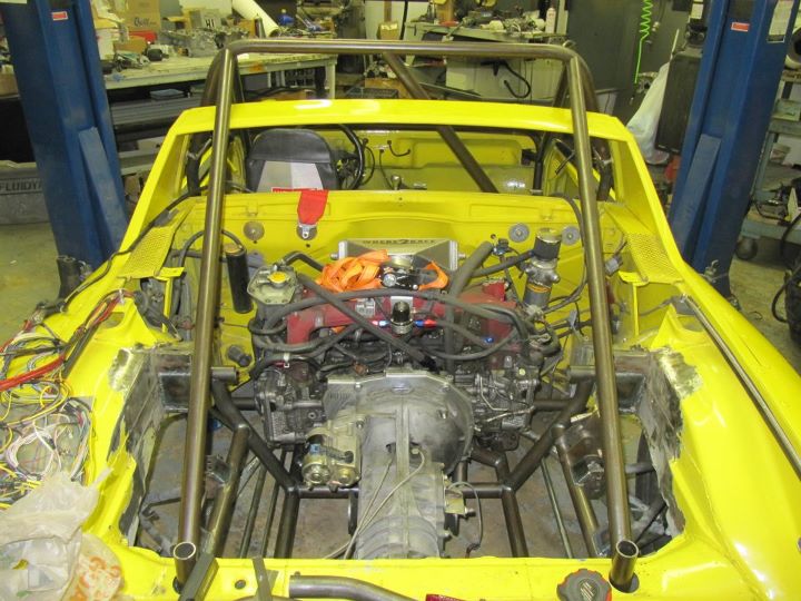

The raised main hoop and the rules around the downbars forced me to either cut the targa bar or go over it...I decided to go over it and pick-up the rear suspension point.
(IMG:http://www.914world.com/bbs2/uploads_offsite/a4.sphotos.ak.fbcdn.net-364-1328743653.3.jpg)

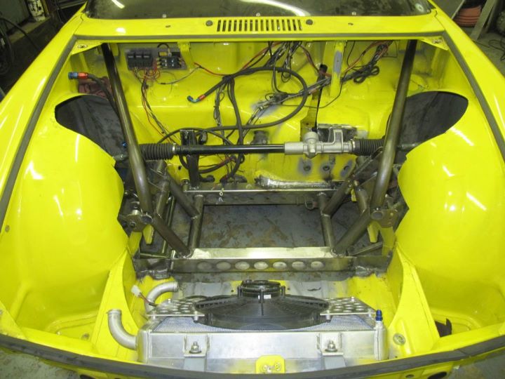

In the front, two bars extend from the top of the a-piller to the front suspension sub-frame. There will be two additional bars from the lower part of the a-piller forward that still need to get done.
(IMG:http://www.914world.com/bbs2/uploads_offsite/a3.sphotos.ak.fbcdn.net-364-1328743653.4.jpg)

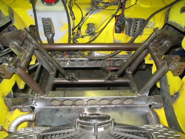

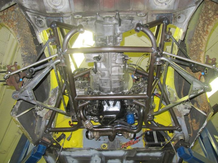

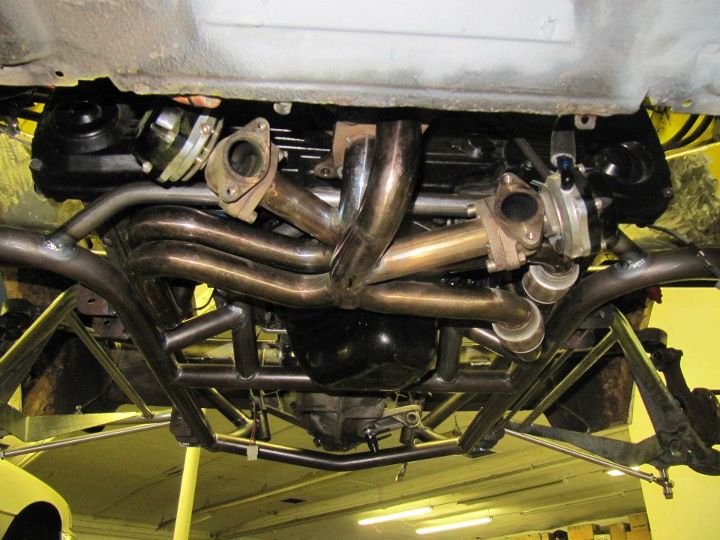

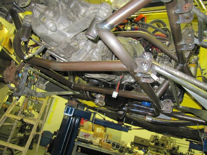

Back on the rear sub-frame. Additional bars added to the rear lower subframe to strenghten the structure and triangulate everything.
(IMG:http://www.914world.com/bbs2/uploads_offsite/a7.sphotos.ak.fbcdn.net-364-1328743911.1.jpg)
And the other side.
(IMG:http://www.914world.com/bbs2/uploads_offsite/a4.sphotos.ak.fbcdn.net-364-1328743911.2.jpg)

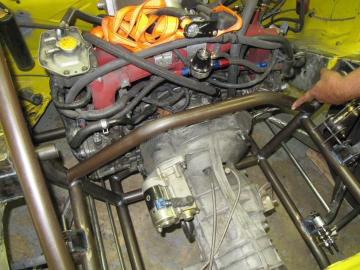

A bar was added over the transmission and tie in the two sides of the rear sub-frame.
(IMG:http://www.914world.com/bbs2/uploads_offsite/a3.sphotos.ak.fbcdn.net-364-1328743911.3.jpg)
Another bar under the rear of the transmission that can also serve as a jack-point.
(IMG:http://www.914world.com/bbs2/uploads_offsite/a2.sphotos.ak.fbcdn.net-364-1328743911.4.jpg)
And finally a turbo mount bar that snakes up above the header and will help tie together the subframe.
(IMG:http://www.914world.com/bbs2/uploads_offsite/a8.sphotos.ak.fbcdn.net-364-1328743912.5.jpg)

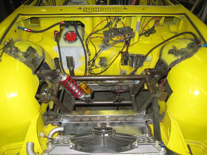

It is always the small stuff that takes up all the time. I had to make a new seat bracket, relocate the pedal assembly, make a hold for the dash off the a-piller bar and a couple of other small things.

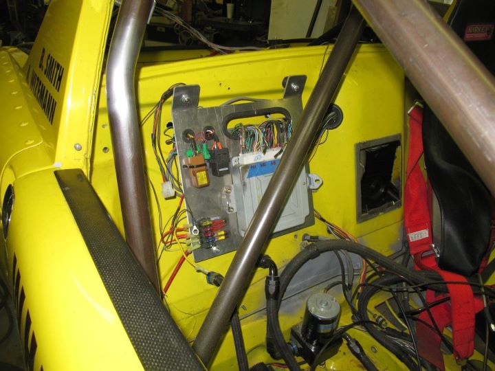

Here is the relocated the ECU to the passenger firewall. I will need to construct a nice cover to keep it out of the elements. Fortunately I only had to rewire a handful of the wires to move it and the old panel worked perfectly.
(IMG:http://www.914world.com/bbs2/uploads_offsite/a3.sphotos.ak.fbcdn.net-364-1328744122.1.jpg)

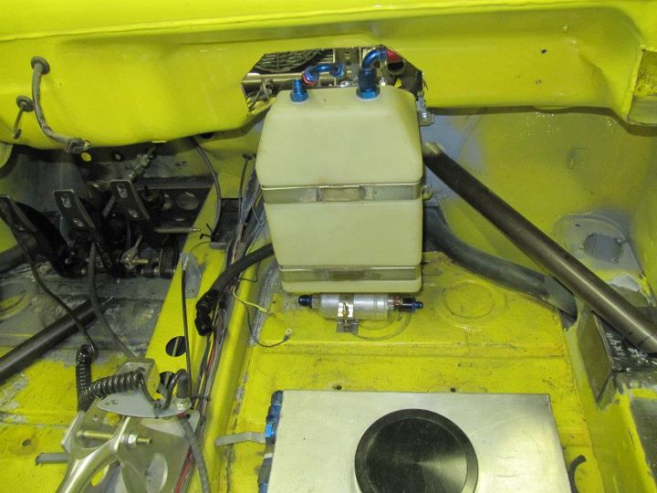

Fuel tank relocated to the passenger footwell with the fuel pump mounted right under it. This will keep it out of the heat from the radiator. I will need to construct a bulkhead to comply with the rules.
(IMG:http://www.914world.com/bbs2/uploads_offsite/sphotos.xx.fbcdn.net-364-1328744122.2.jpg)

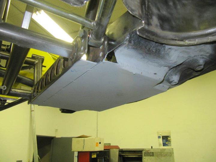

New front trunk floor. This panel is structural to hold the front of the car together.
(IMG:http://www.914world.com/bbs2/uploads_offsite/a7.sphotos.ak.fbcdn.net-364-1328744123.3.jpg)

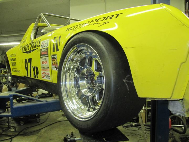

And now to the good stuff.

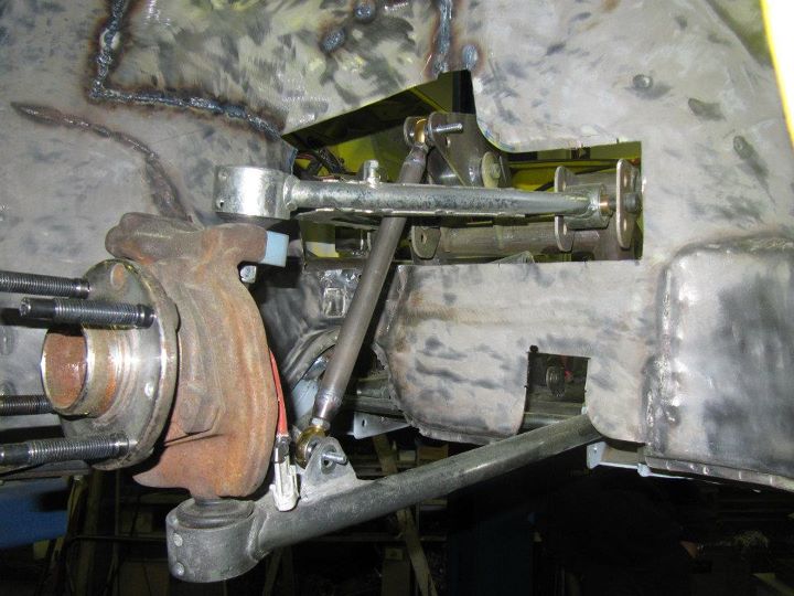

Front suspension geometry completed and shock mounted for fitment.
(IMG:http://www.914world.com/bbs2/uploads_offsite/a5.sphotos.ak.fbcdn.net-364-1328744296.1.jpg)
Front suspension with two bar in place to simulate shocks. We will use the to get the approximate corner weights and get the new shocks valved.
(IMG:http://www.914world.com/bbs2/uploads_offsite/a1.sphotos.ak.fbcdn.net-364-1328744296.2.jpg)

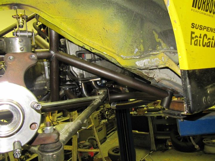

Outboard struts for the inboard rockers. These are adjustable so we can play with ride height.
(IMG:http://www.914world.com/bbs2/uploads_offsite/a7.sphotos.ak.fbcdn.net-364-1328744296.3.jpg)

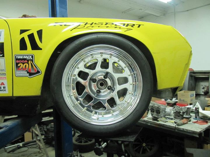

New Bogart wheels with some old slicks mounted. Front weighed in a 38lbs with tire. These are 11" tires on a 10" rim.
(IMG:http://www.914world.com/bbs2/uploads_offsite/a2.sphotos.ak.fbcdn.net-364-1328744296.4.jpg)
Now that is what I am talking about...front meat!
(IMG:http://www.914world.com/bbs2/uploads_offsite/sphotos.xx.fbcdn.net-364-1328744296.5.jpg)

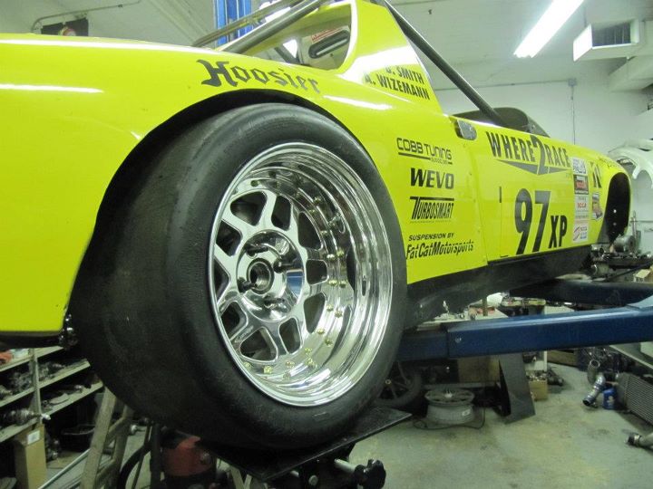

Bogart wheels look great...might have to do a little bodywork mods.
(IMG:http://www.914world.com/bbs2/uploads_offsite/a7.sphotos.ak.fbcdn.net-364-1328744296.6.jpg)

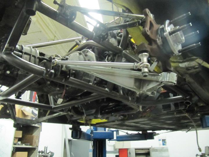

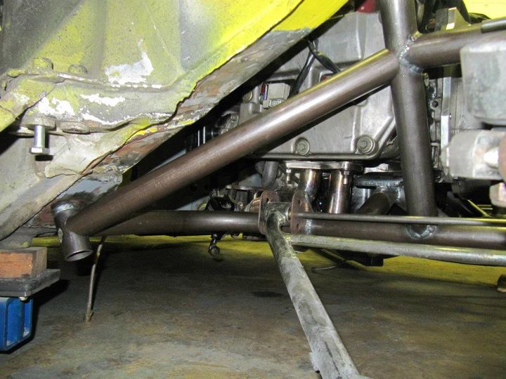

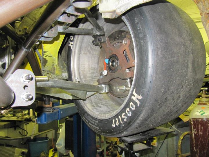

I love this shot...looks like the rear of a Porsche 908 with all the exposed suspension parts. Both rear toe links completed and everything bolted up. Need to complete the shock mounts and this thing will be on the ground.
(IMG:http://www.914world.com/bbs2/uploads_offsite/a4.sphotos.ak.fbcdn.net-364-1328744483.1.jpg)

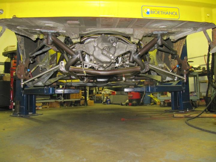

Lots and lots of work put into this rear sub-frame assembly. You can also see the new battery mount.
(IMG:http://www.914world.com/bbs2/uploads_offsite/a2.sphotos.ak.fbcdn.net-364-1328744483.2.jpg)

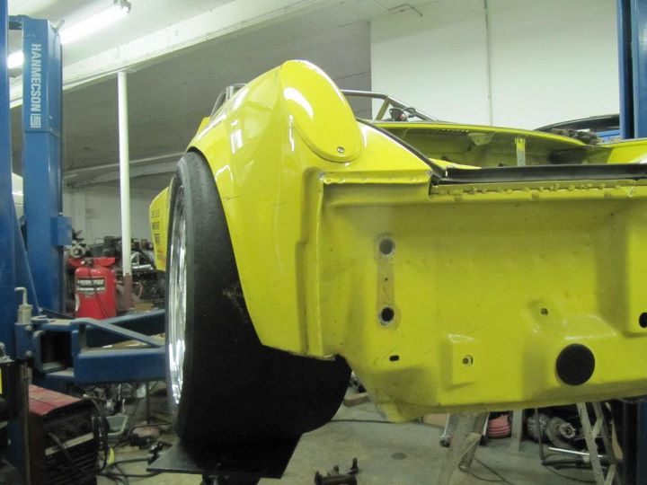

Rear Bogart wheels mounted. These are 12" slicks on an 11.5" rim. These weigh in a 42lbs with tire.
(IMG:http://www.914world.com/bbs2/uploads_offsite/a7.sphotos.ak.fbcdn.net-364-1328744483.3.jpg)
Inside of the rear wheels. Still need to get some custom axles made.
(IMG:http://www.914world.com/bbs2/uploads_offsite/sphotos.xx.fbcdn.net-364-1328744483.4.jpg)
Custom rear toe links that a combination of Nitron outboard heim joints and custom toe link bars
(IMG:http://www.914world.com/bbs2/uploads_offsite/a2.sphotos.ak.fbcdn.net-364-1328744738.1.jpg)

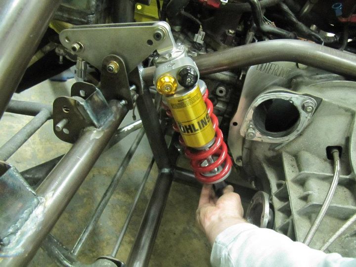

Approximate location for the rear shocks. Ran out of time to get them mounted so I will have to make another trip down to finish things up.
(IMG:http://www.914world.com/bbs2/uploads_offsite/a6.sphotos.ak.fbcdn.net-364-1328744483.5.jpg)
