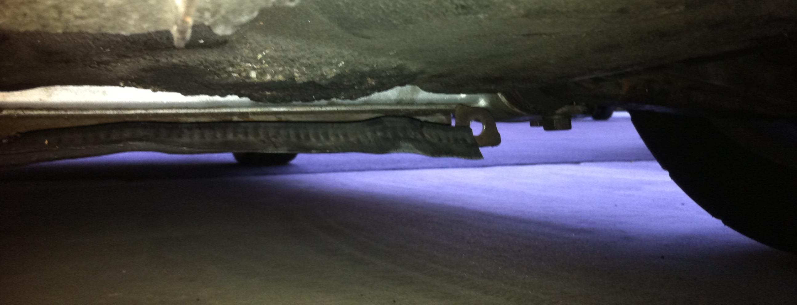

Hi guys. I installed an Aluminum Auxiliary Support in my 914 this weekend. It bolts right up, but it comes down lower than the steel piece and now the stock 914 underfloor protective plate doesn't fit. There are also no holes in the support for the plate to screw into in the front, but the two bolts in the rear are fine (see attached pic from the front).
I know I can't be the only one that has done this. What have others done to make the protective plate work? By the way, for those that have been thinking about doing this, I probably wouldn't recommend it. I'd guess it's only 3 or 4 pounds lighter than the steel piece, and some have suggested that it can flex. But I'm committed at this point to trying to make it work. - Mike |

r_towle drill two small screw holes in the flange of the s... Dec 14 2010, 10:08 AM
mwyatt Thanks Rich, makes sense. And I suppose I could a... Dec 14 2010, 11:59 AM

mwyatt I picked up a protective plate from a '77 911 ... Jan 10 2011, 11:43 PM
