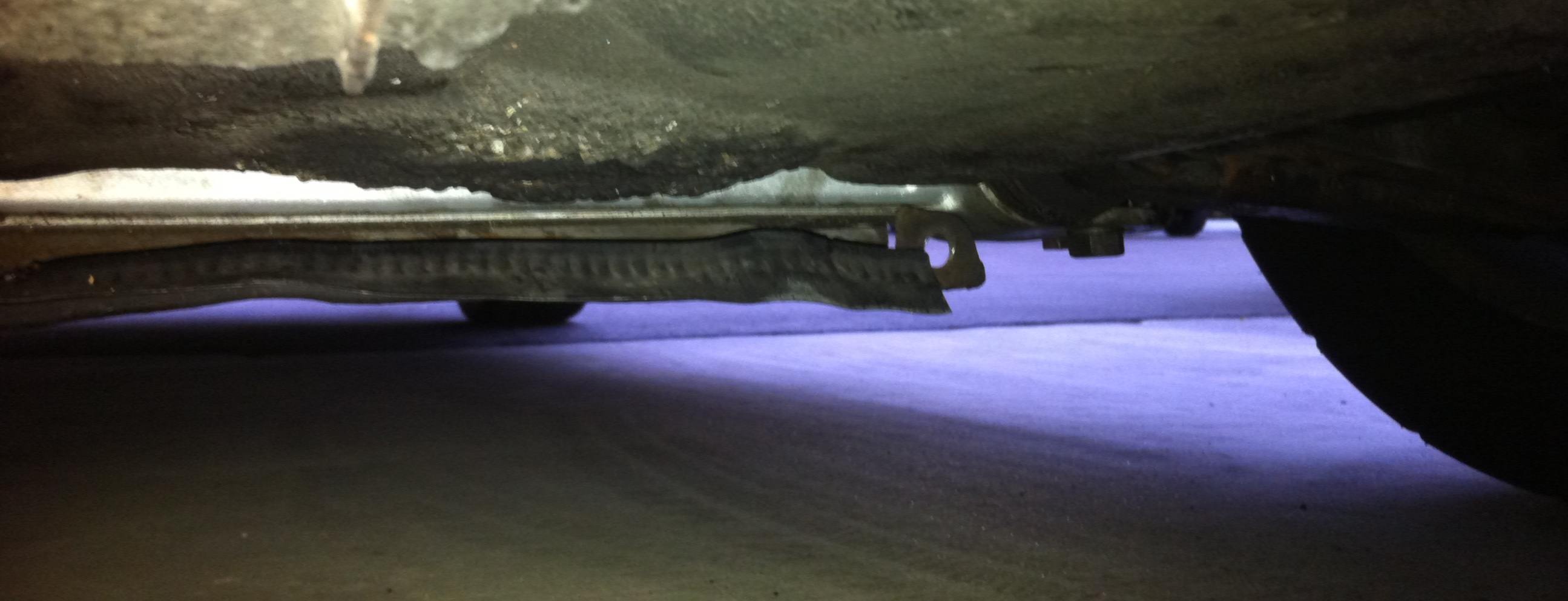

Hi guys. I installed an Aluminum Auxiliary Support in my 914 this weekend. It bolts right up, but it comes down lower than the steel piece and now the stock 914 underfloor protective plate doesn't fit. There are also no holes in the support for the plate to screw into in the front, but the two bolts in the rear are fine (see attached pic from the front).
I know I can't be the only one that has done this. What have others done to make the protective plate work?
By the way, for those that have been thinking about doing this, I probably wouldn't recommend it. I'd guess it's only 3 or 4 pounds lighter than the steel piece, and some have suggested that it can flex. But I'm committed at this point to trying to make it work.

drill two small screw holes in the flange of the support bar and fasten it that way.
Its made for a 911, so the stock 914 holes would never have been cast.
Rich
mwyatt
Thanks Rich, makes sense. And I suppose I could also make a gasket and attach it to the two original front holes in the protective plate to keep the seal it off.

I picked up a protective plate from a '77 911 and it fit really well. I got it from Parts Heaven. Didn't come with gaskets, so I made some and it works fine. For those that want to do this, for the entire project you need three items-
Aluminum Crossmember
Tabs (2 of them, they bolt to the cross member and on 911s mount the underbody swaybar)
911 Protective Plate
