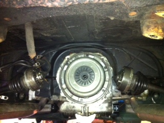

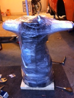

I got my trans out of the car, packed, and shipped down to Richard Casto at Blue Sky for a rebuild.
My question is, what other work should I do now, or parts should I replace? the obvious stuff --
- new CV joint bolts (8)
- paper cv joint gaskets
- trans fluid (duh)
the cv boots look to be in good shape. Is there anything else obvious I should be doing with the trans out of the car?

Richard Casto
post Dec 24 2010, 08:23 PM
Blue Sky Motorsports, LLC
Posts: 1,465
Joined: 2-August 05
From: Durham, NC
Member No.: 4,523
QUOTE(rwilner @ Dec 24 2010, 03:12 PM) *
If only Greyhound would finish shipping it, I could start work on it! I suspect the delay is a victim of holiday travel demand.
Richard
