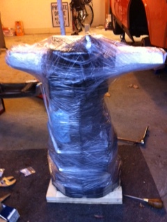

I got my trans out of the car, packed, and shipped down to Richard Casto at Blue Sky for a rebuild.
My question is, what other work should I do now, or parts should I replace? the obvious stuff --
- new CV joint bolts (8)
- paper cv joint gaskets
- trans fluid (duh)
the cv boots look to be in good shape. Is there anything else obvious I should be doing with the trans out of the car?
