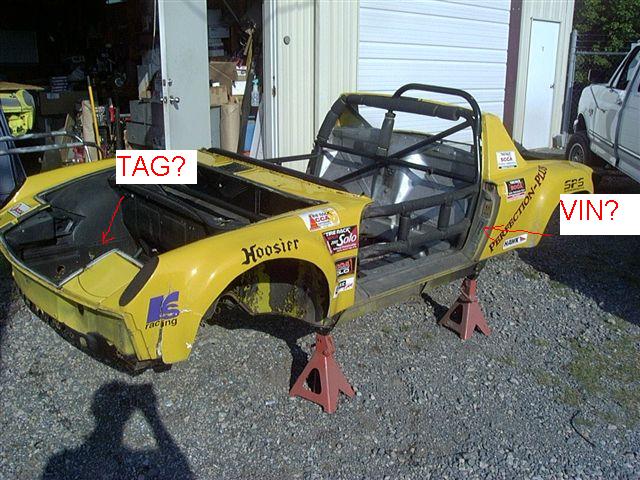

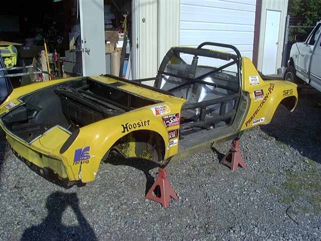

'75 or '76 front end. Looks like there is a lip on the front seam to hold the later rubber bumpers, there are big holes for the impact shock absorbers and it looks like the holes for the dog bones are missing.

It looks like there are remnants of a vin tag on the second picture in the door. Is there any stock metal bracing inside the doors? or cut away? This would indicate a later (73.5 on) as well. The VIN in the front trunk on the pass side wheel well is gone? That's not ideal...

73-74, there are obvious dog bone holes and no large holes where the bumper shox would be. The bushing you destroyed trying to place was likely for a 70-72 as it will be larger ID and OD than the later style. It will not fit. The ID should be way to big for your shift shaft, and this is an easy check for you. Hinged seats started in 73.

QUOTE(Dr Evil @ Dec 26 2010, 11:26 AM) *
1) Looks like the holes for the shocks
2) Looks like the lip for the late bumpers
3) I zoomed in, and it sure didn't look like the dog-bone holes were there.
Dr Evil
post Dec 26 2010, 01:49 PM
Send me your transmission!
Posts: 23,044
Joined: 21-November 03
From: Loveland, OH 45140
Member No.: 1,372
Those holes you circled on the far right of the front are the two holes for the dog bones. Are the bumper shox under the head light? Not that I recall.

The shape of headlight bucket , and the lower wheel well reinforcements are long 75-76 style.

There should be a VIN stamped into the top, inner right front fender.

'75/'76 chassis for sure.
Dead giveaway is the support under the headlight bucket to hold the larger late model bumper shocks ...
PS: It looks like the VIN could still be found on the pass. front fender top.
