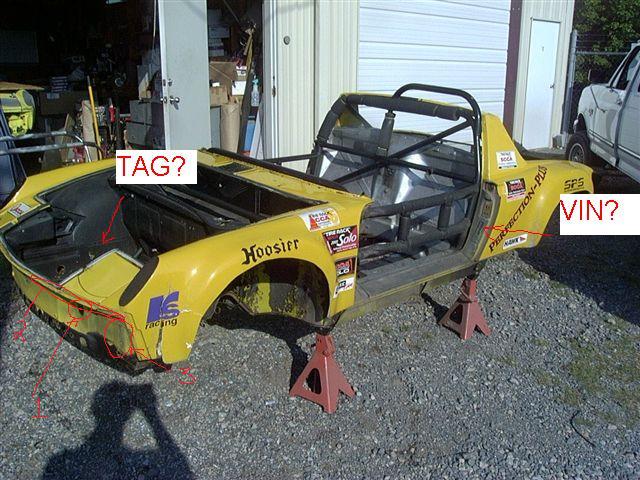

Hello - I have a new (to me) 914 race car that was made from at least 3 parts cars - and Now I am trying to buy parts and need help..... The body - no a- pillars no windshield ---- front pass fender has a welded plate for the cage over the vin --- no bumpers and holes drilled all over the front area --- I destroyed a firewall shift bushing that I bought (did the hot water and all) and now I think it could be for the wrong car year.
-- How to ID the body year ???? pass side floor has seat hinges , if that helps.
I also need help with front end id, how to tell if the front susp is early or late ??? and calipers ??? ------ the rear trailing arms, how to Id early from late --- I have the calipers off the car --
I got 4 trailing arms and 2 complete front susp -- with the car , but need to id them to buy spare parts....

'75 or '76 front end. Looks like there is a lip on the front seam to hold the later rubber bumpers, there are big holes for the impact shock absorbers and it looks like the holes for the dog bones are missing.

It looks like there are remnants of a vin tag on the second picture in the door. Is there any stock metal bracing inside the doors? or cut away? This would indicate a later (73.5 on) as well. The VIN in the front trunk on the pass side wheel well is gone? That's not ideal...

73-74, there are obvious dog bone holes and no large holes where the bumper shox would be. The bushing you destroyed trying to place was likely for a 70-72 as it will be larger ID and OD than the later style. It will not fit. The ID should be way to big for your shift shaft, and this is an easy check for you. Hinged seats started in 73.

Click to view attachment1) Looks like the holes for the shocks
2) Looks like the lip for the late bumpers
3) I zoomed in, and it sure didn't look like the dog-bone holes were there.

Those holes you circled on the far right of the front are the two holes for the dog bones. Are the bumper shox under the head light? Not that I recall.

The shape of headlight bucket , and the lower wheel well reinforcements are long 75-76 style.

There should be a VIN stamped into the top, inner right front fender.

'75/'76 chassis for sure.
Dead giveaway is the support under the headlight bucket to hold the larger late model bumper shocks ...
PS: It looks like the VIN could still be found on the pass. front fender top.

the dog bone holes were drilled after factory ----- to run early bumpers --------- you guys rock --
