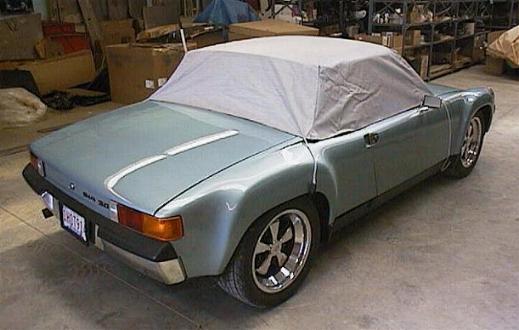

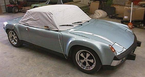

Once you are done with the mechanical work, you may want to see if Perry is still making the bib cover that waterproofs the engine bay.
Simple way to do that is put a piece of plastic over the engine lid.
