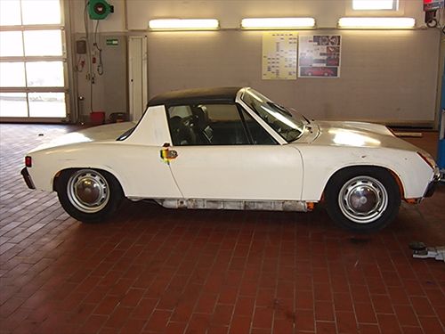

a german friend found this car offered by a dealer and might be interested
does anybody know the car?
VIN, other numbers, history, ....

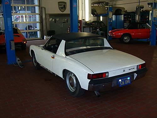

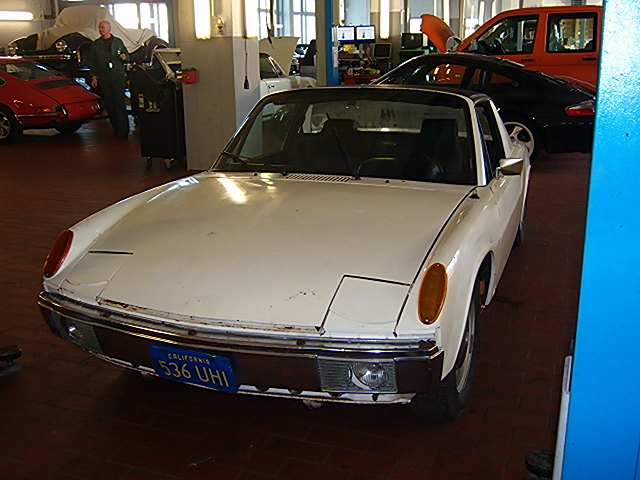

the car is at a dealer in Germany, but as you can see at the pics, it still has the blue plates

Wolfgang,
I'm guessing that those are not the original plates for that 914-6, because the sequence is well after my 73 2.0's 530GVS originally licensed in Nov. 72 ("U" vs. "G" would've been a year or more after mine)- unless it's a late sale new of a 71 or 72 into the 73 or later calendar year.
It could've been an out-of-state (originally sold outside Calif.) then re-registered in CA in that UHI sequence, or a re-registration from whatever it's prior/original Calif. plate was when new, or it could be just some Calif Blue Plates stuck on there. I can check at AAA to see if it comes up on their DMV computer at all.

Looks like it used to be Signal Orange ... (IMG:style_emoticons/default/idea.gif)

.... or a yellow - see at the passenger door handle? (IMG:style_emoticons/default/idea.gif)
Also, one must ask if it was a Euro 914-6 without F sidemarkers & imported to the USA in the mid/late 1970's (ergo the later series blue CA plates), or if somebody "shaved" the sidemarkers!!?? (IMG:style_emoticons/default/confused24.gif)
Both front fender wells are solid orange as is part of the long. (IMG:style_emoticons/default/shades.gif)
Good point. It also lacks the US-only "PORSCHE" script on the engine lid. (IMG:style_emoticons/default/idea.gif)
And if the rear bumper is correct, it would indicate a early car rather than later. (IMG:style_emoticons/default/popcorn[1].gif)

(IMG:style_emoticons/default/agree.gif) to both Andy! .... many eyes are better than any one pair!
I was just pointing out in addition that there is yet another yellow & maybe a green on there by the door handle - as well as the orange (I did notice the wells & long). So perhaps an accident or rust repair/replacement at the door/jamb?
In addition to lacking the sidemarkers & PORSCHE letters - it also has USA F TS & Taillight Lenses, but those would've been required to be changed upon import to the USA - IIRC.
I just noticed too that it's a USA 914-6 rear badge, not the VW-Porsche one.
Makes one start to wonder!? (IMG:style_emoticons/default/huh.gif)
Wolfgang needs to get someone near it to take a look in person! (IMG:style_emoticons/default/blink.gif)
... I'd want to know if this was a "made-up" or "rear" 914-6, with all of these discrepancies & oddities.
BTW - Wolfgang's "new" -6 has a known original CA blue plate in the "D" series at late May 71, while my 73 2L has a "G" 16+ months later at Nov. 72 - so I'm guessing that it wasn't until 1975-76 or later to have this one's "U" series plates. I don't recall what year they added the 7th front digit to the CA blue plates (i.e: #xxx### series) - maybe 78 - 80-ish - prior to going to the white ones, so this plate was before that, but not much with "U" to "Z" series.
So if an early -6 per the rear bumper, then it was definitely re-registered in CA later in the 70's, as I speculated above.
Anyone out there have a CA blue plate with ### Uxx ?? - If so, what year was it registered for that plate in CA?

Wolfgang, I just called AAA & this 914-6 is currently registered in CA on a PNO (Planned Non-Operation) since 2009, and was first registered under this plate in CA in 1977, and it does go to a 1970 Porsche, but the part of the DMV computer record that AAA can access does not indicate the model type at all (not even 914 - let alone 4 or 6).
You or he would have to contact DMV for other details & prior registration info. directly from Calif. DMV.
That leaves the question on 1970-77 as to where & what model it was.

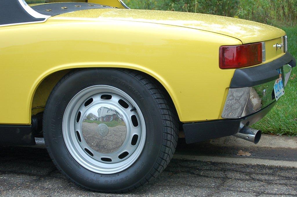

I noticed another issue. Count the spokes on the wheels & if my eyes are correct there are (10) spokes, so it appears to be a 914-6 or (5) lug conversion. 4-cyl cars have only (8) spokes.

Forgot to add this photo of a 914-6 (10) spoke wheel.
T

QUOTE(Thomas J Bliznik @ Dec 27 2010, 03:41 PM) *
(IMG:style_emoticons/default/confused24.gif) It's a factory /6 with 5-lug steelies ...

I think a key issue is to check the VIN at all 3 places to verify that it is in fact a factory 6, as well as OE colors, condition, etc. - since it has some USA vs. Euro/World versions' discrepancies, & an unknown first +/- 7 years up to 1977 when these plates were assigned. Not saying it doesn't appear to be a six, but I've also seen a couple of fake-sixes passed off over the years.
Unfortunately, AAA wouldn't give me the VIN, not being my car.

(IMG:style_emoticons/default/blink.gif) ... time for new glasses Tom, as I counted 10 holes (spokes) on it's wheels in the 1st post's pix. (IMG:style_emoticons/default/biggrin.gif)
