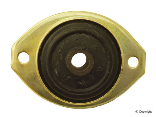

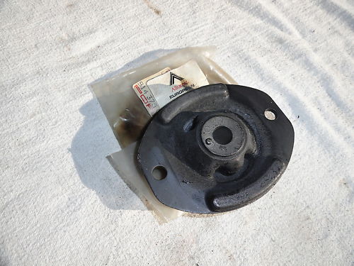

QUOTE(SirAndy @ Dec 28 2010, 10:43 PM) *
The 911 sport motor mounts can be used as a direct replacement for the 914 transmission mounts. Depending on your car you might have to oval out the mounting holes just a tiny bit.
Just make sure you reuse all of the hardware and washers, including the large cup-washer!
(IMG:style_emoticons/default/agree.gif) very slight ovaling of the mounting holes, check how much before egging out..
above is 911 sport motor mount..
above is the factory 914 transmission mount. HTF but there is a pair of NOS on ebay at $99.99 each under search term Porsche 914 NOS.
both have rubber involved but the 911 style is stiffer and does not hang as far as the 914 factory Version..
