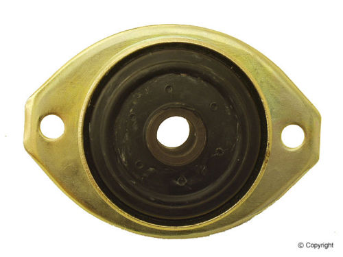

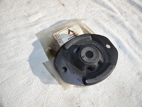

detoxcowboy
QUOTE(SirAndy @ Dec 28 2010, 10:43 PM) *
The 911 sport motor mounts can be used as a direct replacement for the 914 transmission mounts. Depending on your car you might have to oval out the mounting holes just a tiny bit.
Just make sure you reuse all of the hardware and washers, including the large cup-washer!
agree.gif very slight ovaling of the mounting holes, check how much before egging out..
above is 911 sport motor mount..
above is the factory 914 transmission mount. HTF but there is a pair of NOS on ebay at $99.99 each under search term Porsche 914 NOS.
both have rubber involved but the 911 style is stiffer and does not hang as far as the 914 factory Version..
