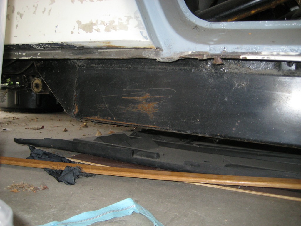

This car looks like an east coast rust bucket. The passenger long is gone on the outside and replaced by a piece of steel.
The firewall is rusted along the entire edge of the floor.
This car should be really cheap to be worth it.
Are you trying to save money and get a car to work on rust-wise, or do you want a 914 to drive?

Based on the last pictures... Buy a new tub and strip the good parts off that one. Someone has done major work to the longs and not done it correctly. I also see parts chopped off in the engine bay. You will spend way too much making this one right. Buy another roller with less rust. I have a similar car that I'm cutting up due to rust like yours. Your passenger long looks like a hack job, although it may be structually sound.

this car used to be really rusty
someone put a lot of effort into repairing the rust
I'd probably try to form an opinion about that person's abilities to know how good their work was.
as a racer, its not going to be the lightest one because welding and patch panels add weight
looks like a lot of good parts though
not a complete total, but not pristine.
I'm guessing a cage will add back enough of the rigidity, and a suspension console may be necessary... but they aren't that hard to do
just time and money like everything else.

Very true, after seeing those rockers, there was a reason those were put on. Thanks for confirming my suspicions.

I would want to see pictures of the existing repairs in progress before I felt comfortable about building that chassis into a fast -6 race car.
More than likely, those pictures would convince me to keep looking.

Those last pics look like what was done to my car before the "repair" pieces rusted out... Those are the same parts I'm cutting out and putting in proper sheet metal...

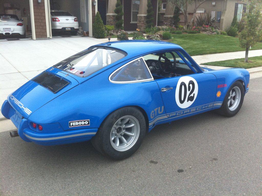

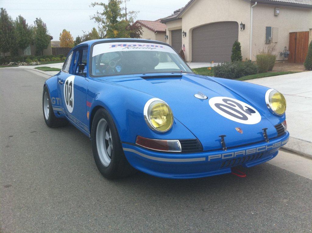

To bring a little happiness to this thread, here is my 911ST race car that I just completed a makeover on. With English Wheel rear steel flares done locally.

That's one nice 9eleben. (IMG:style_emoticons/default/biggrin.gif)

Thanks- I love that Blue monster.

The car's chassis itself I wouldn't trust, flat out. The rockers are scary. The cage, as you describe *now*, does make it interesting, however. If you feel it can be removed without buggering to badly then yes, that is a good price....IF you know the cage was built by a pro....for sure.
The car was mis-represented from the git-go it seems or maybe , giving the benefit of the doubt, we didn't have enough info to make a judgment.
The problem I have (and you're probably the same) is when I see poor workmanship in one area the rest becomes suspect.....even parts. When you dig into a car to "make it your own" you shouldn't be surprised to find more shi....stuff not up to snuff. Your 9eleben show you to be the kind of guy that is gonna dig & fix.

The one pic of the drivers side floor shows a small portion of the cage. From what little I can see of it, I'm not impressed. The main hoop is located such that a full circumferential weld at the base looks impossible, and the visible door bar indicates a flat x-brace design. Outwardly bent X or Nascar bars would be much better IMO.
In the same picture I see more patchwork at the bottom of the firewall. (IMG:style_emoticons/default/unsure.gif)
A price of $1800 sounds very reasonable with all that's included.
Good roll cage - $2000+
Sportsman cell - $800+ (is it in good internal condition though? Unleaded kills fuel cell foam and rubber)
SC front end - $500.
Rusty tub - minus $500.
