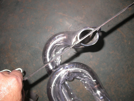

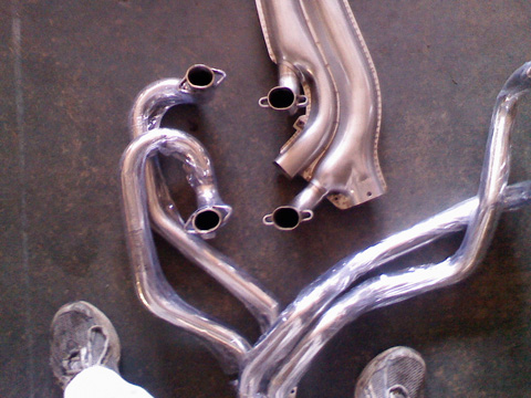

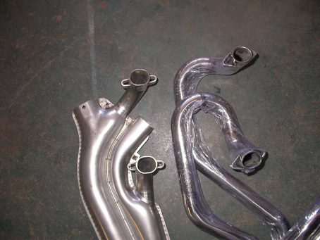

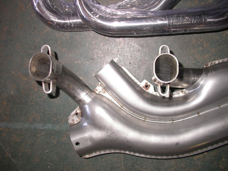

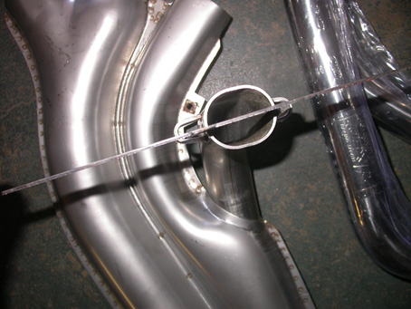

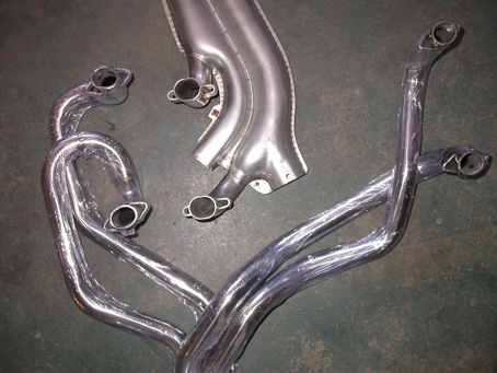

i was waiting for OBX to do the right thing before posting this but I have a duty to the 914 community to show ya'll this. OBX wants me to pay return shipping before I get a refund. I offered to help solve these incorrect alignment issues. I will post the email string that has been going on fro 6 months.
if OXB does the right thing after seeing this I will still be surprised, but first the pics

Wow, thats not just off a little bit either.

I even sent these photos to OBX

That is just FUGLY
(IMG:style_emoticons/default/bs.gif)
I wonder how many exhaust studs have been broken by folks trying to "make it work" and squeeze them to fit? That one there has not chance of even hitting half the correct studs. Not even sure it those could be made to work with a chop and some "corrective" stub pipes.
Thanks for sharing this, it was the right call (IMG:style_emoticons/default/beerchug.gif)

the materials and weld work look very clean on the stainless steel OBX but you can not get it to bolt up. its not even close. still no responce from racing parts depot in oakland ca

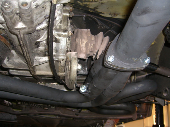

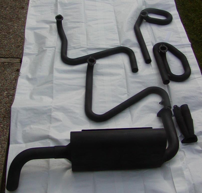

I ran a version of the Euro Race headers that are also sold by Paragon Products...
Mine were ceramic coated inside and out, ran very well on my D-jetted 2056 (IMG:style_emoticons/default/biggrin.gif)
4 into one collector...each individual header pipe is bolted up to a stub pipe and then into the collector...easy to mount and align that way.

Dan, that header looks great! Do you have any more pictures from other angles?

QUOTE(Chris Hamilton @ Jan 7 2011, 05:59 PM) *
I will have to take a look at my photos....I am not sure I have any other pics with it installed Chris.

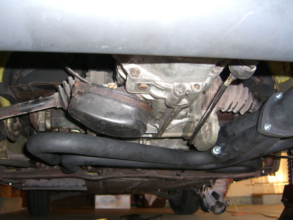

here is a decent shot of all the pieces before install.

There are 2 critical angles to observe. Notice the oval port opening and how the mounting tabs relate to the oval position
I have used an SSI brand heat exchanger in the photo as a reference to illustrate the oval position vs the mounting tab position
