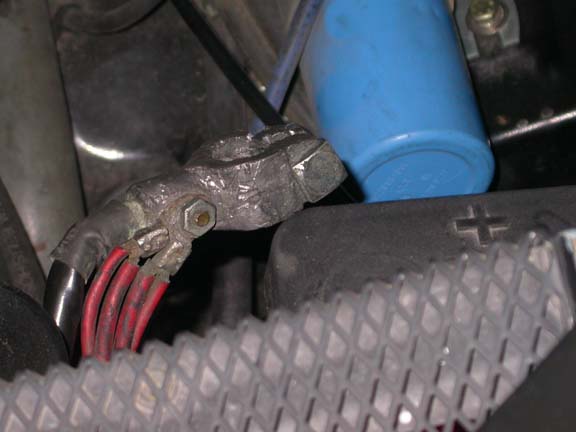

I need to replace my + battery cable. It has a threaded lug on the terminal that holds some smaller wires. Haven't been able to find a cable with this feature so I need some advice on the best way to handle these connections. What are my options?

I emailed through your online catalog last fall and was told that the cable AA sold did not have the lug as shown in the picture. Is that true? or, is the picture I posted not a correct part?

No not the lug like that but the original German crimp on end with the exact same cinching bolt and the extra red wires attach under the nut, OR the collar of the cable end can be tapped. The problem with the ends out there is that they are a clamp on rather than a crimp on and look LIKE HELL when installed. This one does not.

wonder if there was more than one type on stock 914's I have a brass terminal on mine, with the lug for the small wires on the top rather than on the side as shown by the kelty guy
a larger ring terminal would allow putting the small wires on the clamping bolt, not stock, but usable.
so what type(s) of terminal was offered originally???????????????????

The cable that is in the picture is no where close to stock. Some one has made yours up.

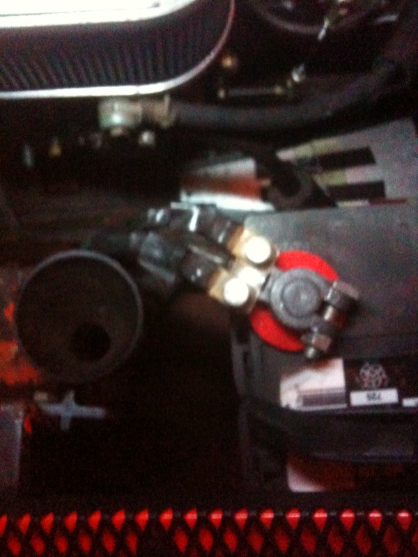

Quick down and dirty easy. AutoZone Clamp. Bundle the accessory wires with a ring terminal, bolt them down to the clamp bolt. Sorry for the cell phone photo but you can see.

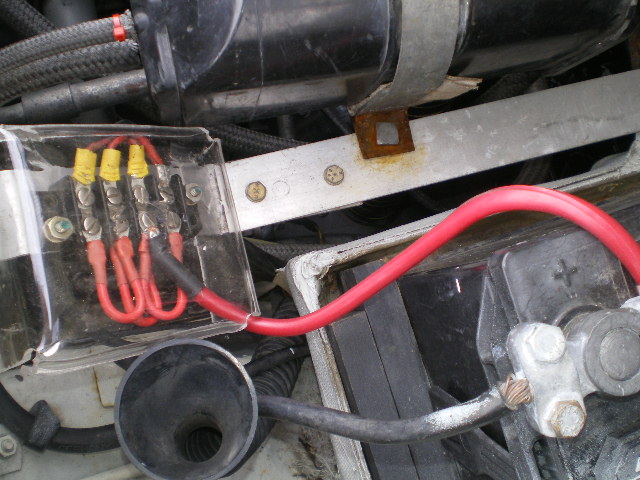

I separated mine out to improve future electrical diagnostics. (in my mind, anyway)

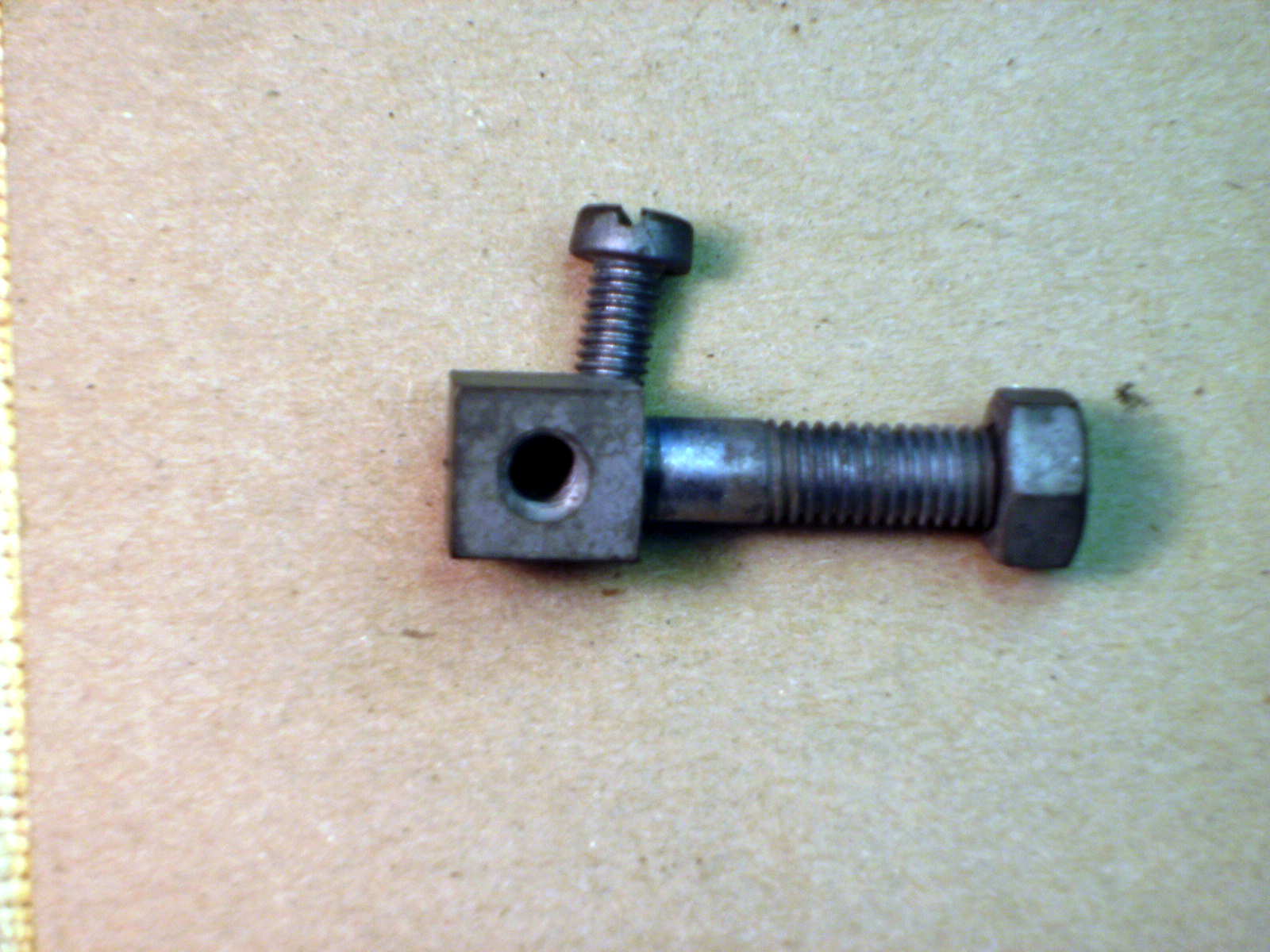

Here's what the factory used. I'd love to be able to get a few.

You guys have given me lots of good ideas. I found some Bolt Extenders that look promising.

That's what I've been putting on the ones I make, but the terminal is larger than M6.
