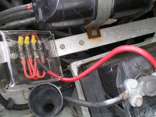

Quick down and dirty easy. AutoZone Clamp. Bundle the accessory wires with a ring terminal, bolt them down to the clamp bolt. Sorry for the cell phone photo but you can see.
76-914
I separated mine out to improve future electrical diagnostics. (in my mind, anyway)

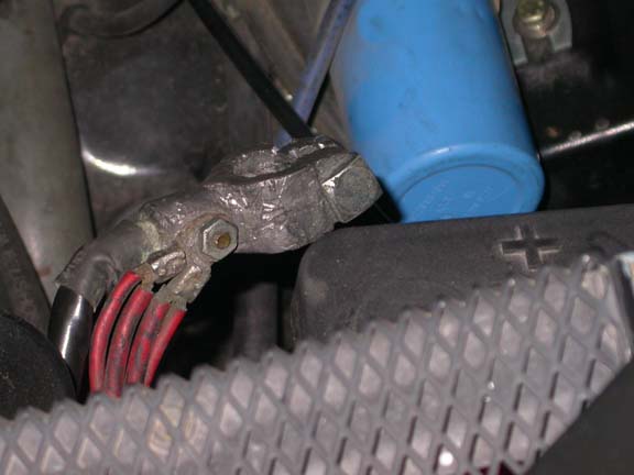

Here's what the factory used. I'd love to be able to get a few.
