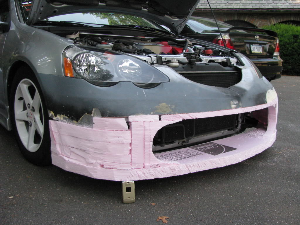

(IMG:style_emoticons/default/sunglasses.gif)--><div class='quotetop'>QUOTE(scotty b @ Jan 5 2011, 08:08 PM)
</div><div class='quotemain'><!--quotec-->The sheets and particularly spray foam just isn;t going to cut it. I'm talking about a whole front bumper. That stuff may be great for a small project or a home doer, butI have to keep this within a reasonable budget. Surfboard blanks crossed my mind but the amount I would need would be $$$$ plus shipping got to be even more $$$$$$. [/quote] You're not going to find anything cheaper than foam sheet and the spray can foams. Here is a shot of a ricer that had his front bumper using the only stuff from Home Depot, so it can be done on the cheap. Fill in the voids with the spray foam and make your female mold. It will take some work to get the mold perfect. |

(IMG:style_emoticons/default/sunglasses.gif)--><div class='quotetop'>QUOTE(scotty b @ Jan 5 2011, 08:08 PM) </div><div class='quotemain'><!--quotec-->The sheets and particularly spray foam just isn;t going to cut it. I'm talking about a whole front bumper. That stuff may be great for a small project or a home doer, butI have to keep this within a reasonable budget. Surfboard blanks crossed my mind but the amount I would need would be $$$$ plus shipping got to be even more $$$$$$. [/quote] You're not going to find anything cheaper than foam sheet and the spray can foams. Here is a shot of a ricer that had his front bumper using the only stuff from Home Depot, so it can be done on the cheap. Fill in the voids with the spray foam and make your female mold. It will take some work to get the mold perfect. [/quote] I like that fancy holding device. As for the foam I would have to agree with using the pink stuff and just layering it to get the size you need. I've noticed that the florist foam stuff costs a little more per volume than the pink stuff.. |
