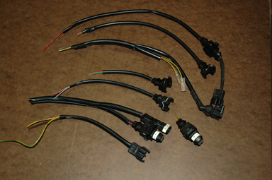

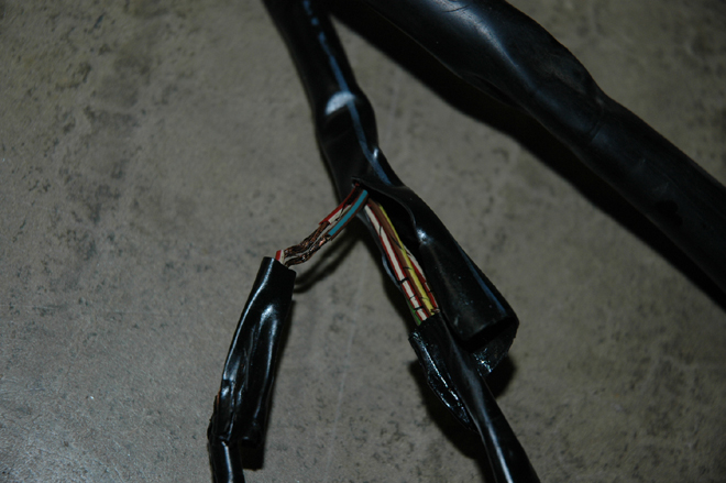

Turns out there are a few folks that want to see this. This started as a tangent to the "Which Engine is best, 3.2 or 3.6L?" thread. There is a voluntary factory recall on many of the 1995 and 1996 3.6L engine wiring harness' because of a bad formulation in the insulation. It turns into a crusty mess and can cause all kinds of issues.
In my case it was very bad missing when it rained and an increasingly bad idle. But in some cases folks have fried their alternators. If you had/have a new 993 then Porsche would have notified you based on your VIN, but in my case I just bought an engine so was never notified.
Here's the culprit.

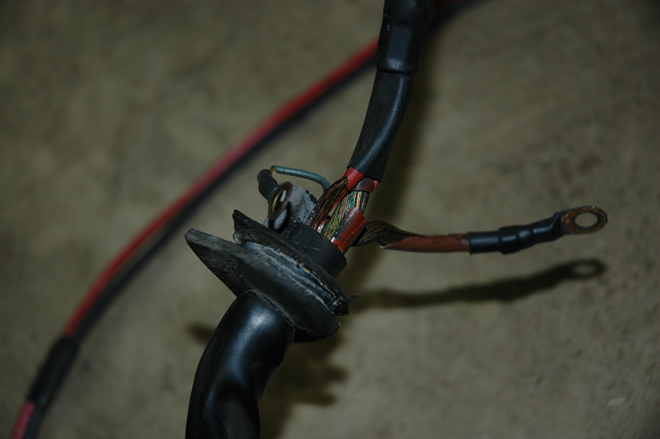

Here's what happens at the alternator

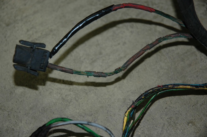

An injector branch... no wonder it was missing when it rained!
Here's the capacitor lead... talk about a major short if it had failed.

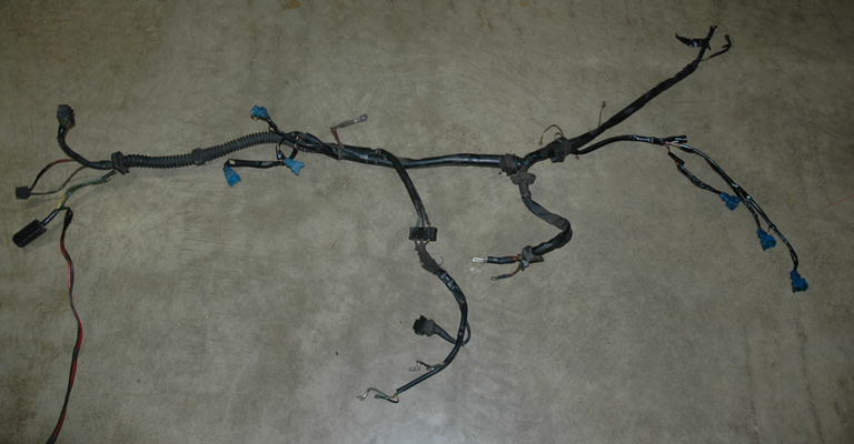

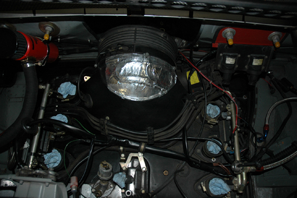

Here's the main trunk. Lot's of ugliness in this cluster.
First, removing all of the stock 993 wires I don't need in my harness. Otherwise there would be German spaghetti all over my engine bay!

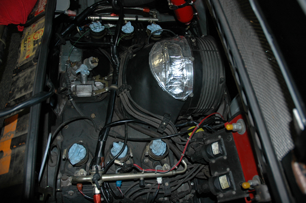

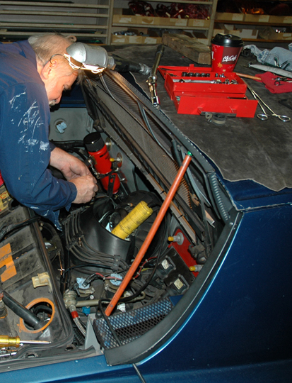

Assuming the position...

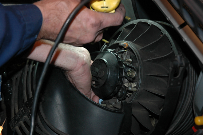

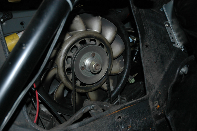

Finding out I have to open the access hole to get the fan far enough forward to reach the lower alternator wire (ground).

Don't even have to loosen the belt, just tilt it forward and back again after the new alternator wires are fastened, and yes. I see the leaky crankshaft oil seal issue!
Back together and threading the wires back to the starter and reverse-light switch on the transaxle.
