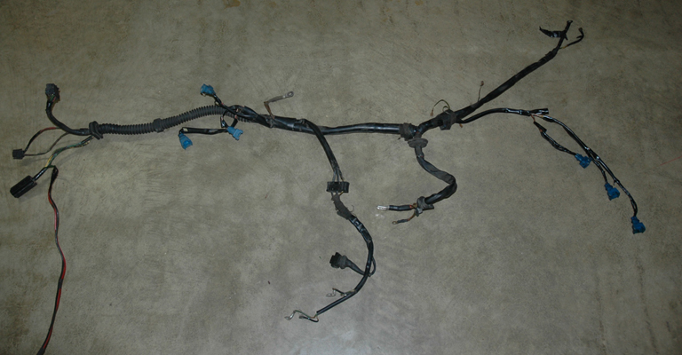

Turns out there are a few folks that want to see this. This started as a tangent to the "Which Engine is best, 3.2 or 3.6L?" thread. There is a voluntary factory recall on many of the 1995 and 1996 3.6L engine wiring harness' because of a bad formulation in the insulation. It turns into a crusty mess and can cause all kinds of issues.
In my case it was very bad missing when it rained and an increasingly bad idle. But in some cases folks have fried their alternators. If you had/have a new 993 then Porsche would have notified you based on your VIN, but in my case I just bought an engine so was never notified.
Here's the culprit.
Click to view attachmentHere's what happens at the alternator

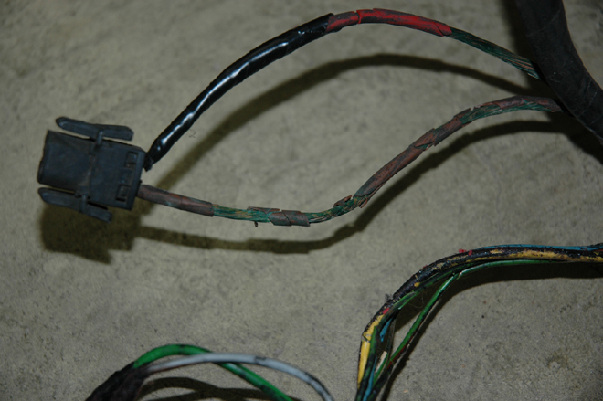

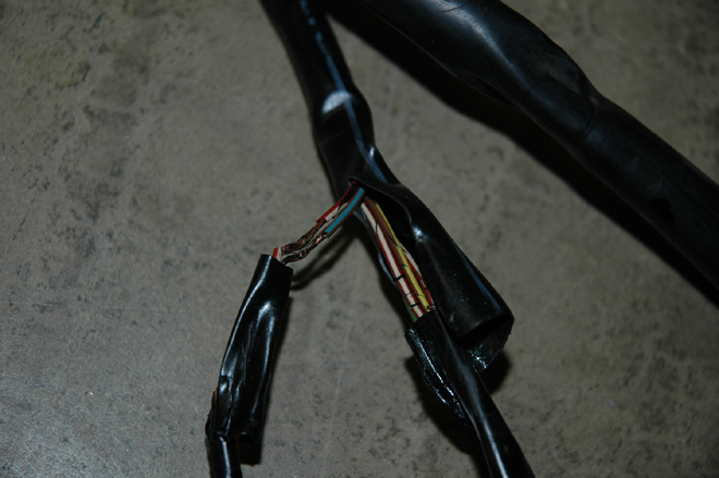

An injector branch... no wonder it was missing when it rained!
Click to view attachmentHere's the capacitor lead... talk about a major short if it had failed.

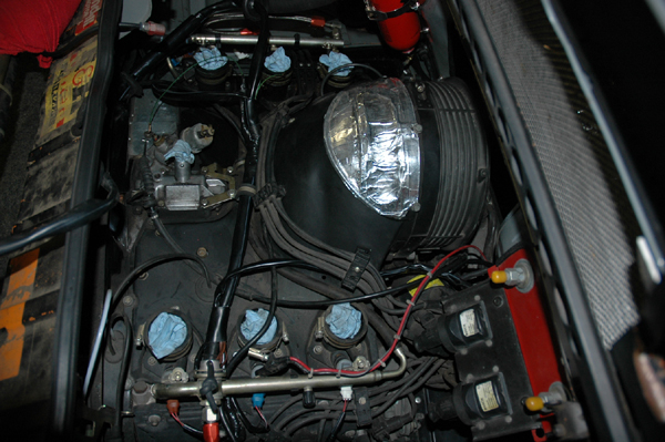

Here's the main trunk. Lot's of ugliness in this cluster.
Click to view attachmentFirst, removing all of the stock 993 wires I don't need in my harness. Otherwise there would be German spaghetti all over my engine bay!

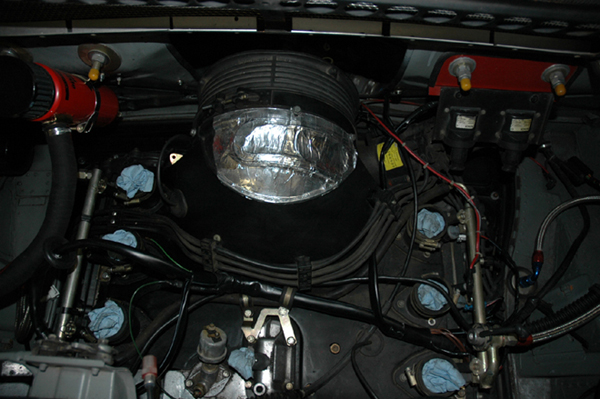

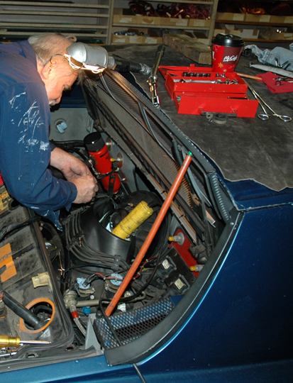

Assuming the position...

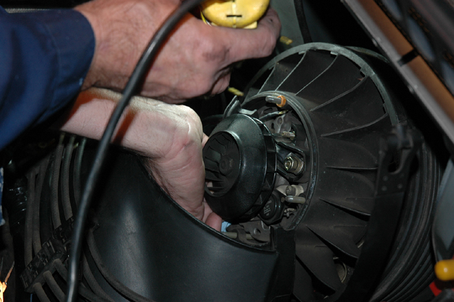

Click to view attachmentFinding out I have to open the access hole to get the fan far enough forward to reach the lower alternator wire (ground).

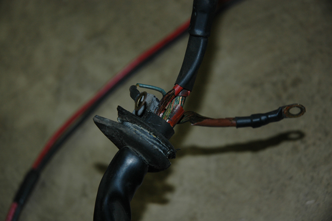

Don't even have to loosen the belt, just tilt it forward and back again after the new alternator wires are fastened, and yes. I see the leaky crankshaft oil seal issue!
Click to view attachmentBack together and threading the wires back to the starter and reverse-light switch on the transaxle.

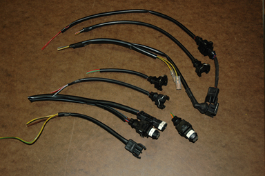

Now, to tidy up and look for any unattached... stuff.
Click to view attachmentAll went well and thanks again Andy for letting me know about the recall, and JT914-6 for the pix.
